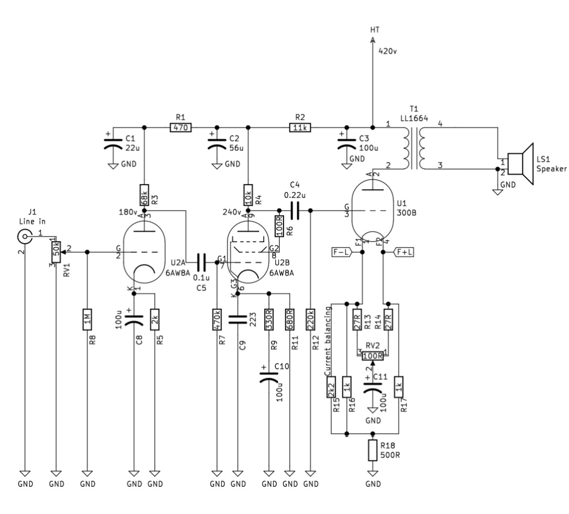

I’ve been working on my 300B amp and after some subjective listening tests, my main issue is the roll off on the top end… sure enough, it drops off after 10k… So after some experimentation I decided to “voice” it away by playing with the bypass scheme of the second stage… Seems to have flattened things out…. I lose some input sensitivity but it was very sensitive to begin with…
Now… this is where I pause and think
- There must be a reason i’ve never seen this implemented anywhere else that i’m aware of… what am i not considering?…
- I feel like this isn’t addressing the main issue of “something something miller effect” it’s remedial… But the only “real” solutions seem to require unobtainium loctal tubes, interstage transformers that I don’t have space for, or some sort of mosfet follower that I don’t think I can easily implement into this topology…
- there might be something else in my circuit causing the rolloff
Here is my quickly drawn schematic… Missing is the details of the HT supply - it’s fairly conventional. What I did draw is the filament supply since once again, I did something I don’t see in other schematics and thus might be a factor in my HF rolloff behavior:

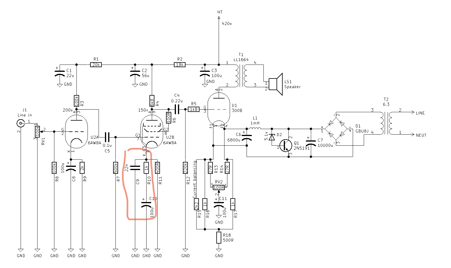

Before (purple) and after (green) bypass tweak:
How does it sound? I don’t know… at this point I have “tunnel hearing” and don’t trust my ears anymore.
Any advice or comments would be appreciated! thanks!
Updated schematic:

Updated schematic:
You’re right! I’ve just updated the schematic - thanks!There's no ground reference (grid leak resistor) for the second tube's grid. I don't think that causes your problem, and you probably just forgot to draw it.

Anyway, you've got a, what is it, 2 dB roll off above 10K, that's not unusual for such amps. I'm thinking output transformers.

Quite possible - But that part appears to be doing its job. it's just supposed to be an NPN running as a zener booster as a rough form of regulation to keep the filament voltage between 4.98 and 5.1v.. If you're talking about the pin numbers yeah - I just picked the first NPN schematic symbol I found in KiCad which may have a completely wrong leg assignment. oops. I went this way instead of of a VR because I don't have quite enough voltage headroom coming out of the PT.. and from what I understand, this doesn't need to be completely ripple-free, just not as obtuse as 5VAC.Q1 doesn't look right.

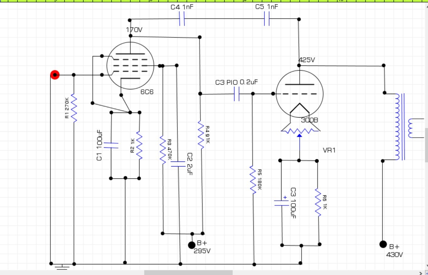

I've the same issue with a pair of Radiotron 300B amps I built. Tapers off more than yours do.
I ha
Advice I've received from a trusted internet friend is to triode strap the 6C6 which should boost the top end at the expense of sensitivity (which I can afford). I am planning on working on that this winter as I am happy with the 3C24 amps I built from the same guy's schematic.

Honestly? It's a single-ended, no-feedback 300B amp, and you're expecting it to play "hard, dynamic" electronic music with a ton of high-frequency information. That's not typically a winning combination. ;-) Regardless of the claims made by transformer makers, a low-transconductance triode with an SE output tranny carrying standing current is going to be frequency-limited.
I suggest you try some feedback. Local feedback from the output tube to the driver might help, but IMO the output tranny is your limiting factor. Try a small amount of global feedback, like 6dB. Elekit uses it, Grant Fidelity used it in their 300B amp. Remove the tweak on the driver cathode and use the extra gain to apply a small amount of global feedback and see what you get.

A single pentode is one of the next things I intend to try, but I don't have any 6C6 on hand and finding them as a pair seems a bit of a challenging endeavor.. I'll have to explore other pentodes.triode strap the 6C6

Low source impedance drive is what is required. Measure bandwidth of each stage to determine where the problem lies.
Check the ESL/ESR of your output stage cathode bypass capacitor over frequency.
@WntrMute2 I would remove C4 and C5 and remeasure. The high driver source impedance is not helping either.

I think you can measure at the grid of the following stage, after the coupling cap, with a 10X probe. That will keep DC off the scope.
