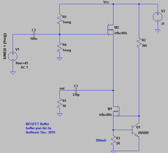

To get an idea of how this buffer behaves, I've implemented it as shown in the attachment. As expected there is definitely a difference in the simulated distortion and that of the real thing.
The setup was 500mA idle current, 1kHz with 616mV RMS amplitude sine wave at the input, dummy 47R resistor as load.

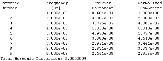

Have a look at the second attachment, the simulated distortion results. Not bad, 5e-05 second harmonic distortion, and 4.4e-07 third. This would amount to about
* fundamental 8.7dBm, or 616mV RMS
* second harmonic distortion -86dB, or 30.8uV RMS
* third harmonic distortion -127dB, or 0.27uV RMS
The question is, how far would the real circuit be from simulation?

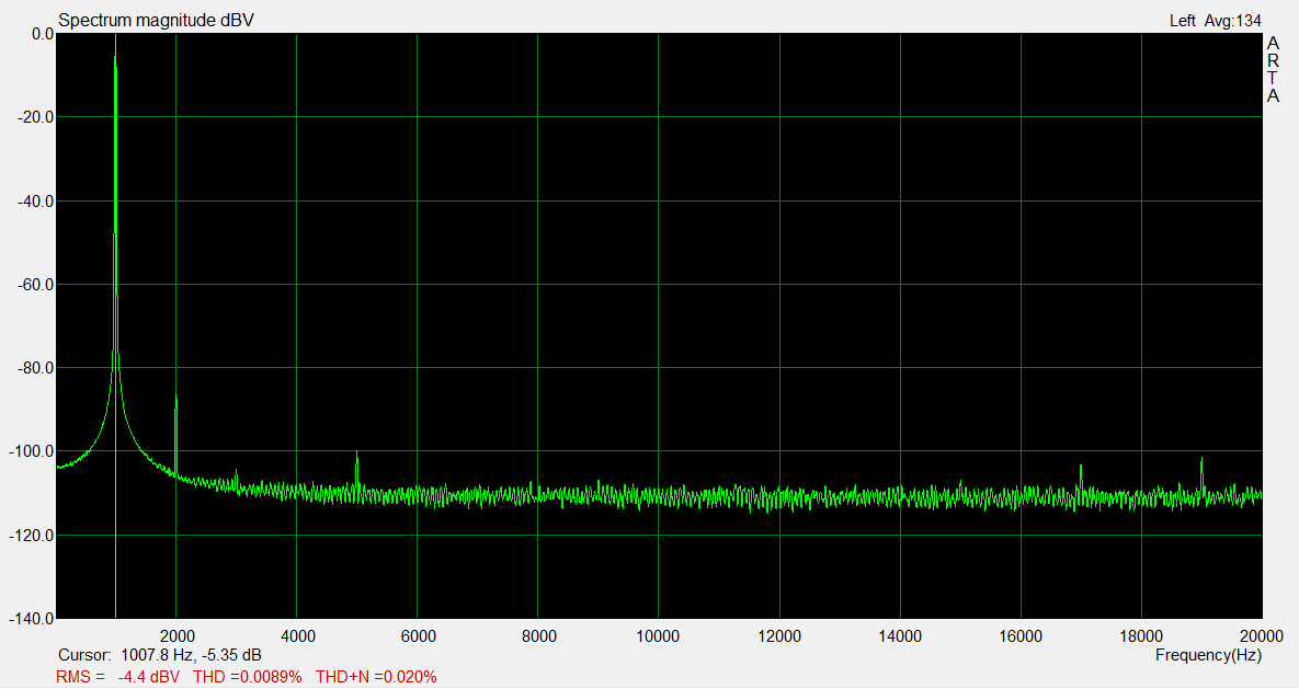

Measured the output with both the sound card (using ARTA), and my HP 3585A spectrum analyzer, the results being in agreement, but will just mention the numbers I got out of the spectrum analyzer:
* second harmonic distortion -51.1dBm, or 716uV RMS
* third harmonic distortion -82.7 dBm, or 15.5uV RMS
It's expected that simulation is different from reality, but why is the difference so large?

Diamond buffer is quite simple especially if you use FETs as the current sources. Works very well for me.
what is the base current of the Follower (Q2) in sim and real life?
I suspect it is ~ double the current passing through R6, i.e. sk170 current is split roughly 1/3 through R3 and 2/3 into Follower base.
Could variation in Follower base current requirement affect the real life performance?

Hi Andrew, I thought so too. Varying the value of R6 does change the distortion in the 2nd harmonic. Lower value for R6 results in lower distortion. The lowest I could get on this prototype was about -63dB distortion in the second harmonic, and about 90dB in the 3rd. One thing I've tried is replacing R6 with a jfet CS. That lowered the distortion a little bit. At this point it's not clear to me how this buffer can be improved significantly and still be kept simple. Perhaps I can live with -60dB distortion in the 2nd harmonic. The buffer was intended as the output in a headphone amp using a direct heated tube in the first stage, so I might just try it out as is.

I'm just guessing, but I think it is that 2/3 : 1/3 ratio of base current:R6 current that is mostly the cause of the increased distortion.
Can you kid on the sim by changing the hFE of the output device to see what effect this base current has on distortion?
Maybe you simply need more current gain between the jFET and the Output.
Decreasing the BF parameter from 211 to 111 in the model of 2SC3421, does indeed increase the simulated 2nd and 3rd distortion, but by very little, nothing close to the values I get in the real circuit; e.g. for 2nd, with the small beta the 2nd harmonic distortion is about -80dB, whereas in the real world is about -60dB.
Not that I trusted very much simulated distortion results before, but this makes me trust them even less. It's still interesting that the distortion profiles (simulated and real) do look very similar, i.e. larger 2nd, very small 3rd, and 4th, 5th and the rest are as low as the noise.
