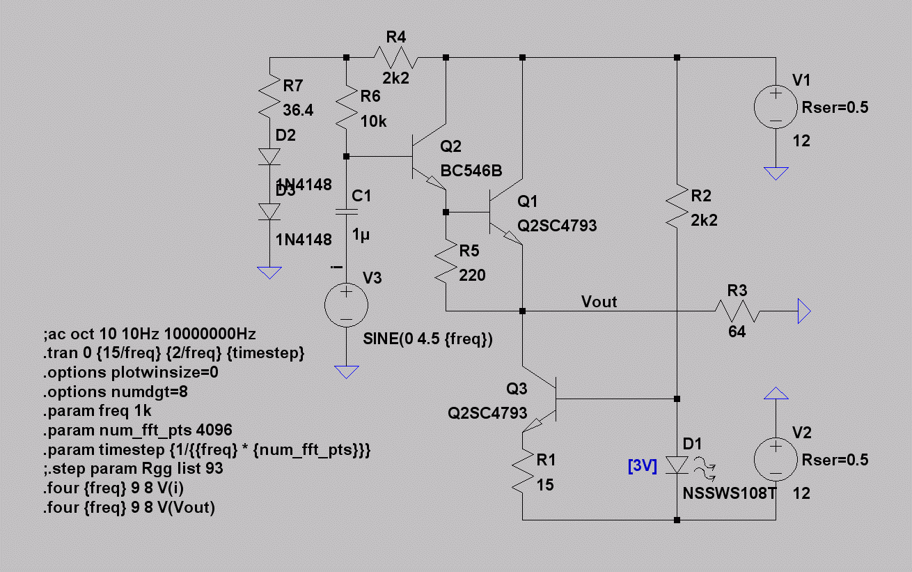

There's also euvl's (Patrick) source follower, and it's DC coupled. Have you considered it, regal?
http://www.diyaudio.com/forums/pass-labs/128571-some-other-source-follower-configurations.html#post1592820
I'm waiting for the power jfets to arrive, and will give it a try.

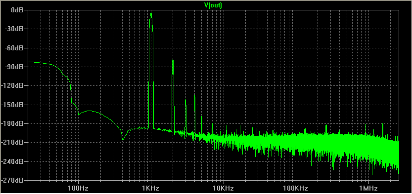

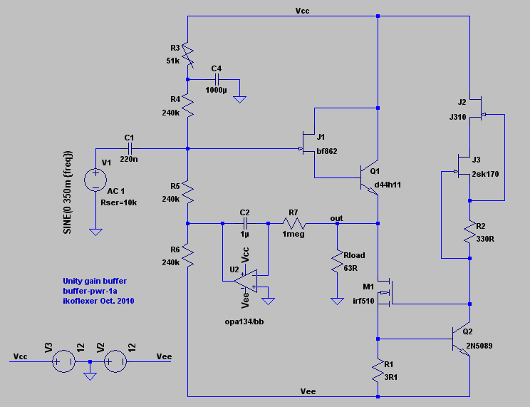

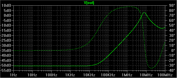

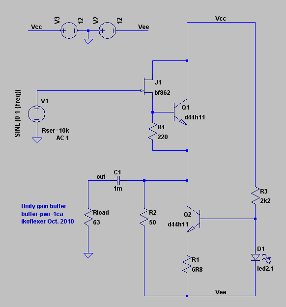

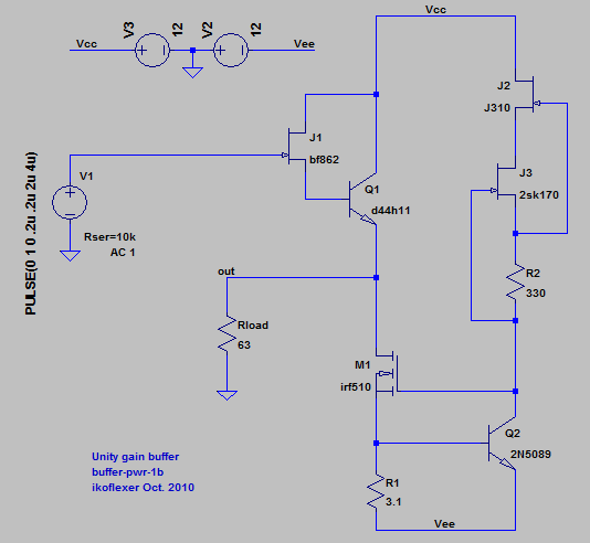

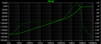

- What about that buffer?
