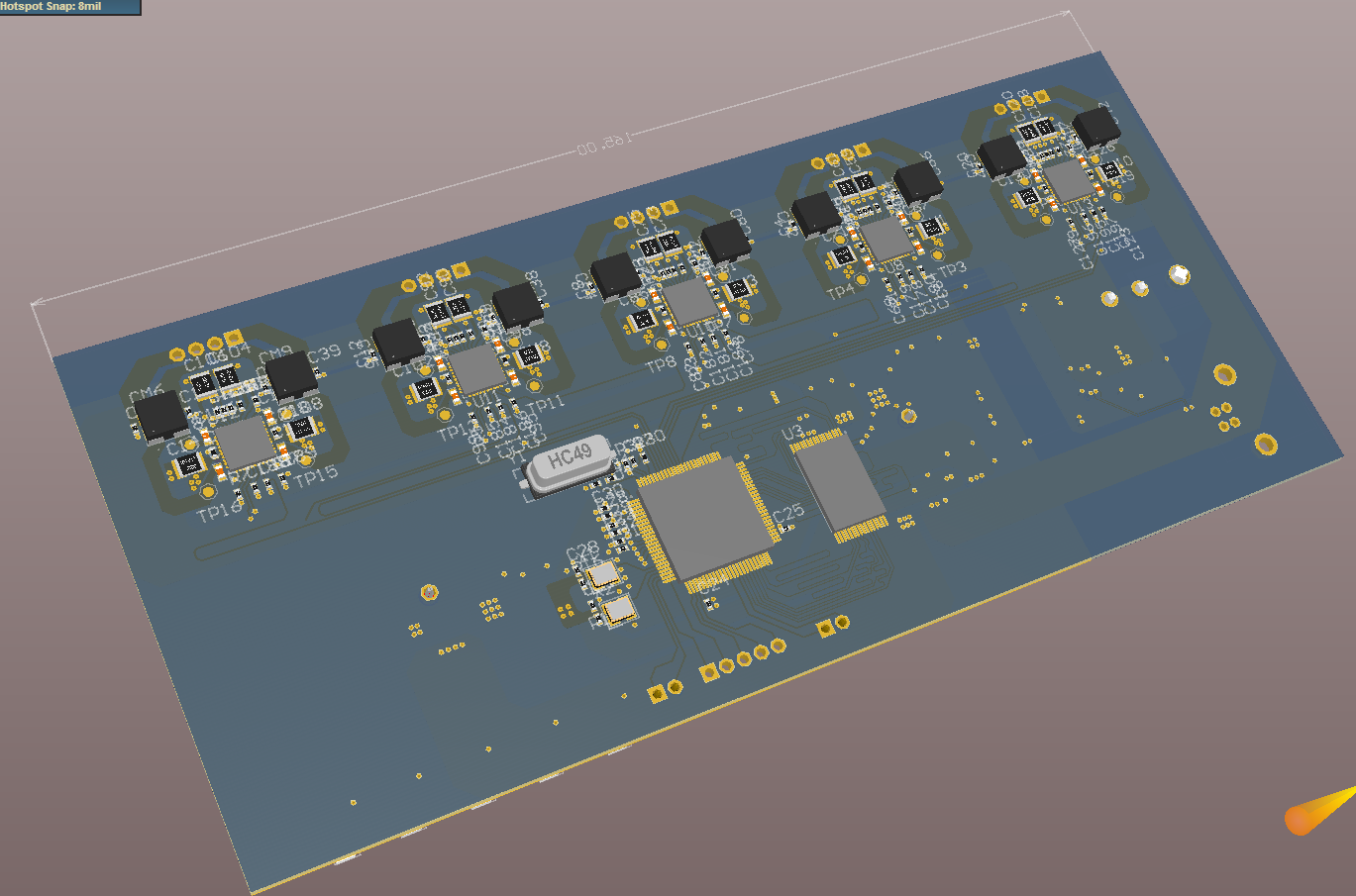

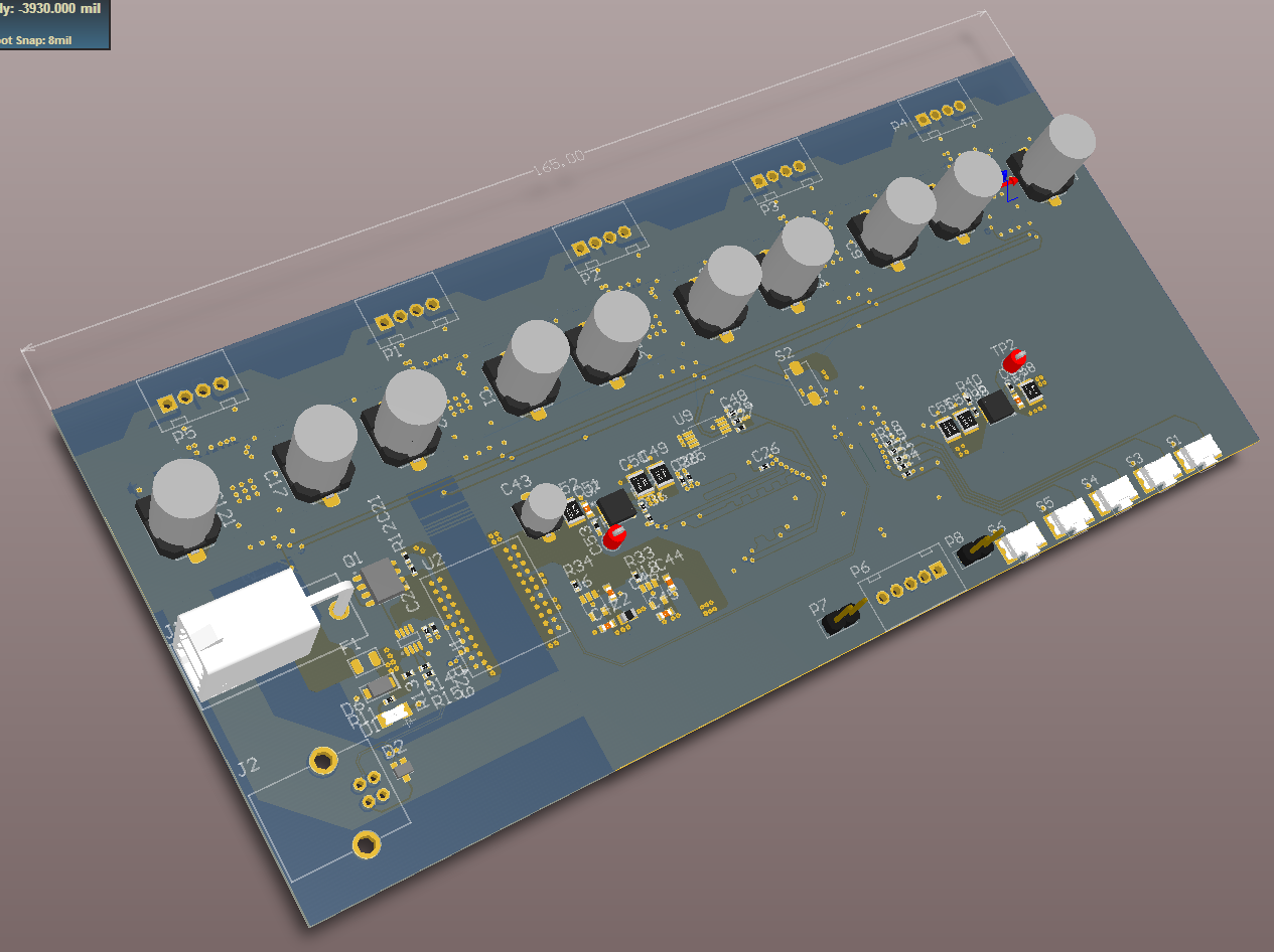

Update. Nearly Done the CM6632A 10ch isolated amp. :) The active area is isolated from the USB port and from the PVDD supply to the mosfets inside the SMM3582.
I hope to sample this mid April. Cleaning up the silks.

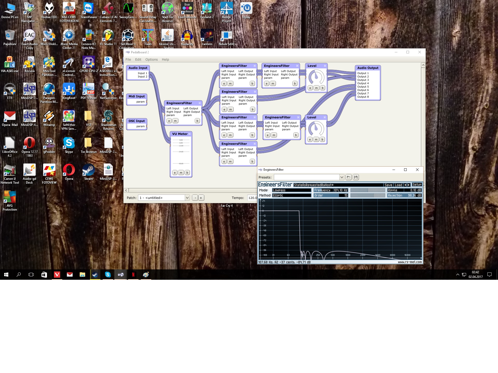

I just got to mention my most recent magical solution for multiway setup.
VB cable + Pedalboard 2 (must use 32bit version) + EngineersFilter with high order elliptic filters.
Ridiculously good, and simple!
Perfect for a 10channel amp!
I was so ready to make the move over to direct connection through i2s with a minisharc from Minidsp, but that's not gonna happen now! :)
