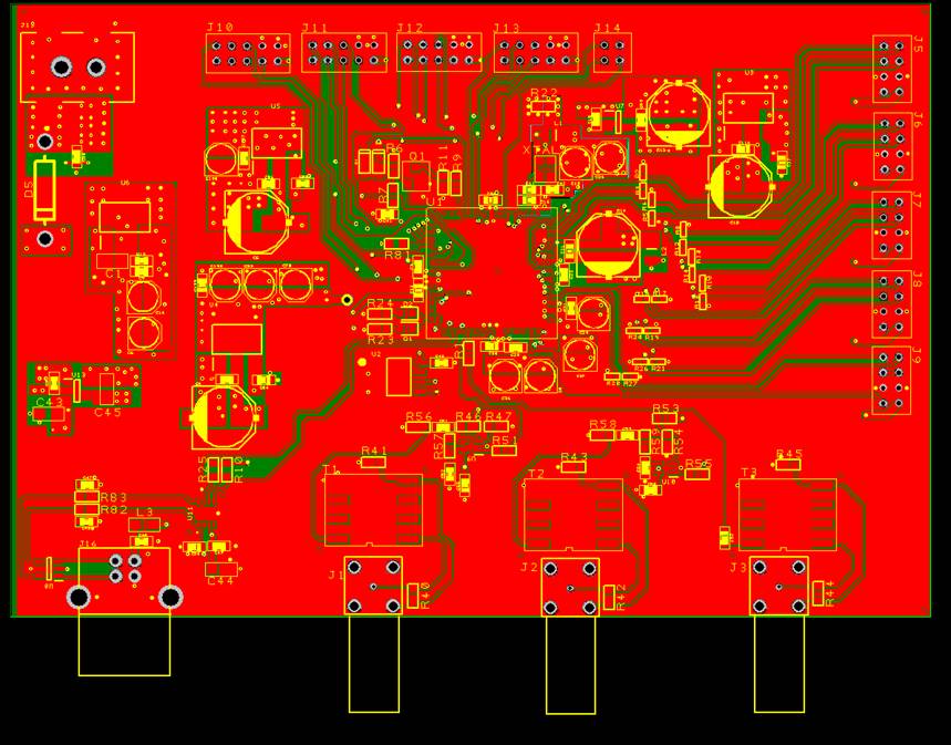

I have several boards on the go using the D2. One is simply a bare bones DSP with no on board amps. Much smaller too. Attached.
2 x sdpif_in (isolated)
1 x spdif_out (isolated)
12 x i2s I/O (including DSD, Intel HD Audio and TDM).
18 x pwm out
simple usb/ftdi programming
balanced line header
The on-dsp ADC is ok. I hope to publish some tests for that soon.
For the powered version previously discussed I'll add another SSM3582 to make 6 channels. In theory I could make a 12ch version with the SSM set to stereo with extra output headers as the d2 supports a 12ch signal flow. At the moment for main power I use a Vicor 120W 8-60v input - 16.0v out CoolPower DC-DC. I added the PIC for USB for programming, LCD headers, buttons and volume control. The USB port supports i2s streaming over USB. I've connected i2s output from the PIC with the DSP providing i2s clock source. We'll see how that goes. 🙂

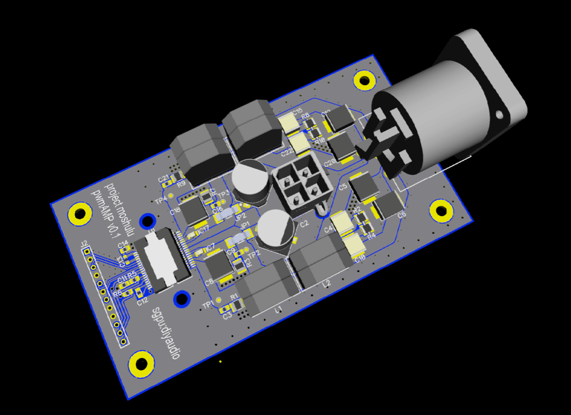

The Audio Processor Workbench from ST is quite good really. I've toyed with that a few times. I designed a 2 x 250W amp using the ST516BE (FFX) with 2ch Speakon output. Pic attached. Not had a chance to build or test it yet though. :-( Might change the input header to dual micro BNC. I'm not sure what I would do with the protection feedback signal. Maybe ignore them! ;-)
Back to the SSM 6ch board. I've added the 6th channel. Hope to have the layout finished Wednesday for you guys to comment. I'm open to any changes! 🙂
