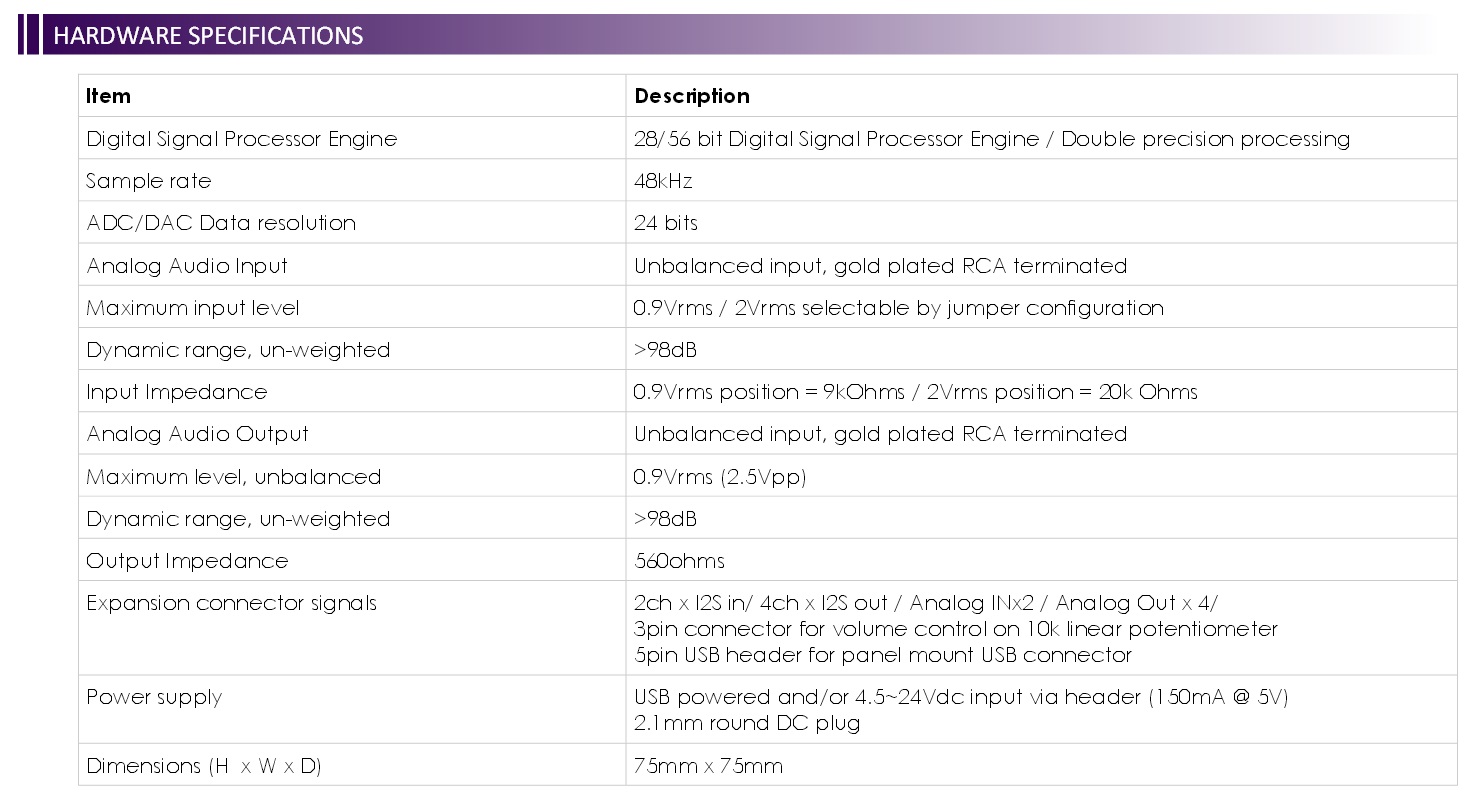

'Cause I was just about to 'upgrade' from my miniDSP (ADAU1701):
miniDSP (ADAU1701)

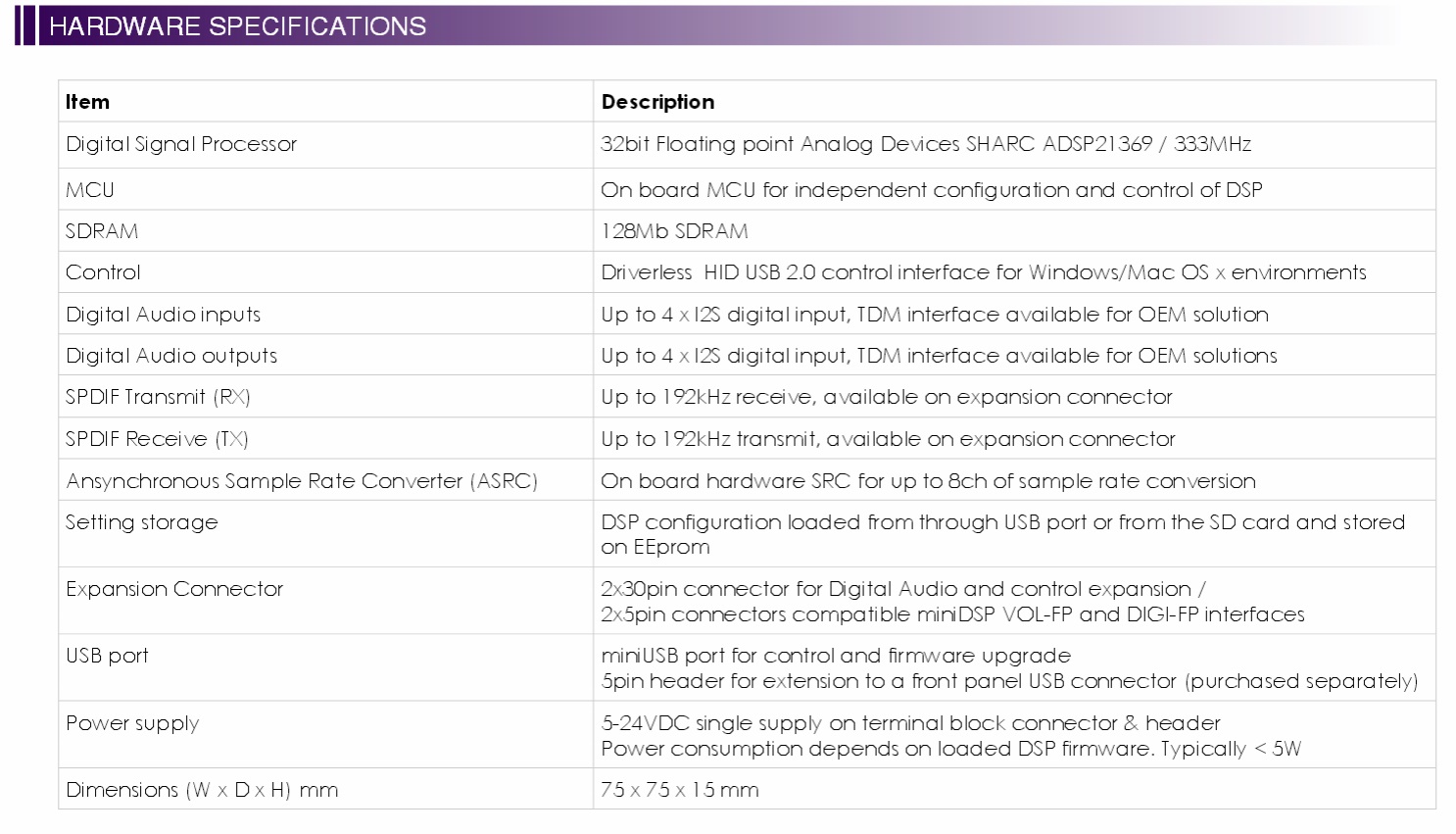

to my miniSHARC (ADSP21369)
http://www.analog.com/static/imported-files/data_sheets/ADSP-21367_21368_21369.pdf
miniDSP (ADAU1701)
vs miniSHARC (ADSP21369)
... and go alll ... FIRy 😉

miniDSP
DSP 28/56 bit DSP Engine / Double precision processing
Host Processor 48MHz microcontroller
Sample rate 48kHz
ADC/DAC Data resolution 24 bit
miniSHARC
Digital Signal Processor 32bit Floating point Analog / 333M
MCU On board MCU for ind conf, CNT
Sample rate 48kHz
SDRAM 128Mb SDRAM
