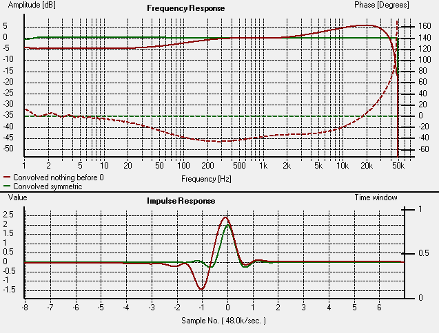

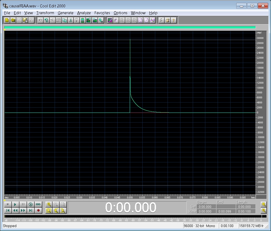

EDIT - you mean from post #75? Those are linear phase and non causal, you want the causal "nothing before 0" version see attached or the phase will not be correct (like an R/C version). I don't think the "inaudibility of phase" goes that far.
So this looks like a non-problem. There are any number of free software packages that allow you create amplitude/phase spectra simply from the circuit poles and zeros and a little complex algebra. Then you generate the impulse response with something like an inverse Hilbert transform to generate a minimum phase one. The entire gamut of historical curves could easily be generated.

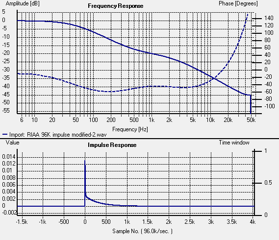

Thanks Scott! I will edit my files to causal. In tests I didn't see the phase problems, just some small amplitude errors. Perhaps this will fix it.
Cooledit (and some other programs) only show the magnitude of the FFT, your impulses looked pretty good on magnitude. Flattening the phase will cause time domain errors compared to a real RIAA. I'm working on a Python worksheet to do the calculations.
