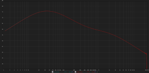

I just built one of these with a 1st order high pass. I can export this file in REW as an impulse wav or text. Is this frequency response acceptable?

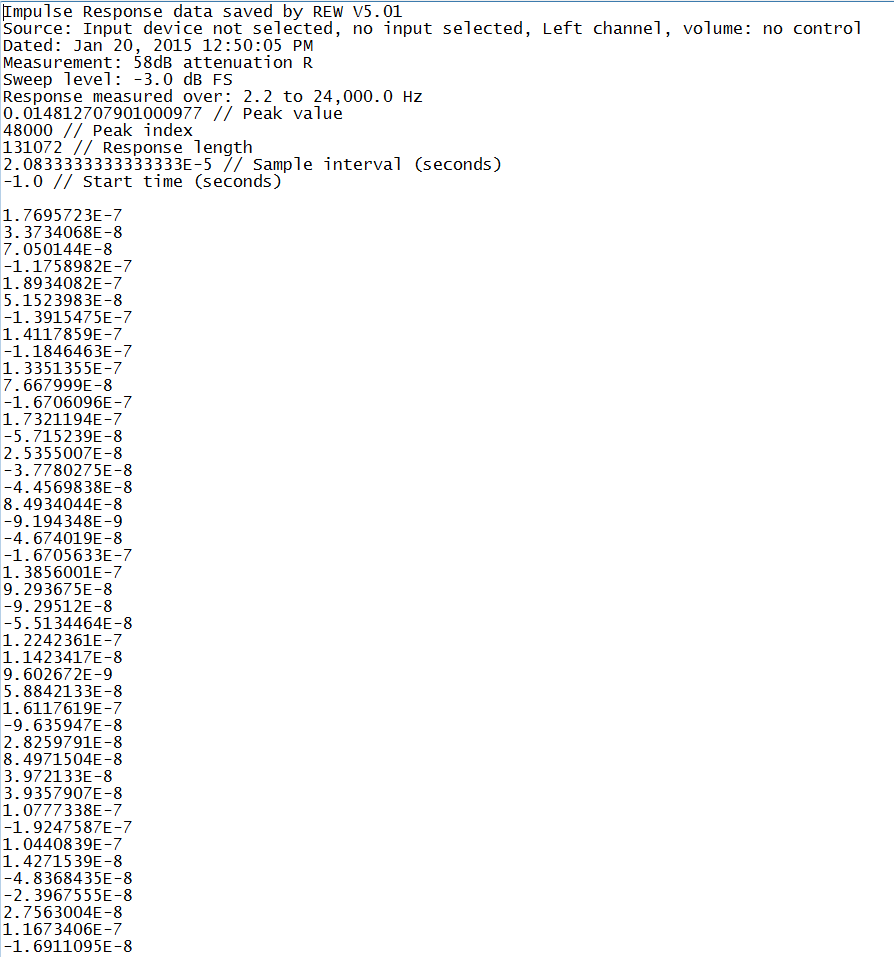

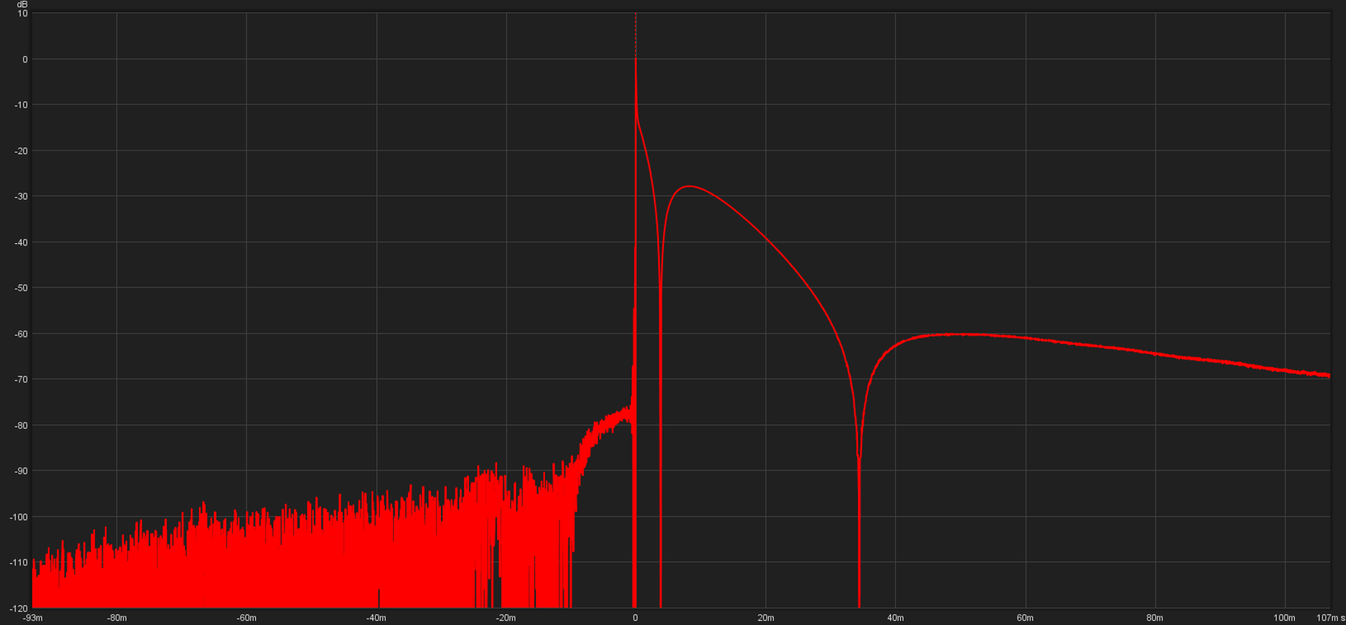

You need the time domain impulse response not the frequency domain for FIR filters.
I am too stupid to know what you're talking about. REW lets me export a text of the impulse response. I was showing the freq res so you could decide if it is close enough of a RIAA curve to what you need. This is a screen cap of a small part of it. Is it what you need? I can't post the text file because it is close to 2Mb. PM me your email if you want it.
