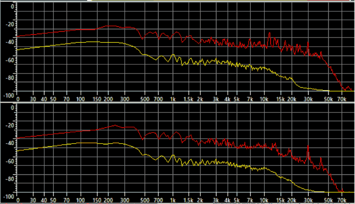

Red is peaks for the whole file, yellow is a rolling average.

OK, I took the signal and ran a 20K low pass filter. Verified no content above 22K.
Then ran a hard overdrive distortion effect on it and high passed that at 22K. Now plenty of >20K content. Results are very similar to the content of the original signal, but a little harsher. I suspect the style of harmonic effect is the reason. Still follows the rhythm of the song, same channel balance.
It certainly could be distortion on the original. Maybe from the cutter head or its amp? It's interesting that this content is only found on a few rare LPs. It doesn't sound like anything not related to the sub 20K content. I.E. not noise.

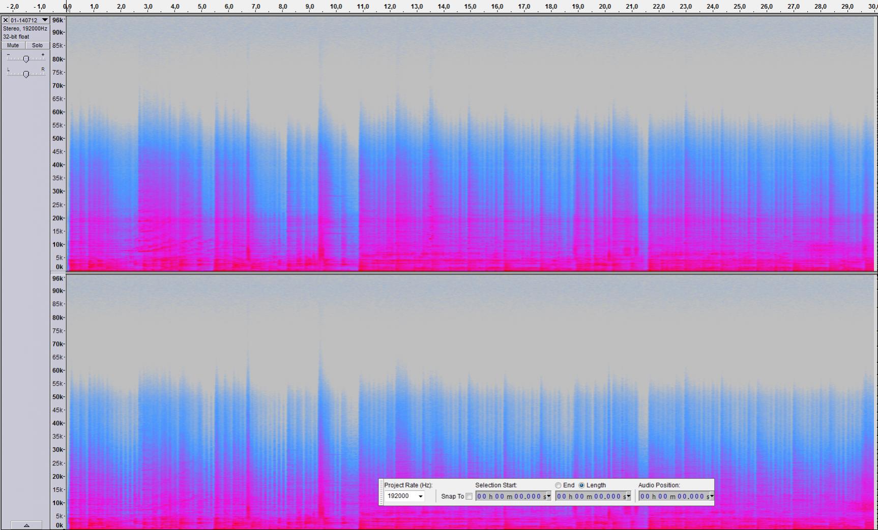

3 i don't think it's an excellent idea to cut away frequencies above 20KHz.
One of the best part of a vynil record is it eventually doesn't cut frequencies above 20KHz, as per red book, but it is very common to see records with an audio band until 60KHz.
Of course one cannot listen to that frequency, but the effects of modulation still reflects on in-band contents.
So, to be really perfect, it's necessary to think the audio band - and the riia file too - from 20Hz to 60KHz.

Since my old phono cart doesn't go nearly that high, this will not be of any concern to me. :) But it is interesting that this >20 kHz content does show up on some LPs. It certainly seems to be signal related and not noise - but what causes it? Is it actual content from the master, or is it distortion in the cutting process?
Has this been seen in direct to disk recordings?
Back in 2014, on that other forum, I got reply by Steve Grant:
Doug Self in his Small Signal Audio book (page 168) explains about the 50kHz roll off in Neuman SAL 74B cutters and, according to him, there is a 2 pole roll off at 3.19uS giving 12dB/Octave Roll off. The loss at 20kHz is less than 0.1dB.
I worked for Westrex until its demise in 1984 and our cutters also had a 49.9Khz roll off.
