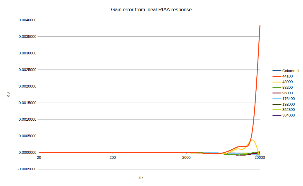

I have also released today this RIAA coefficient builder prototype as Matlab/Octave code (not yet tested in real time application):
Code:% RIAA equalization filter % Standard samplerates from 44100 to 384000 supported % Brought to you by [email]jiiteepee@yahoo.se[/email] (8 April 2020) function [b, a] = RIAA_deemphasis((x, inverted) % x = samplerate in Hz % inverted : true = emphasis, false = de-emphasis switch x case { 44100, 88200, 176400, 352800 } a(1) = -3.78572821649894E-17*x^3 + 2.52492635019007E-11*x^2 - 5.29140550506889E-06*x + 0.4183761420686; a(2) = -3.29659785253531E-17*x^3 + 2.18188804908089E-11*x^2 - 4.49558809614241E-06*x + 0.340803782016109; a(3) = 2.13427162324699E-17*x^3 - 1.44832812129522E-11*x^2 + 3.14910650666778E-06*x - 0.270743433143131; a(4) = 2.43878784135422E-17*x^3 - 1.63703244700658E-11*x^2 + 3.47872123422787E-06*x - 0.284280409184197; a(5) = 5.14722389769101E-18*x^3 - 3.44467018649422E-12*x^2 + 7.27288189729686E-07*x - 0.05855692642697; a(6) = 1.78214502585031E-19*x^3 - 1.18972620155484E-13*x^2 + 2.49862328884841E-08*x - 0.001987028069768; b(1) = 1.0; b(2) = -4.55290631534176E-17*x^3 + 3.04003816124316E-11*x^2 - 6.38623072649445E-06*x + 0.036651228977512; b(3) = -2.17886339309136E-17*x^3 + 1.45484739554451E-11*x^2 - 3.05694119649456E-06*x - 1.15432992268202; b(4) = 3.87367489428091E-17*x^3 - 2.58899887170957E-11*x^2 + 5.45011238426768E-06*x - 0.156383761864616; b(5) = 2.40425973859099E-17*x^3 - 1.60789566553566E-11*x^2 + 3.38997016926901E-06*x + 0.247425823969509; b(6) = 2.54127108991136E-18*x^3 - 1.70179240935058E-12*x^2 + 3.59921561223217E-07*x + 0.041145736788926; case { 48000, 96000, 192000, 384000 } a(1) = -2.7452780571244E-17*x^3 + 1.99154393419583E-11*x^2 - 4.53584676661555E-06*x + 0.388910789461241; a(2) = -2.35251182142996E-17*x^3 + 1.69460468999989E-11*x^2 - 3.79976340701253E-06*x + 0.313417459710588; a(3) = 1.60394779826124E-17*x^3 - 1.18134248157214E-11*x^2 + 2.77914944092047E-06*x - 0.256686985639999; a(4) = 1.79214193481841E-17*x^3 - 1.30758453834294E-11*x^2 + 3.01551209856552E-06*x - 0.266372686264431; a(5) = 3.75875129146243E-18*x^3 - 2.73515275421544E-12*x^2 + 6.27167882845746E-07*x - 0.054669929110542; a(6) = 1.29466085326558E-19*x^3 - 9.40021380146474E-14*x^2 + 2.14525398501157E-08*x - 0.001849383721124; b(1) = 1.0; b(2) = -3.31087520545089E-17*x^3 + 2.40419060193625E-11*x^2 - 5.48704255441296E-06*x + 0.001655256200658; b(3) = -1.58217404372195E-17*x^3 + 1.14907596097219E-11*x^2 - 2.62396853400952E-06*x - 1.17120945842617; b(4) = 2.82267460112979E-17*x^3 - 2.05145448671967E-11*x^2 + 4.69079915137507E-06*x - 0.126870578343129; b(5) = 1.75227789917925E-17*x^3 - 1.27437895605759E-11*x^2 + 2.91872050553504E-06*x + 0.265751206588621; b(6) = 1.85456891004083E-18*x^3 - 1.35060949072864E-12*x^2 + 3.10309889494121E-07*x + 0.043074905938478; otherwise b = [1 0 0 0 0 0]; a = [1 0 0 0 0 0]; end if not(inverted) c = b; b = a; a = c; endif
This is enough accurate filter in question, even for 44.1kHz sampling, but, it is 6th order IIR implementation. If needed it can be turned to second order sections (SOS) with few lines of Matlab/Octave code (each sample rate needs its own set of SOS coefficients):
Code:% Octave related package (comment next line for Matlab) pkg load signal format long; fs = 44100; % user variable [b, a] = RIAA_deemphasis(fs, inverted = false); FLT=tf(b, a, 1/fs); [a, b, T] = tfdata(FLT, 'v'); [sos, g] = tf2sos (b, a) save -append RIAA.txt fs sos
Took a look of magnitude accuracy of these filters.
Copy of error plot attached.

That amazing. Would any LP ever made be cut at anywhere near that accuracy?Took a look of magnitude accuracy of these filters.
No. Jiiteepee, good to see you still have energy for this. One precaution when you break a high order IIR into biquad sections you can have numerical error issues depending on the order. At 96K only two biquads do +-0.000010dB all the way to 20kHz.

Yes, and a 3 pole IIR can do better, as like (quote from R. Orban's post at comp.dsp)
... but the question is: "how you do it".MAXIMUM ERROR FROM 0.00 Hz TO 20000.00 Hz IS 0.0000046dB

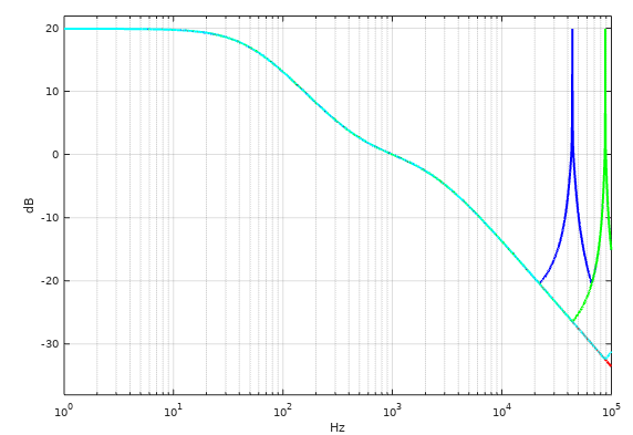

For outputting up to 60kHz you'd need use sampling rate of 120kHz (Nyqvist's sampling theorem) --> so, if we follow the common rates, your audio interface should support at least 176.4kHz sampling. Many audio interfaces uses limiter to filter out HF content so ... .
Here are RIAA responses for common, 44100 based sample rates (range 1Hz - 100kHz (blue: 44100, green: x2, cyan: x4 and red: x8)):
Copy of same image attached.
