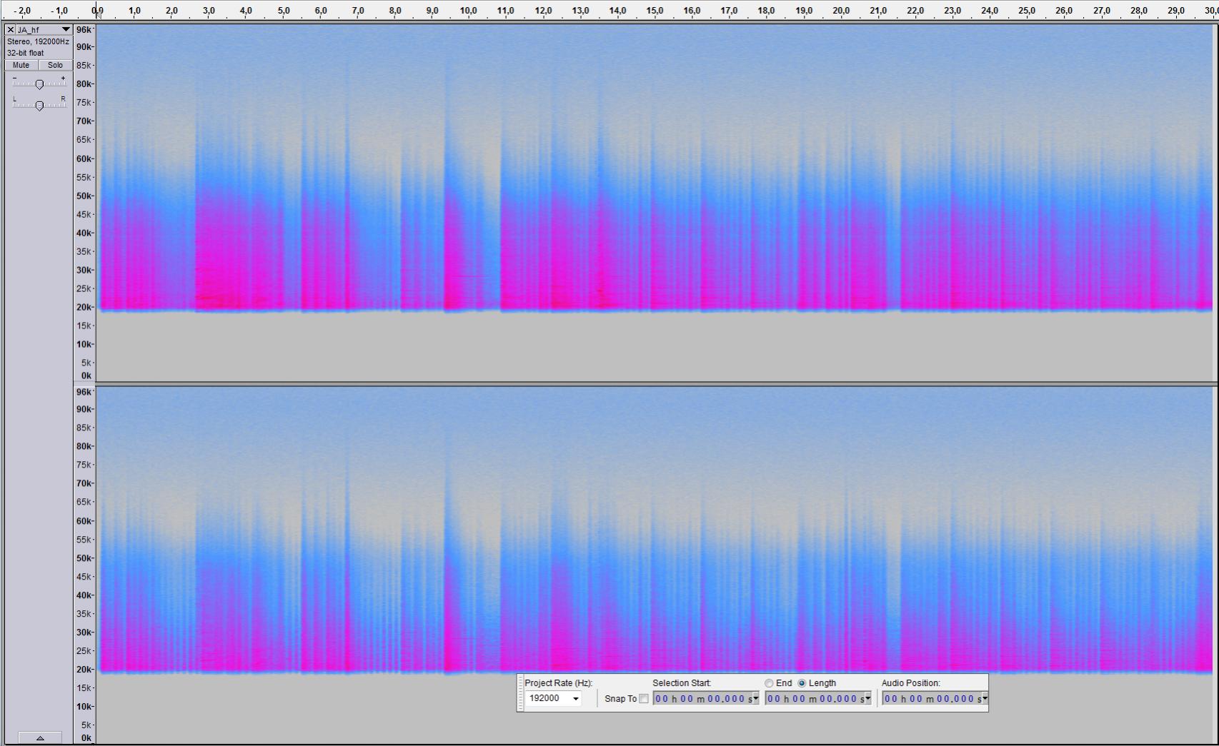

Attached a spectrum plot from 24-bit/192kHz recording (Technics EPC-205CMK3 - Pro-Ject MM RIAA pre-amp - E-MU 0404 USB (!! 44.1, 48, 88.2, 96, 176.4, 192kHz from internal crystal with no sample rate conversion.))
And what part of it is the original signal, and what is distortion/harmonics?

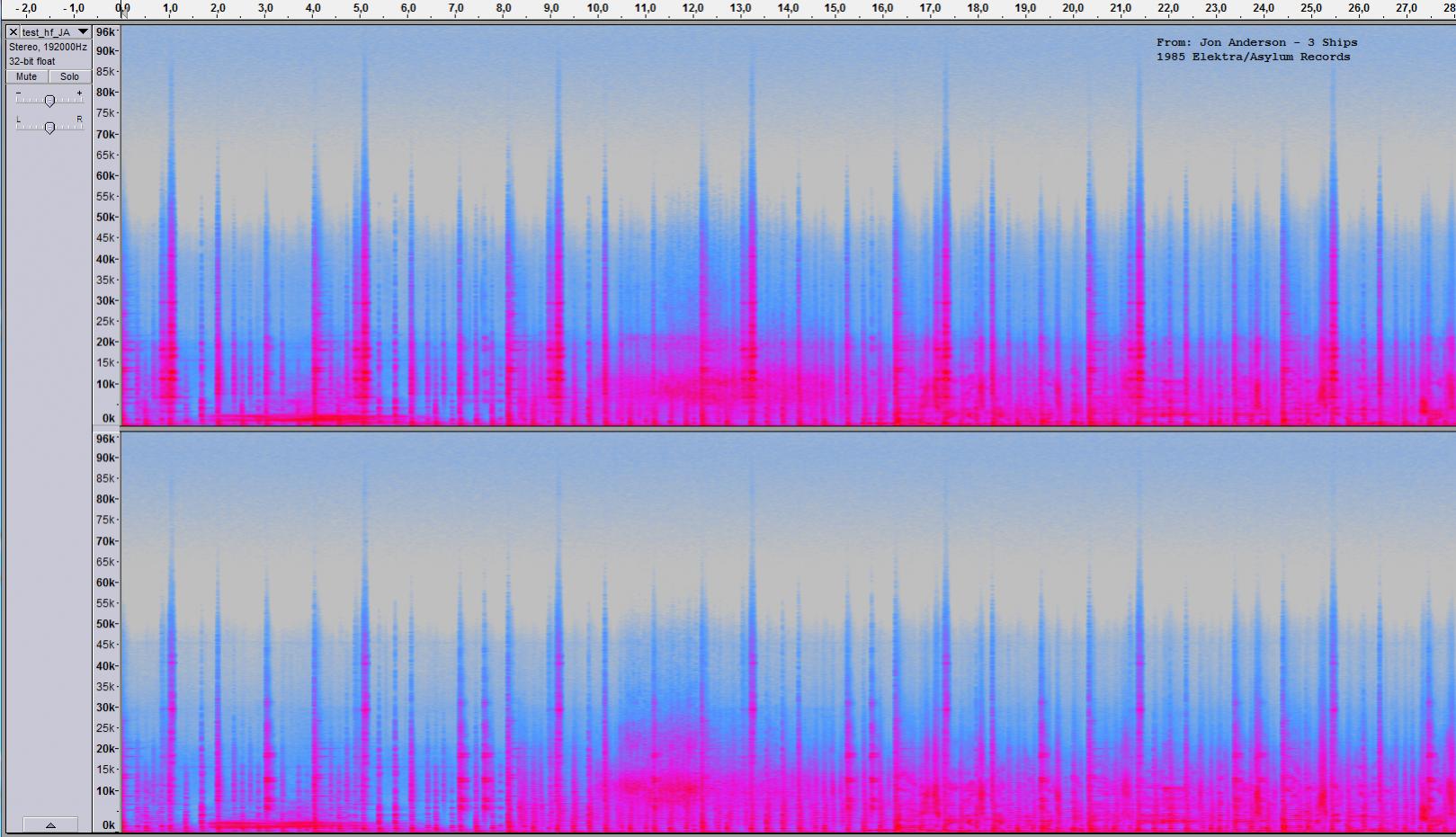

Hmm... who knows, but, that's what I get out from the analog part (TT, RIAA pre-amp) of my vinyl recording setup. If you extract the >20kHz data from linked .flac you still be able to follow the song (structure). Attached the spectrum plot from above 20kHz frequencies.
What are you trying to say here? You sampled at 192kHz so there is something possible out to 96kHz (BTW unlikely from the cartridge/LP). Listing the other sample rates has no relevance, besides if you are looking simply at the ADC data sample rate conversion has no meaning.
What are you trying to say here? You sampled at 192kHz so there is something possible out to 96kHz (BTW unlikely from the cartridge/LP). ...
205cmk3 outputs up to ~80kHz and when TT is removed from the recording path (RIAA pre-amplifier is still there), left is about flat response after applying inverted RIAA .... :D
Read also my previous post... :rolleyes:.

Certainly plenty there, tho I don't know what it is. Real content? Distortion?
Anyway, here it is high passed at 20K then pitched down a decade so that the lowest frequency is now 2K. File attached is a FLAC inside a Zip folder.

Most likely power-line/EMI trash incursion.
Nope, that would be seen in spectrum when TT is on-line ... and it isn't there :violin: .
Not all recordings give that high frequency content as what my example recording is showing ... I found only handful of cases from my few hundreds LP's collection ... shouldn't "power-line/EMI trash incursion" show up in all cases ... ?
