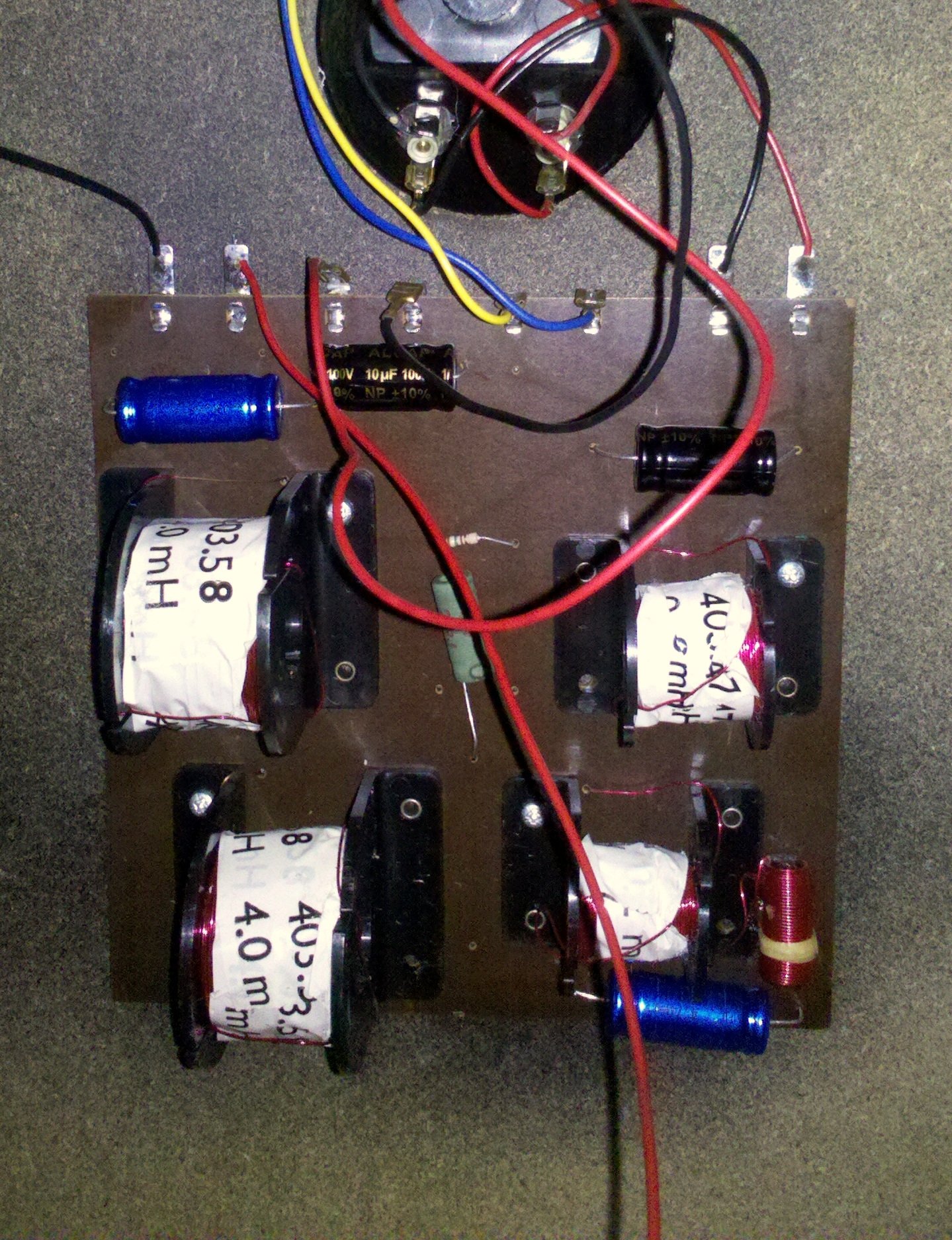

For anyone interested, an Alcapped Crossover for a Glendale XP2. I did one cap at a time, the markings on the 33uF capacitors were very faint, but I could read them so was able to confirm correct values for each one as I put them in. I used a suction solder remover to help free the old Elcaps from the big blobs of authentic 1970s solder.

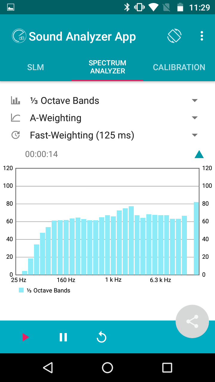

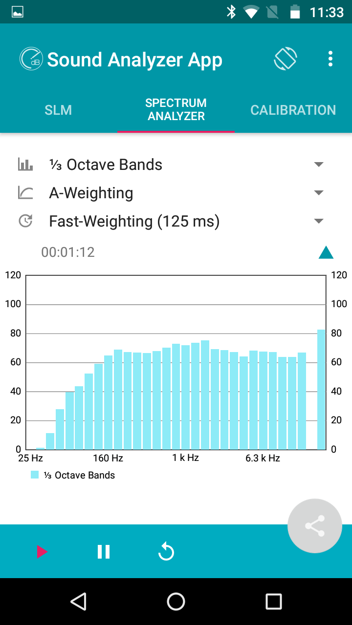

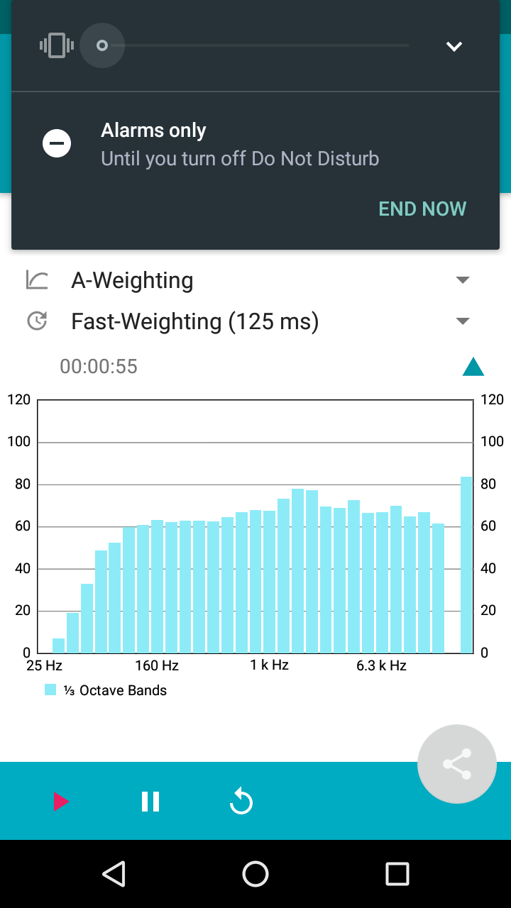

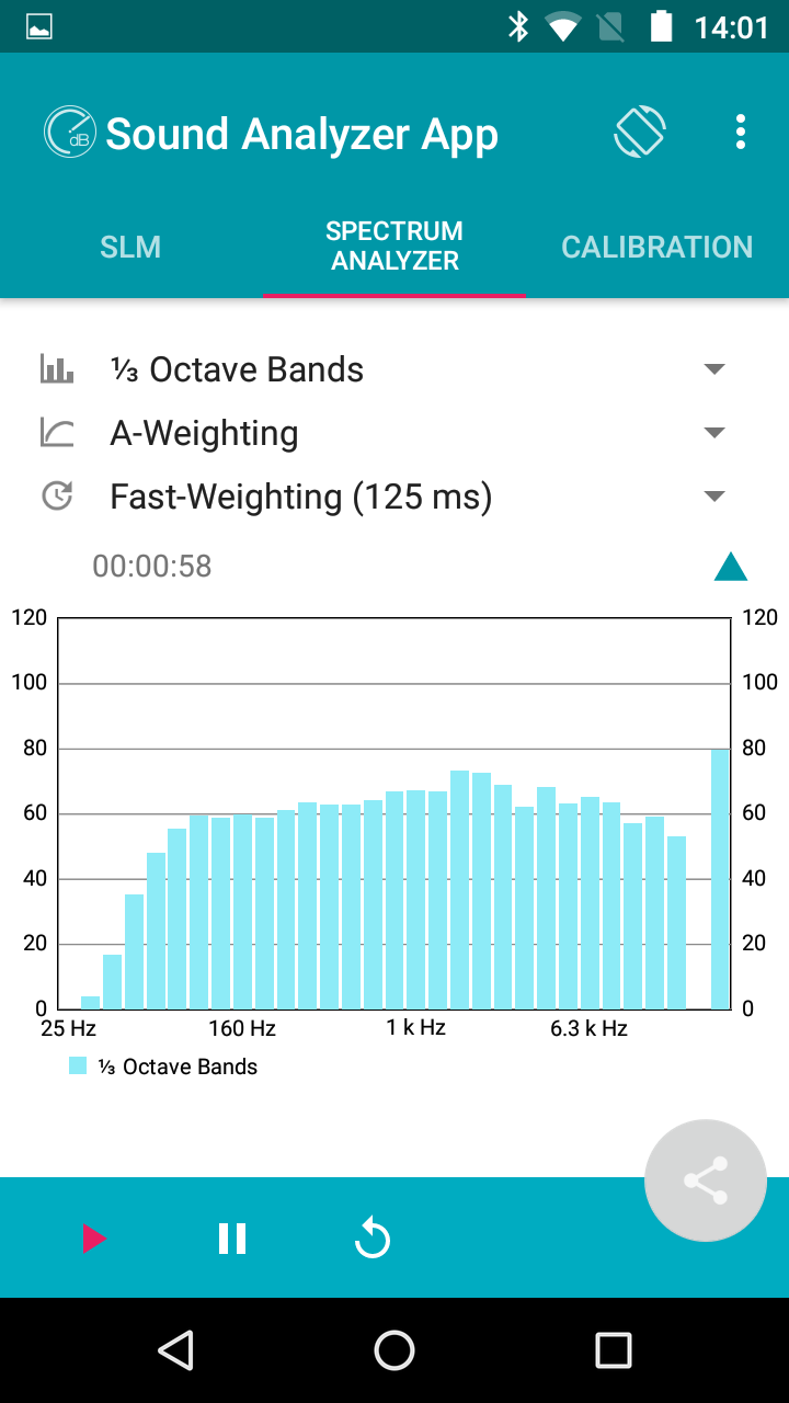

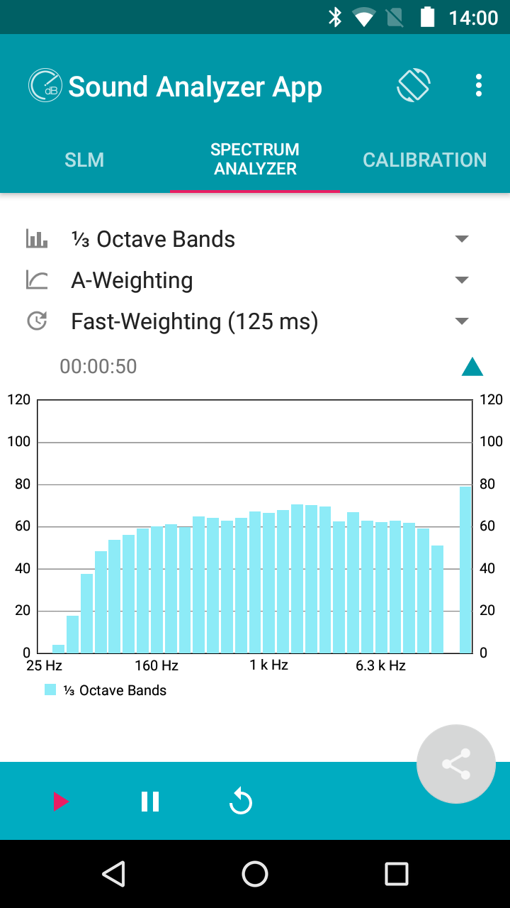

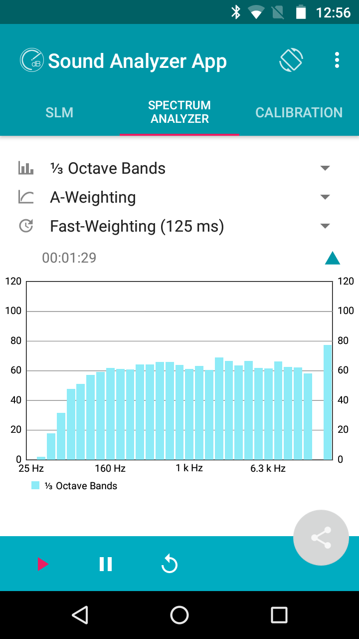

The G3 not very responsive to snapshotting via the power + down_vol buttons (every day a school day), so these are genuinely random samples. Pink noise on a single speaker with same volume setting. The Glendales (right) look to have a fraction more bass and a little peak from 1 to 2khz that is smoother on the Deltas (left). My observation that the Deltas need less volume not evident here. I would have thought that the Delta 30s come out of this pretty well - they will be an asset when relocated to my hobby room.
Unfortunately that peak from 1 to 2khz is well over 10dB and appears to be creating a harshness that I initially thought was liveliness. It seems to affect strings and piano, but it's likely to be a problem for human voice as well. I didn't notice that harshness before, and I'm wondering which driver it's likely to be, and which of the Alcaps to revert first to see if the Elcaps were doing it too.and a little peak from 1 to 2khz
The crossover points are 1.3 kHz and 4.5 kHz so the problem is likely to lie with the mid driver.
The 4.7 uF will be associated with the tweeter high pass filter and the 32 uF with the woofer low pass filter.
This means that the two 10 uF capacitors must be associated with the mid driver band pass filter.

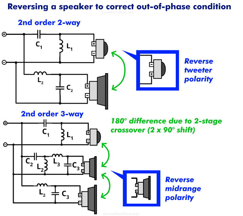

P.S. It would be worth checking that all drivers have been connected with the correct electrical polarity. Both the mid and the tweeter are likely intended to be of reverse electrical polarity to the woofer, i.e., the mid and treble negative terminal go to the positive speaker input terminal whereas the woofer positive terminal goes to the positive speaker input terminal.

Look at the '2nd order 3-way' crossover schematic below that will show the basic layout of your Glendale XP2 crossover circuit.
I note the speaker specs say "crossover rates 6 dB and 12 dB per octave".
It is possible that the mid driver filter is 6 dB per octave, meaning that it comprises only of one capacitor in series with one inductor.
Or perhaps the bass filter consists only of a series inductor.
I also see extra components on the crossover board, such as the little tubular inductor at bottom right, that are likely to do with response shaping.
If we find we need to dig deeper into the crossover layout, it would help if you should list the capacitor values, starting top left on your photo of the board and moving clockwise to bottom right.
In addition, if it is possible to read the mH values written on all four white inductor wrappings please list them clockwise from top left.

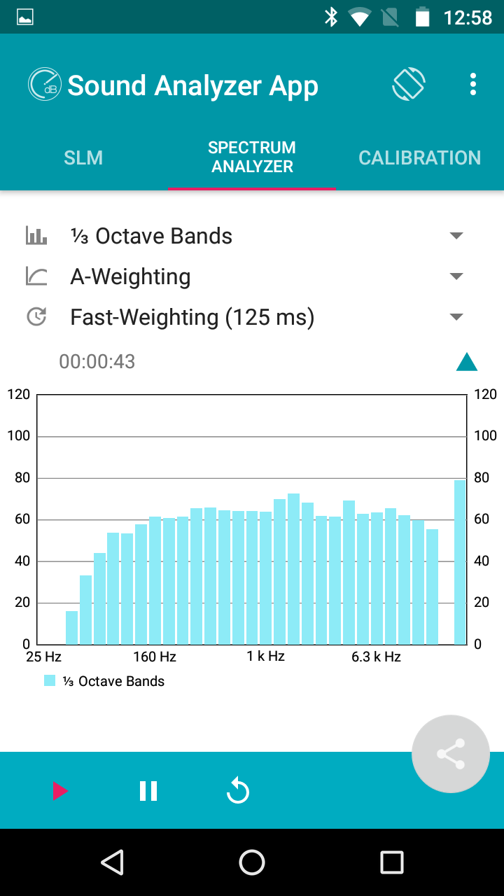

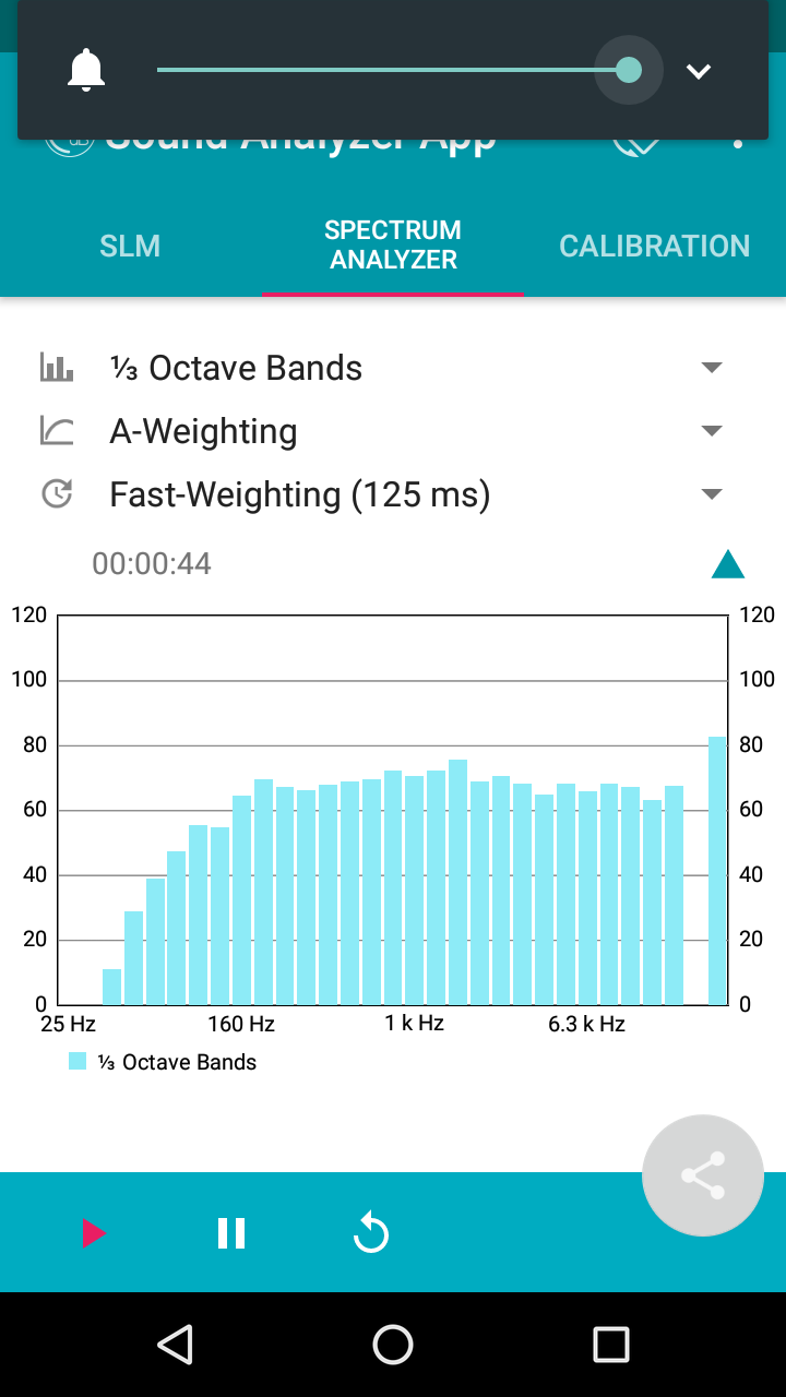

It suddenly occured to me that I hadn't run the spectrum analyser on the right speaker - happily that looks (and sounds) OK. It was always unlikely that the recapping was wrong in principle, and this would confirm it. I'll check the drivers are connected correctly and if that's OK remove the crossover and have a look for a dry joint.
Edit: A very obvious dry joint found and fixed on one of the 10uF caps!
