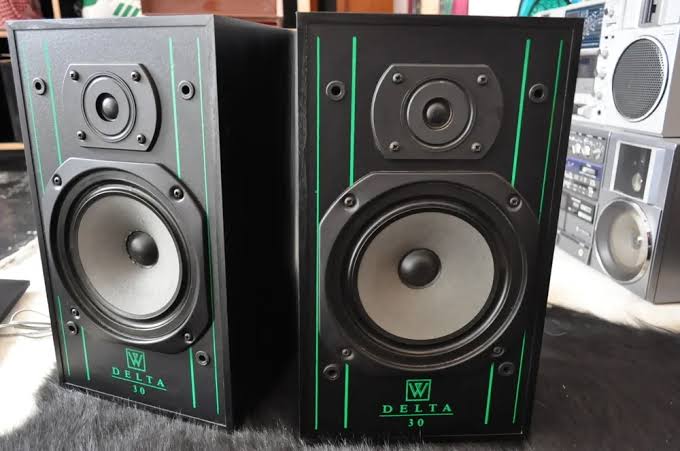

This saga only started because the bass woofer in one of my parent's old SS-40 music centre speakers had died. I had been planning to just run with those, but when I took them apart I realised just how nasty they were. However in their time I liked them both with FM radio and CDs played through the CDP-313 and a nice little Sony tuner/amp that I plan to use with the Delta 30s.
