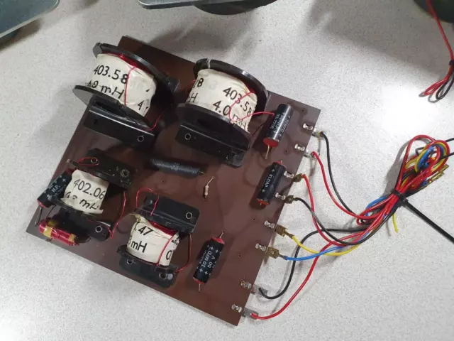

After New Year I set the Glendale XP2s up in the Living Room and played chirp and pink noise samples through them and the Delta 30s. The Delta 30s flunked the chirp test as there was a definite discontinuity! The Glendales though were good right the way through. I evaluated the pink noise sample using a smartphone frequency analyser app and there was drop off sub 45hz and above 16khz in both, but the Glendales were more even over all. Since then I've listened to hours of variable Classic FM and have come to appreciate a sort of dignified smoothness and power that reminds me of my parent's radiogram. One interesting difference is that my Sony TA FE370 amp needs to be set slightly higher for the same volume as before.
The plan was to recap them, and I did put in an order with Falcon for the required Alcaps, but I haven't received a confirmation for my order, and will not bother to follow up. In conclusion I'm now very happy with the way they sound (and look!) for £80 plus the diesel to collect them.

I really do urge you to replace those unreliable black and red ELCAP capacitors in the Glendale XP2 crossover.
I did so in my friend's Wharfedale E50 speakers which proved to be transformative, particularly in regard to the bass reproduction.
He had been using the loudness control on his amplifier, but after the capacitor replacement the bass firmed up and that was no longer necessary.
I recommend the German made Mundorf Ecap capacitors from Wilmslow Audio that are available in 33 uF, 10 uF and 5 uF values:

I'm tempted to say something about the designer of Glendale XP2. He wanted to achieve just that 😉listened to hours of variable Classic FM and have come to appreciate a sort of dignified smoothness and power that reminds me of my parent's radiogram
The chirp test seemed to start pretty low, but the frequency analyser app did suggest it was dropping off down there. Anyway, it turns out that Falcon Acoustics have taken my money, so I'll take that as a sign to chase them up. At £28.84 all in, it's almost rude not too to find out if I can hear a differenceI really do urge you to replace those unreliable black and red ELCAP capacitors in the Glendale XP2 crossover.
I hadn't consider that there was anything wrong with them, so just thought it mildly interesting - it was just a blip and will investigate futher once they're set up in the basement.At what frequency was the discontinuity?
It turns out that if you misstype your email address - you don't get a confirmation email or anything else until you chase them up, when you get an almost instant response. My capacitors are in the post and should be with me tomorrow - brilliant service!it turns out that Falcon Acoustics have taken my money

I did recap some warfdale speakers from my father (Linton XP3) with the same kind of caps on the crossover. They are high ESR elco's, so if you repalce them with low esr elco's of filmcaps, you need to redesign the crossover with the old as guid (for slope and crossover frequencies), otheriwise the sound will be off. You will have to attenuate the tweeter more than with the old crossover, and probally put some resistor on the parallel caps of the woofer to get the same filter. Just replacing those old high ESR caps with modern caps without measuring and adjusting the rest of the crossover is a receipe for bad sound.
We are talking about replacing those unreliable ELCAP electrolytic caps with reliable ALCAP electrolytic caps - not film caps.

Capacitors are here, first crossover is exposed and at my mercy, and I'm about to toy with molten metal...
They [ELCAPs] are high ESR elco's, so if you repalce them with low esr elco's [...] the sound will be off.
According to Falcon Acoustics: "A loudspeaker which has been voiced using ALCAP capacitors, or where ALCAP are replacing ELCAP capacitors, will remain true to the designer's intended sound character."
I don't know those alcap's, but i don't trust vendors on this. They mostly talk about what earn them the most. But if the esr is similar, than it can be good. You can try them if you think it' good, but ifnot, you will have to solve it different.
It's hard to know what the origina est was of the elcaps that went bad, so measuring your speaker would be good anyway to know. Modern caps have often a way lower ESR, especially film caps. If those alcaps are made to replace elcaps, they probally also kept the ESR similar (or they should have at least).

To be exact:
The 4.7 uF ALCAP is a low loss version equivalent to the 'ELCAP LL' capacitor version. This may be an advantage when used as the series feed to the tweeter.
The 10 uF and 33 uF ALCAP capacitors are equivalent to the standard 'ELCAP' capacitor version.
Well I couldn't measure a difference with a smartphone app, but yes they do sound livelier with a lovely smooth and powerful bass. Galu's hat survives to be eaten another day!

Very happy with Falcon Acoustics service and the Alcaps, though surprised to find that the 4.7uF was the same size as the 33uF.
The discontinuity in the chirp on the Delta 30s was on the stream from the Roberts Radio as it happened again on the Glendale XP2 testing - this time I spotted it on the radio display.
Falcon Acoustics only state that the low loss 50 V range capacitors are larger than the standard 50V range capacitors that is being phased out in favour of the 100 V low loss types.
I can only suppose that the larger size is a consequence of the construction technique required to achieve the low ESR (Equivalent Series Resistance) and "high ripple current capability".
