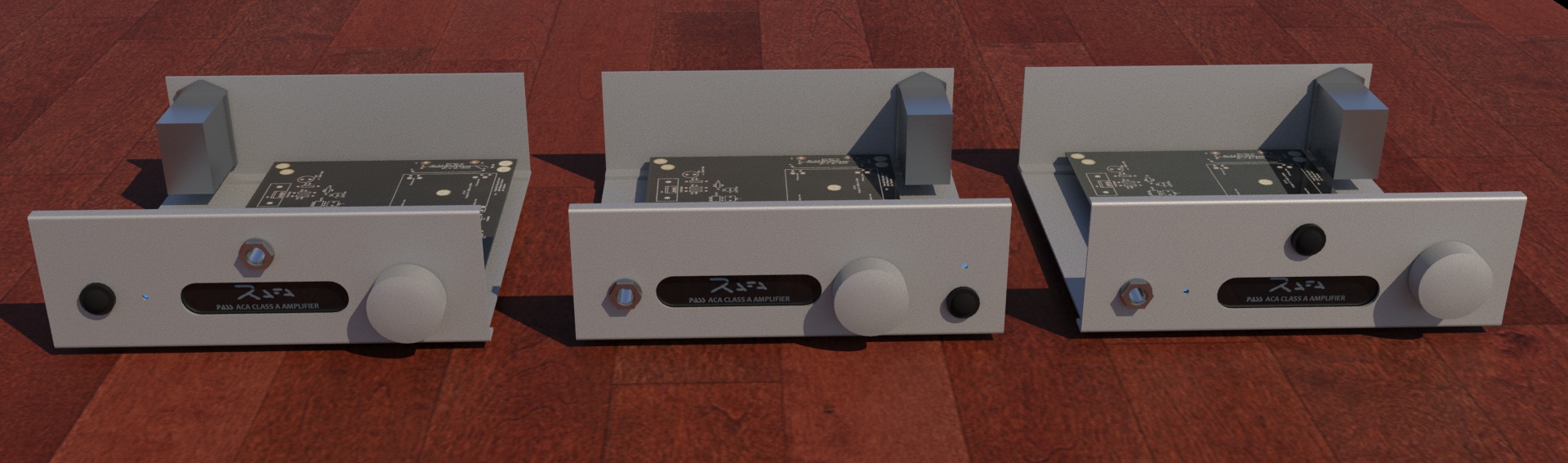

(included front switch and the best way to send 110v 'across' the Chassis without risk of affecting the audio section).
I'd suggest using a couple of wires. Twist together as they hold AC. 🙂

You don't want to recommend the overkill approach of a rotary switch mounted at the rear with an extension shaft all the way up front?I'd suggest using a couple of wires. Twist together as they hold AC. 🙂
5mm I think.
I'd save the shaft for input switching before I'd do it for power, but that's just me.
Great, thanks. I just don't want to be stuck with a 5mm cap and 2.5mm or 7.5mm spacing and no way to get those stubby leads in there without jumpers and making a mess of it.
And I honestly never bother looking for 2 pos rotary switches, so I never really worry about it either. I'm still not sure if I'll bother trying to figure one out or not if I've already got a switched PEM.

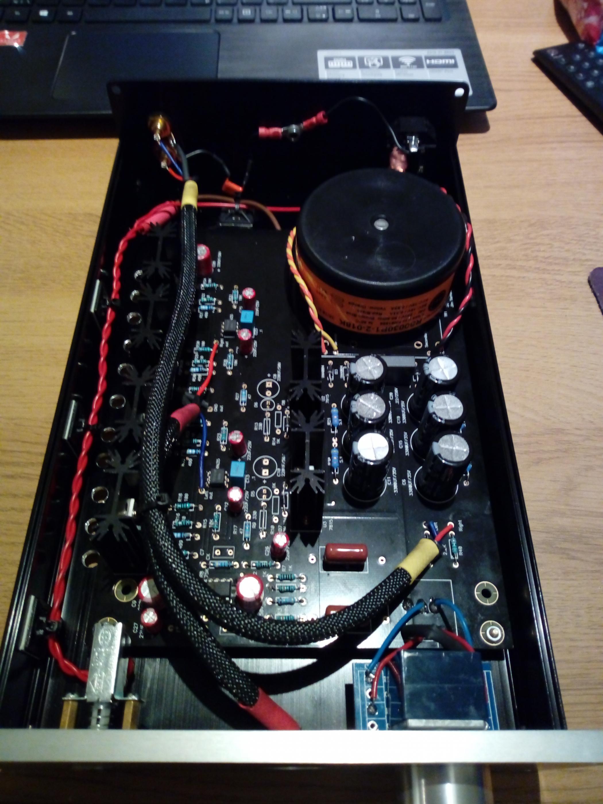

Whammy sings for the first time.....
But when connected to F6, normal listening level with pot full clockwise position !
F6 is only 11 o'clock position when driven by BA3FE unit.
How to use Whammy as a Preamp ?

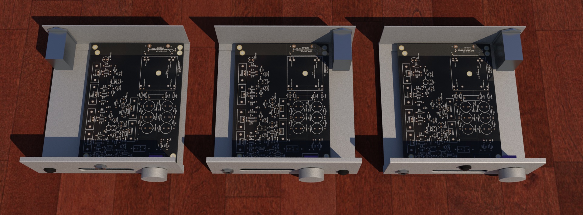

Well, I think I'm ready to decide upon a case distribution and wanted your always enlightened advice!
Since I'll be matching my WHAMMY with my ACA, the width of my case is a bit wider than most cases showcased here. That gives me a little freeway in terms of placement.
I have narrowed it down to these 3 options:
Lets call them A, B, C from left to right.
The 'simplest' and 'cleaner' approach is B:
So... this evolved into A:
My final and preferred look and approach is C:
So, my questions at this point are:
As usual, thanks for any feedback, suggestions, critique, etc.! I really appreciate it.
- It has the Power connector right next to the Transformer
- It leaves all the 'power polluting' items (including front switch - rendered as a black blob -) on the right hand side of the case
- Has the Pot mounted ON the PCB (more on this later)
- Has the poorest aesthetic value
- It has better aesthetic balance...
- ... but sacrifices the cleanness and gets the power input near the 'audio' side. Still off the PCB (the front power switch will reside on the far left of the case)
- What bothers me is that the power cables will cross beneath the RCA inputs and through the back of the PCB into the AC connectors on the other side
- Still, not the best looking option
- Worst thing is the headphone jack on middle-top... really un-intuitive placement
- It keeps the power input next to the transformer
- It looks balanced and every connector and knob is where it should be
- It has a CENTER front power switch. This involves a cable from back-right to front-center (this sounds like ballet directions! 🙂 ) carrying 110V!!! to the front AND back
- To complicate things, this options has the Pot mounted to the front plate and NOT to the PCB. I will need to connect the pot to the PCB with cables, possible degrading the audio signal.
- Is there rason to be concerned about the 110V going fron the back to the front and back again through the middle of the case? Or will this not affect much the sound?
- How much of a sound degradation (if any) is there in taking the pot off the PCB? What has to be done to prevent problems?
- What am I NOT seeing that you think may be an issue when building these options?
