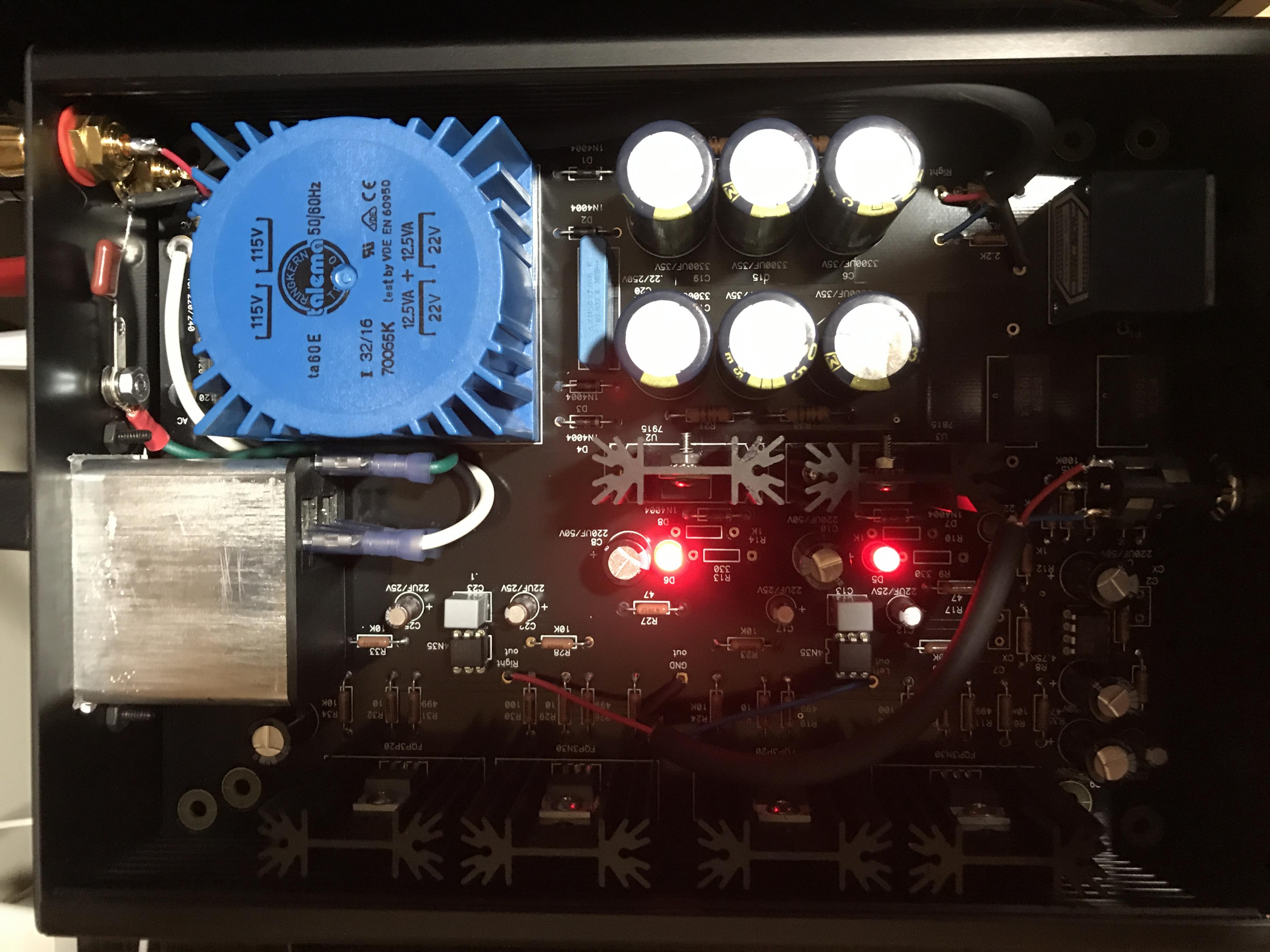

Hello all,
I just noticed some noise on this amp. The noise only comes when there is no source connection (nothing plugged in) and the volume is turned 3/4 to all the way up. I have a 0.1mf cap between the chassis ground and the negative leads of the RCA jacks. Should I try larger cap (maybe 0.47mf) or put another cap between the chassis and the ground of the volume pot?
Otherwise, when a source component plugged in, the amp is dead quiet and sounds great.
Thank you for your input.

Would it make sense to alter anything to accommodate a 'no source' problem scenario? When would you want to 'listen' to no source? If the amp is noisy with a source, then I would go to lengths to fix it. But I wouldn't try and change things happening without a source.
That's just me though, obviously!

I agree. I was only wondering if that noise was normal. This amp is great.
It might just do that because the input is pretty high impedance unterminated.

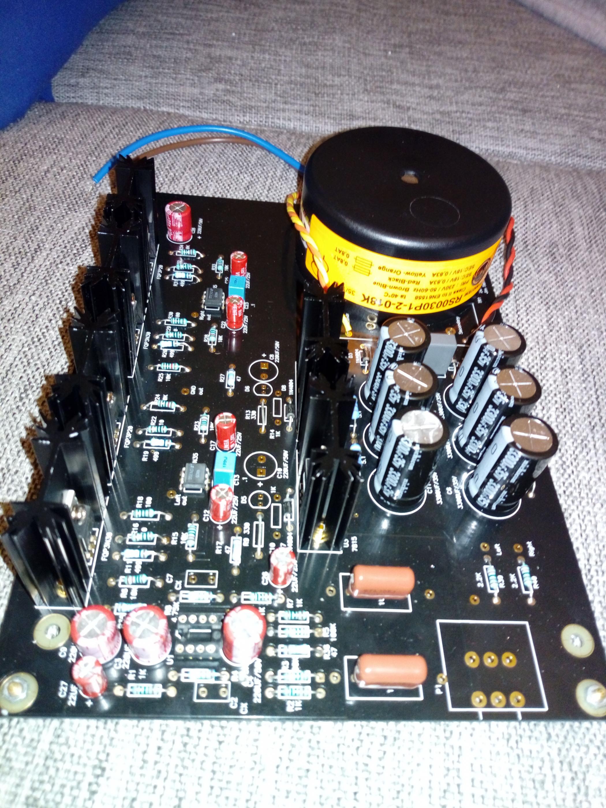

aheck, also check your R18 and R30. Looks like you might have swapped the 100K's into those positions which should be the 100 ohm you used in R3 and R5.
