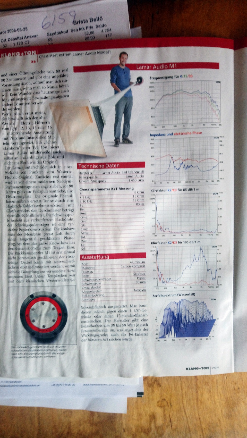

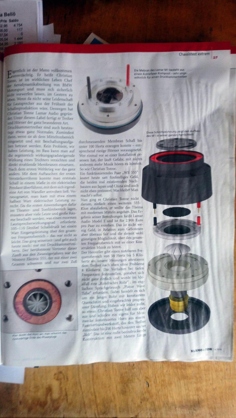

Apparently, Lamar was early with carbon membranes or glass fibre? Correction, Carbon membrane with glass fibre surround!
Is this bad? I have read this article in klang+tonApparently, Lamar was early with carbon membranes or glass fibre? Correction, Carbon membrane with glass fibre surround!
As i understood cabron diaphragm is harder and lighter than aluminium and titanium
