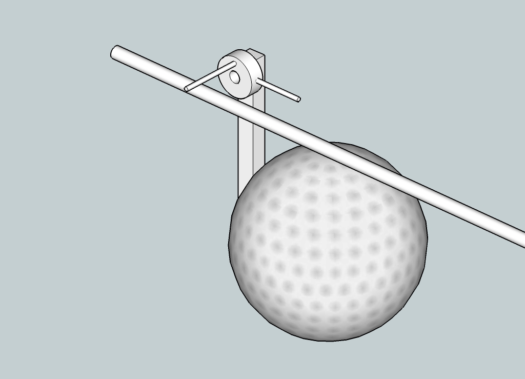

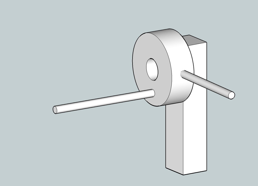

the absolute simplest idea may be something like this:

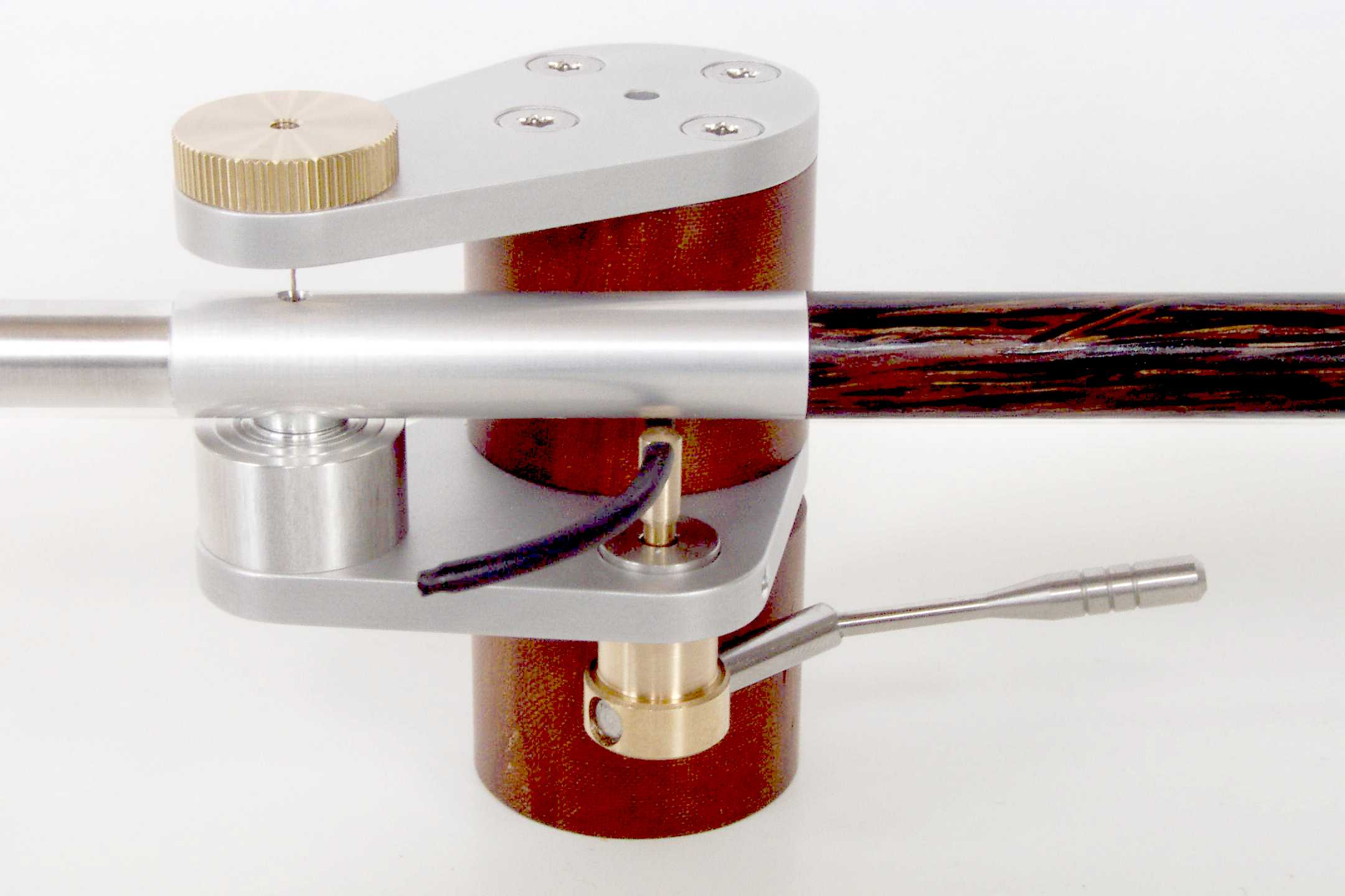

Arm Lift on Well Tempered TT
If you think about it, you will see that it would be difficult to use a conventional arm lift on the WT tonearm, since the bearing is not 'anchored' in the horizontal plane as a conventional bearing is. Upward lift on the arm would present upward lift on the golfball, which is much lighter (intentionally) than even the bearing assembly on a unipivot arm, which relies on gravity to keep the arm from jumping off its bearing when the arm lift goes up. I expect that prototyping showed that it took the arm too long to settle back into the silicone goo after droping the arm onto the LP.
Good one, Stew.
That would put the lift vector against the thread holding the arm in the horizontal plane without displacing it in the vertical. Looks to me like it should work.
I am building a WT tonearm clone for one of my ultra-lite B&O based TTs, so will try this idea 😀

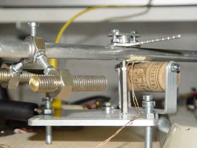

for my embryo (cinematic) tonearm the home minute made armlift with a "cork" (winebottle).the absolute simplest idea may be something like this:
(vinyl is almost better with good wine)
