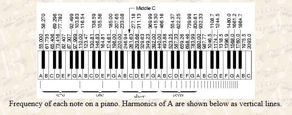

Yes, thank you that is what I meant. Also I agree 500Hz would be too low to be practical trying to take this and probably unnecessary as well.
OTOH 440 Hz is in the heart of music, middle C is 261.625565 Hz
reflections are still there and affecting tonal balance - in the heart of music
we are not talking about bass
440Hz is very critical, yes. This doesn't mean I think less of it. Its reproduction can be approached differently. Some DIYers might guide at that frequency but guiding isn't as necessary for success IMO.
Musical frequencies can surprise you. They are low. What is Middle C on piano? About 260Hz. Most instruments have no fundamentals above 1kHz. Though, of course, you are hearing much higher 2nd and 3rd harmonics which contribute greatly to the sound and timbre of a Steinway piano, or a National or Fender guitar. See below. 😎
This is why tweeters aren't actually as important as people make out. Above 3kHz, there is little significant musical output. It's why telephones are quite intelligable on voices, despite not much above 3kHz.

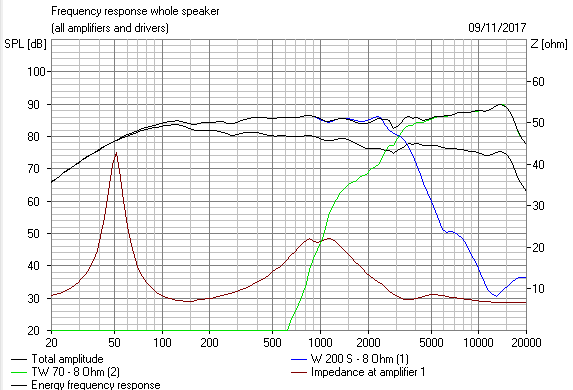

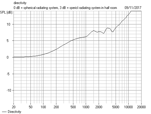

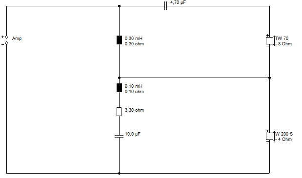

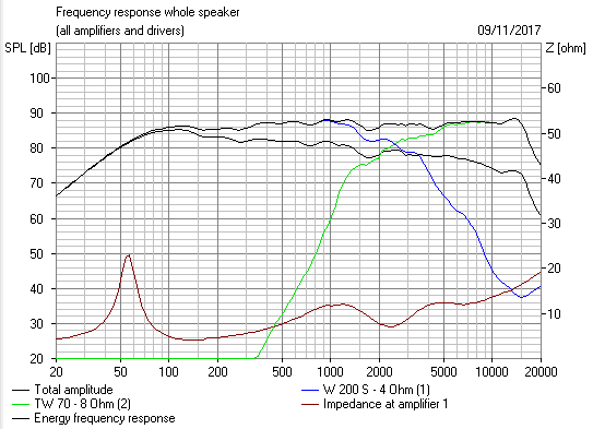

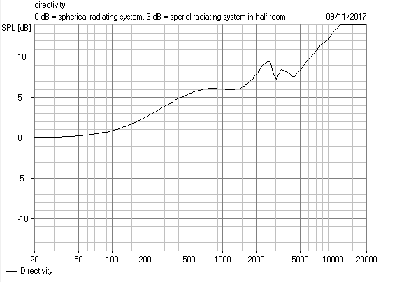

The shallower low crossover LR2 version has very smooth, but narrowing, directivity. My preferred steeper 3.5kHz BW3 version with a 6kHz notch is a bit rougher. But deals with distortion better, IMO.
...except that neither crossover is really what you claim it is.
If you look at the actual acoustic slopes (which are all that matters), they are all different, and steeper, than the respective 'textbook' LR2 and BW3.
In the second version, for instance, the woofer at 7kHz (one octave above the 3.5kHz crossover point) is down to 50dB, which is 36 dB quieter than the bandpass level of 86dB. This makes the low-pass slope closer to 6th order. And of course the phase response (which isn't shown) must start to nose-dive much sooner and much more rapidly than it would if the crossover were a real BW3.
Pretty much the same story applies to all those other HP and LP slopes too...
That's not to say that those crossovers can't work properly or sound nice. But I think it's a bit disingenuous to refer to them as "LR2" and "BW3" and discuss their pros and cons as if they had anything to do with those 'textbook' slopes.

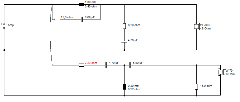

Thanks! Though I wouldn't describe that as "LR2" either.You designed a worthy 2.5kHz LR2 speaker here:
Much to like about that.
2nd order electrical? sure - but "Linkwitz-Riley" acoustical? Not really! 🙂

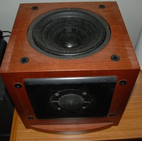

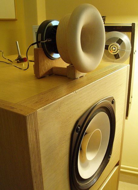

One of our forum treasures is Joachim Gerhard. I have heard some of Joachim's speakers, liked a few, criticised a few, but always interesting:
This is a narrow-directivity Mangar (near fullrange) design with Scan woofers to fill in the bottom end. It's extraordinary. Honestly. I've never heard a speaker that can compare with what it does. 🙂
I'll try and contain myself here, and just comment on what Joachim is up to right now. He's using these two SEAS drivers on a cap and coil filter. A lot to like there IMO. AllenB will get this.
I'll save toroids, pseudospheres and even 10D phase space for another day. Oh heck, lastly, here's a near fullrange tractrix design to enjoy. 😱
