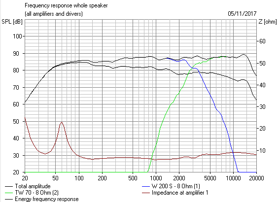

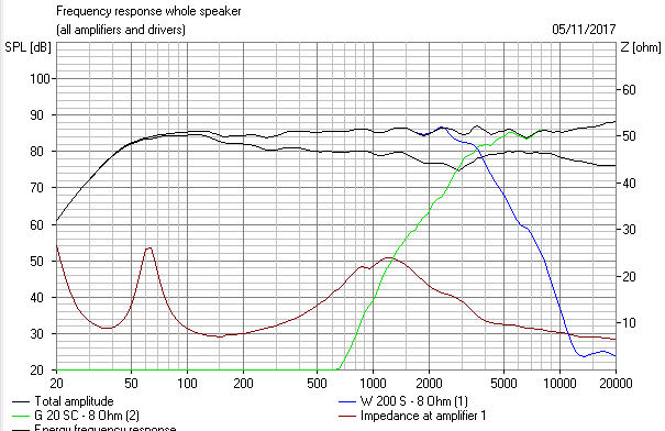

Here's a speaker I have built:
A biggish 2" cone tweeter falls off off-axis. It's how they work. So toe them in to your listening position.
I then did it another way. A small SEAS 3/4" metal dome has much greater dispersion.
These speakers have two very different sounds. It's not the frequency response that is wildly different. It's the power response. The smaller dome is spreading energy around the room, the bigger cone tends to direct it narrowly.
Visaton calls this "energy frequency response". It's the curve below the frequency response. And you can see the smaller dome gives much higher energy around 5kHz. Maybe annoyingly so. And it applies to bafflestep too, which can be avoided altogether by wallmounting the speaker. Interestingly, any sort of line-array loudspeaker sounds quieter to the neighbours, who are trying to sleep outside, whilst sounding just as loud to the people inside the venue on the dance floor who are still hopped up. Dispersion is a HUGE issue in loudspeakers.
Which is why MTM is a good idea, IMO.
