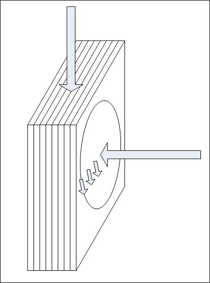

It all depends on the direction of the flux and the way the conductivity is. If the flux is broadside to the laminations, it will eddy big time My pic has it with flu from the right.. If it is goes the same direction as the length of the lams (coming in from the top), the conductivity is broken up by the insulation between the laminations. I use a glue, it takes up about 2% of the volume of the stack.
If you remove the glue or layer to layer insulation, then eddies can occur with respect to the flux coming in from the top in my picture.

Magnetic flux takes the path of least resistance just like electric current. So welding near the outside of of a turn in the magnetic path doesn't usually cause unacceptable loss. This "outside of a turn" also occurs in the middle of the center pole too, and is why the "nick" in the middle of the E's and I's for accomodating a mount bolt makes almost no difference in magnetic performance. Also, in output transformers a minor gap formed by non-interleaved laminations is not necessarily unacceptable either. The weld might become fairly saturated at high throughputs but it's such a small portion of total core volume it usually will not break the design. The welding is mostly done as a cost savings even though most power transformers are interleaved by machine, but it does yield a very strong mechanical assembly especially with the addition of varnish impregnation, which can really hold down mechanical noise, which is always a problem in gapped transformers run hard.
