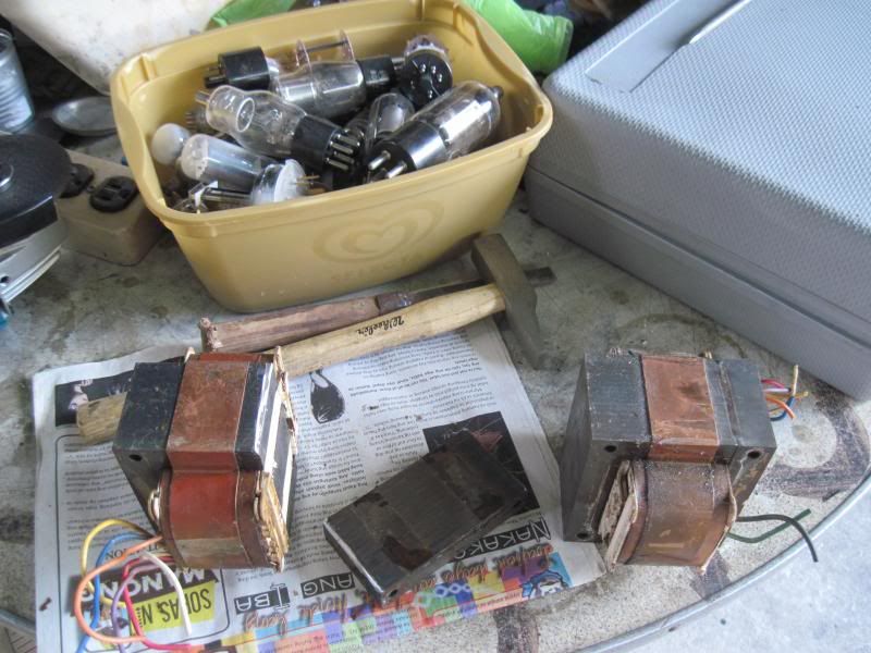

First and foremost we are talking about Microwave TXs, which are of a suitable core size....and perhaps key....non-interleaved laminations. Taking apart interleaved cores is a royal PITA. Once apart interleaved really don't want to go back together...& always when re-assembled the stack is larger than original...yes we could eliminate a few lams to fit but it seems it never gets tight enough. Perhaps it is not as bad as I have experienced, and others have had successful results.......but not me.

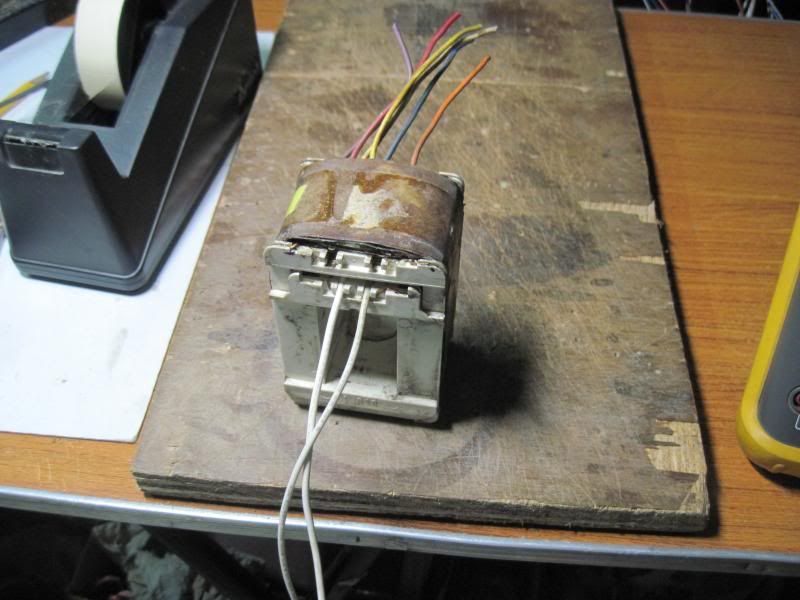

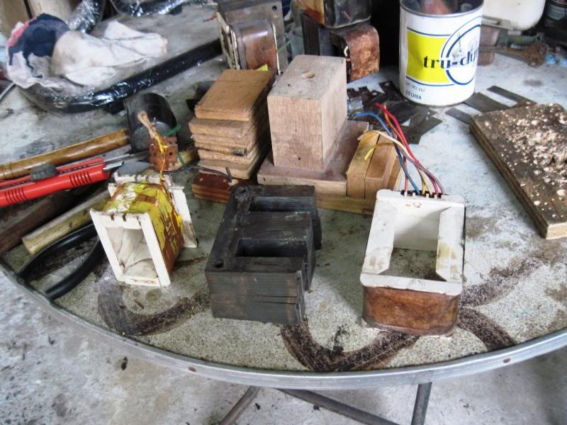

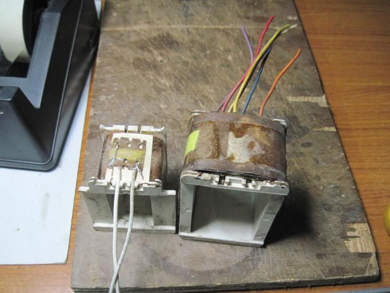

^in my case. 2 pcs of lams did not make it back into the traffo, it made no difference....the traffo i posted had its lams slightly smaller than a standard scrap-less EI 1 1/4 lam but outside dimensions were the same as with an EI 1 1/4 lam....so that it left me no choice but the reuse the cores......
grinding out the welded portion smooth so that the lamination separated quite easily did it for me.....if you have been working on these transformers you will know what i am talking about...
while going around the welded lams is indeed a royal PITA, working on the coils is very easy as the bobbin for the primary and secondary winding can be pried apart and only the primary winding is touched, i left the secondary coils alone....
at 100 volts i counted 220 turns #19awg, so that 506 turns of #22 awg magnet wire is wound on the primary bobbin for 230 volts ac input...
