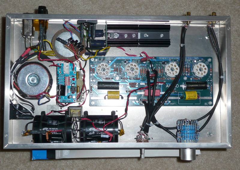

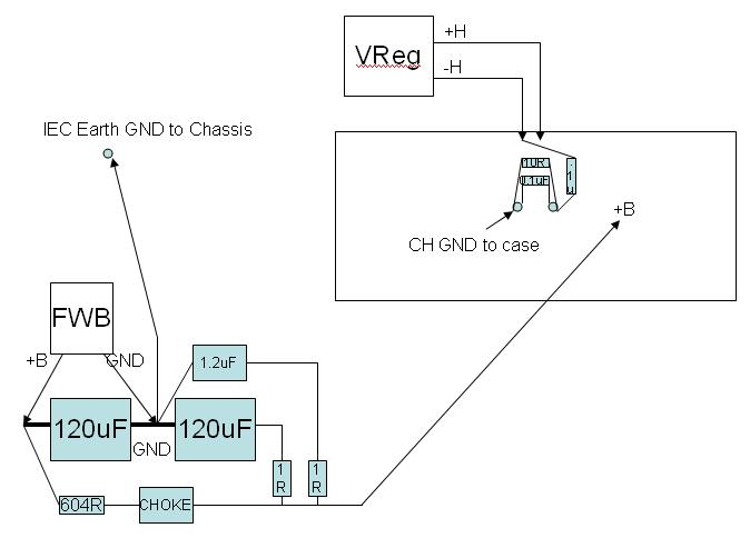

here is photo. the little diode board that is not connected is to drop the voltage into the volt. reg since I have 9vac transformer.
234V transformer is going into F.W.B. then to 100uF-604R-600mH choke-100uF(1R snubber) || 1.2uF(1R snubber).
little relay board on top of F.W.B. is +B delay. it's not hum that is picked up from touching anything, it's a low oscillating hum, like the star trek engines, best way I can describe it.

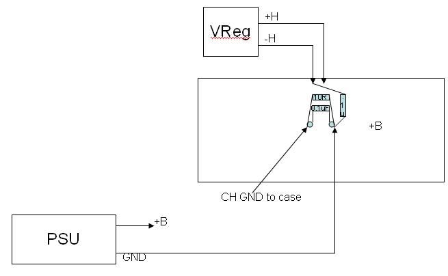

Bengali,
It looks like you have a ground wire from the negative side of the B+ connected to the Aikido board, yes? It also looks like you have a ground lift capacitor on the board to ground, yes? If so, remove the negative wire to ground from the Aikido board and run it to your chassis earth with a 20R 2W. You don't need 2 grounds to the board.
Are your signal RCAs isolated from the chassis?
Ron
Ron

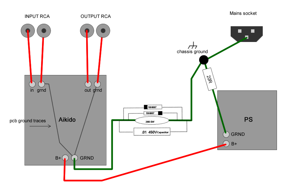

Hi Ron,
correct, +B and GND wire from PSU twisted going
to +B and GND on aikido board.
at the psu, it's star grounded, central point is between
the two big 120uF solen caps, all the grounds are tied
together there.
I'll give that a try, taking GND wire from PSU through a
20R resistor to Chassis GND. 10R 3W should work as well?
yes, RCA's are isolated from chassis, but I found that after
you wire the signal wires to aikido pcb, it no longer stays
isolated. it's chassis grounded now, since the grounds
tie together on the pcb itself, right?

On the 9-pin mono PCBs, there is a jumper that ties the PCB ground to chassis ground through one of the standoffs. I thought leaving the jumper out (or capacitor if you fancy) would not ground the PCB to chassis. I'll have to check to see if my sig -ve's are grounded to chassis through the PCB. My hum is presently minimal, but I'd like to get it quieter if possible.

Bengali,
Since the negative side of the B+ goes to the board, and the B+ is D/C, the D/C is mixing with the signal A/C. This is what caused my problem. The Aikido is grounded to the chassis through the .01 cap, called "lifted". Remove the (-)B+ from the board. If you want, run a seperate ground wire from the (-) to the chassis star point. (but, this will negate the .01 cap (lifted ground) The ground lift is to help eliminate the hum issues.

Do your (-) signals go to star earth then to chassis earth? are they lifted with a R/C with 2 diodes? worth a try, it's cheap.
If your chassis ground earth is between your 2 caps and the IEC earth connector is on the other side of the chassis, have you measured the potential difference in Ohms? Between the Aikido lifted ground and IEC ground earth?
boywonder said:On the 9-pin mono PCBs, there is a jumper that ties the PCB ground to chassis ground through one of the standoffs. I thought leaving the jumper out (or capacitor if you fancy) would not ground the PCB to chassis. I'll have to check to see if my sig -ve's are grounded to chassis through the PCB. My hum is presently minimal, but I'd like to get it quieter if possible.
BW,
Correct, board is "lifted" from ground with the cap. (jumper) I have no (-) B+ wire from my Aikido to ground. It's dead quiet. Ground wire from PSU board goes to 20R ---->Chassis earth.
Hi Ron,
(-) signal wires are coming directly from rca connector
to the step att. then to the input (-) of the aikido pcb.
it's not tied to earth/chassis ground at all.
I'll rewire the (-) +B to chassis ground, removing the one
from the aikido tonight. hopefully it will go away.
I'm not clear on your (-) signal wires going to earth chassis
via R||C||2 diodes. are you saying to try and remove the
input (-) signal from the aikido pcb and connected those
to earth chassis via the R,C,Diodes? I could try that next.

Bengali,
I have my input RCA jacks isolated (outputs too) from the chassis, I also have a wire with the R/C/2D from the input (-) to the chassis earth ground. I can't remember where I read about doin' it that way, but it works well for me. You NEED the negative signal input to the attenuator and then the Aikido board.

Hi Ron,
well, you did an excellent job for just starting! congrats and you got it be quiet too! 😉
I rewired as you suggested. interesting, it no longer produces an osciallating low freq. hum but a steady low hum. next week when I have a chance, I'll try adding a larger cap to see if it can supress the hum some more.
I don't think I've wired anything else incorrectly. It does not seem related to the signal wires since those have been shorted and hum is still present. only other thing is the heaters.
I tried the 100K/300K float above +75 method, that was horrible. hum was so loud.

As now my B+ returns through the chassis. Makes sense to me.
I'll replace the wire and hope I don't get the hum back. I'll report on this and how the Russian Telfons differ from the Obbligato oil in the coupling cap position.
Ron

Bengali,You do have your heaters biased right?
I'm using an LM1084 V. Reg. to the heaters. + out from LM1084 goes to +H on aikido pcb. (-) on LM1084 goes to -H on aikido pcb. then a 0.1uF cap between the -H and the aikido GND.
This is the last method J.B. suggests. I have this correct?
thanks.
Bengali,
Not quite, it would be a good idea to have a couple of capacitors between the voltage regulator and the heater supply, smooths out the power and slows down the surge on startup.
I sent a PM to you with a drawing of how to bias up the heaters.
Ron
Ron

Looks right to me, Mine was a self induced ground loop / hum / buzz. That should take care of your issues as it did mine. Be careful, high voltage and all that. Test on a speaker you don't mind destroying. 🙂
Ron
