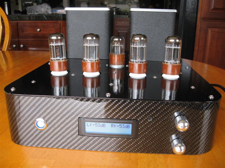

A few pics would be great renron, and a source for the parts you need eg, where would you buy the carbon fibre sheet and what type would you need. Are they available at an online seller that will ship international? What kind of glue to use to hold it on, ordinary contact cement?
I am interested because it would be very easy for me to make a chassis from say plywood and coat the outside in CF to make a very good looking component but really quickly and easily.
Would be a great bonus.

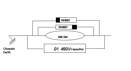

The ground lift is a 20R 5W (5W is overkill, but it's what I had) with 2 1N4007 diodes each facing opposite directions, with a bypass cap of .01 450V film. Diodes were robbed from donor motherboards in my parts bucket. Some are from Computers others from DVD players, others from Satelite receivers (Dish Network converter box). I keep lots of old junker boards around to scrounge from. Recycling at it's finest!🙄 Here's a drawing of the lift.
Ron

Great! Thanks for the Diagram, I'll modify my Aikido to your config and see if I can reduce hum further. Presently it's barely audible with my ear right in front of the speakers.

Rather than starting a new thread on building with Carbon Fiber I'll just put it in this one. After all it IS my thread, and I'll Hi-Jack it if I want! LOL.
The Carbon Fiber that I used is a Twill, not the standard weave.
I bought it from Dragon Carbon Fiber
It is .018" thick and comes in various sizes. It can be rolled as small as 1" tube, and comes either with adheasive backing or plain. I used the adheasive backed stuff. This is not structural CF, but only a veneer and as such has to have a solid substructure for support. It is as glassy as it looks on thier website. Not cheap, but excellent quality! You could also take your chances on Ebay....

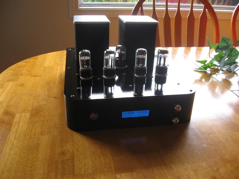

I wanted a curved front on my Preamp because it is different than the standard miter cornered rectangular box most build. They look great too, but I wanted something different. My Diy speakers are also curved and not square boxes.
I used prebuilt laminated wood corners that were designed for round corner baseboard mouldings. Bought from LOWES. They were 6" tall before I cut them to 3" tall. I then glued both the corners to a 1x4 ripped to the correct width. Next, I cut plexiglas on the tablesaw to the same 3" width about 14" long. I cut it later to the correct length.
Using a dremmel I cut a centered window in the Plexiglas to fit the display. Next, I determined how wide I wanted my Preamp to be and cut the plexiglas to length plus the round corners. Next, I set the table saw blade heigth to the same thickness as the Plexiglas and notched the exterior fronts of the curved peices to inset the Plexiglas flush with the wooden round corners. For stability and aluminum top plate support I ripped a 3/4 x 3/4 hardwood for the top back of the plexiglas. I glued all these components together, then quick sanded the exterior wood/Plexiglas flush to promote adheasion of the Carbon Fiber sheet. I drilled all holes in the Plexiglas prior to appling the Carbon Fiber Veneer. Once the Veneer is applied the holes are cut from front (carefully
) drilling holes with a sharp drill bit then enlarging them with a pointed stone bit in the dremmel. Carbon fiber grinds better than it cuts. It can also be, and should be, filed afterwards to remove all extranious fibers. The protective plastic was left on until completely finished. It was hard not to peak at the Carbon Fiber finish.
If you wanted a longer rounded corner than could be provided by the 6" baseboard a closet rod dowel could be rebbited or notched on both sides. Alternatively, a sheet of ABS heated and wrapped arond a pipe to cool could be used, or a PVC pipe could be ripped. Many ways to skin a cat here.
Once I had the front attached to the sides, I cut a strip of aluminum for the support of the back of the sides. Then I flipped it upside down on a sheet of aluminum and scribed the top. Cut it + 1/16 on the table saw and used a dremmel with a cutfoff wheel to make the round front corners. File and test fit. Used a punch to make the valve holes and then Powder coated the top and back panels. I layed out the components inside to keep the signal wires on one side and the power / TX / Heater wires on the other.
That ought to cover it.
