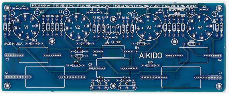

With the R values called out for Bas' PS PCB, the heater bias should be about 1/3 of B+, so it sounds like you are right on at 100V for heater bias and 292V B+.

I would suggest carefully rechecking the value of every single resistor and capacitor in the board, since it is on both channels this suggests an error performed in the assembly process or a power supply issue which is common to both channels.

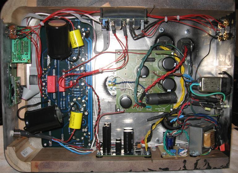

OK, I have not tested this yet but I MAY have found out what I did wrong....
From Mr. Bas' PSU board the B+ (which is D/C) goes to the B+ marked on Broskies Aikido board. So far so good.
Here's where I think I made the mistake. I also took the - (negative) from Mr. Bas' PSU board to the Ground of the Aikido Board....Which is also the ground of the L&R Signal input.
I presume that the ground from the PSU board also carries a D/C current.........um, Yeah. Duh.....

It was a grounding issue from Bas' PSU board to JB's Aikido Board.
I lifted the ground on JB's board and reference Bas' PSU with a 20R to Earth ground and Viola!

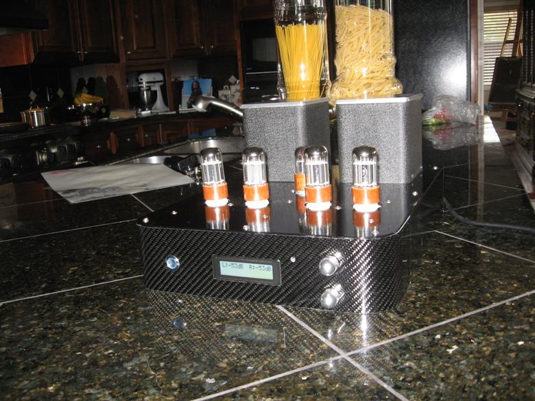

Gratitude, Photos follow.......upskirt with BIG Obbligato oil caps
Ron

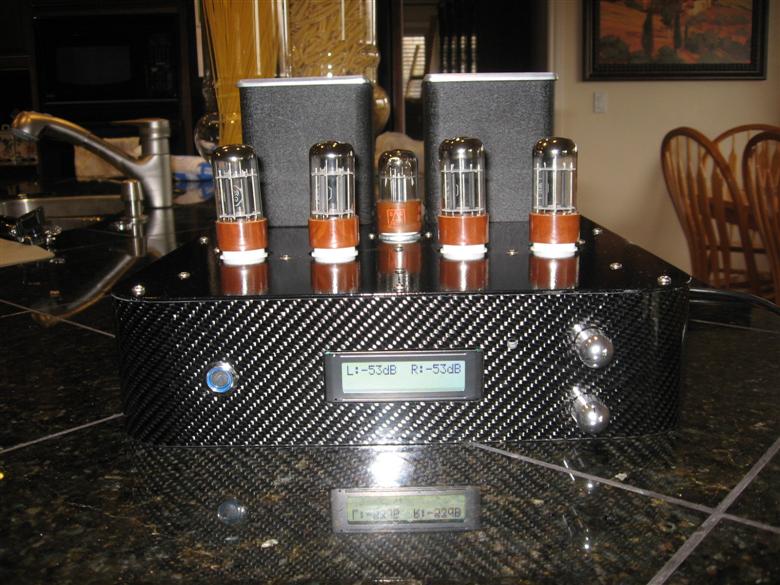

There is absolutely ZERO, HUM or BUZZ. Playing songs through the Curved Thors sounds outstanding. Fullness and detail that boardered on sharp, now sounds Rich, Lush (not the drunk kind of lush) and the presence and spaciality are worth my hard work.
Thanks again to all who helped me.
Ron
