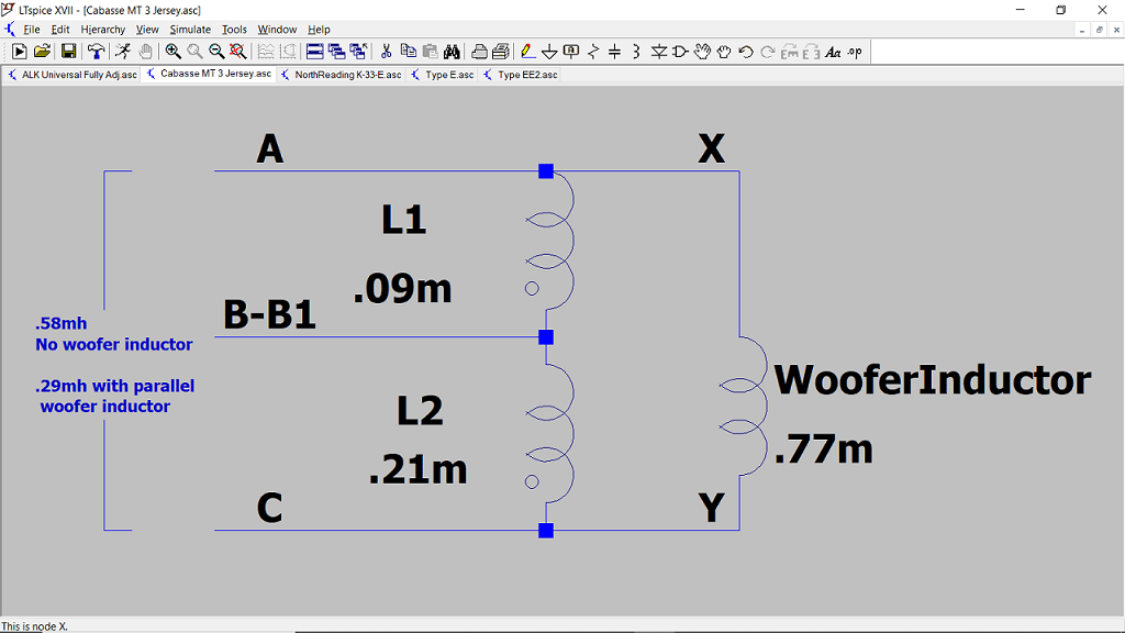

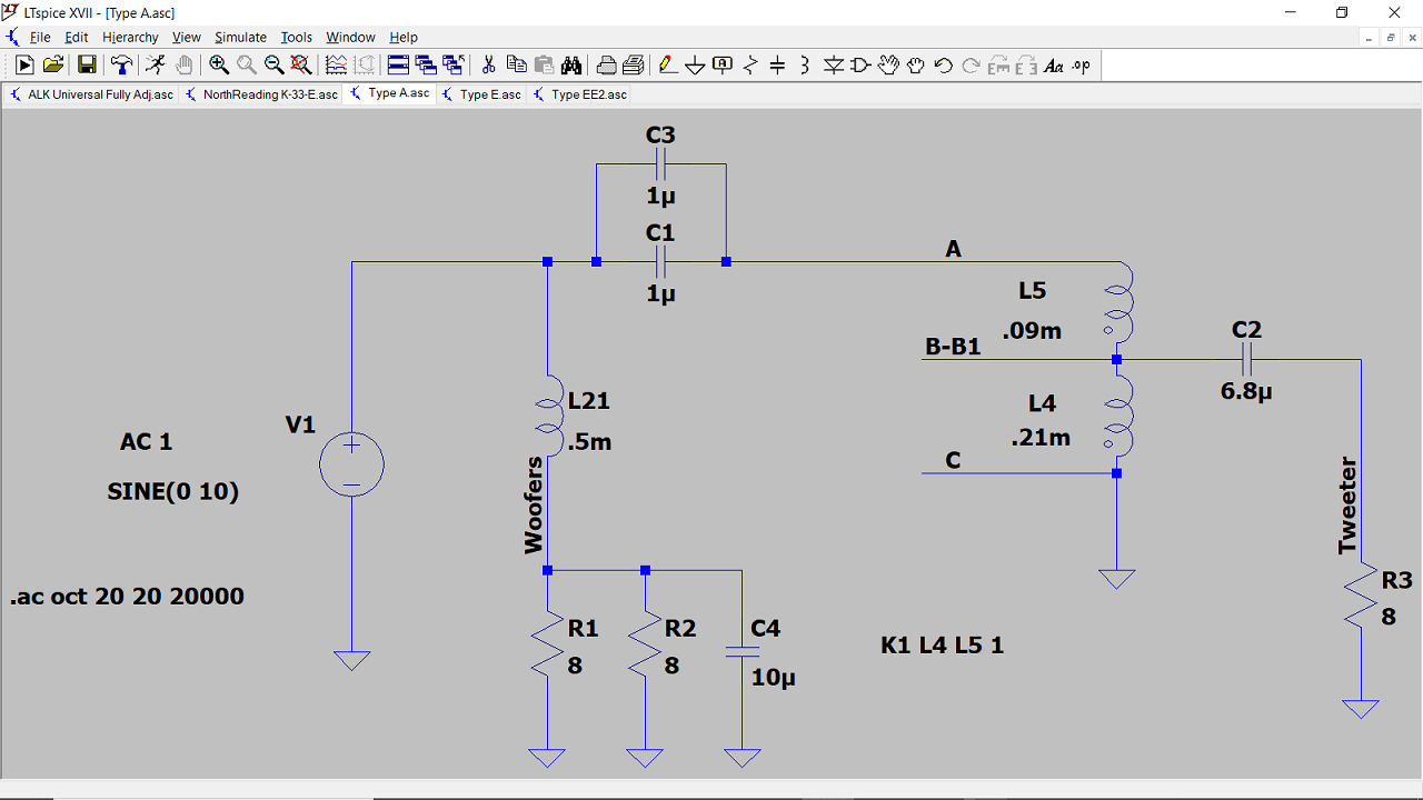

According to these measurements, the inductance between A-B should be around .09mh, or 40% of the total windings. B-C is .211mh, or 60% of the windings. A-C with B and B1 connected is .580mh, or 100% of the windings. I'll assume the driver is connected to B and C, and the input voltage is connected to A and C. The voltage across B-C would be down 4.4db.

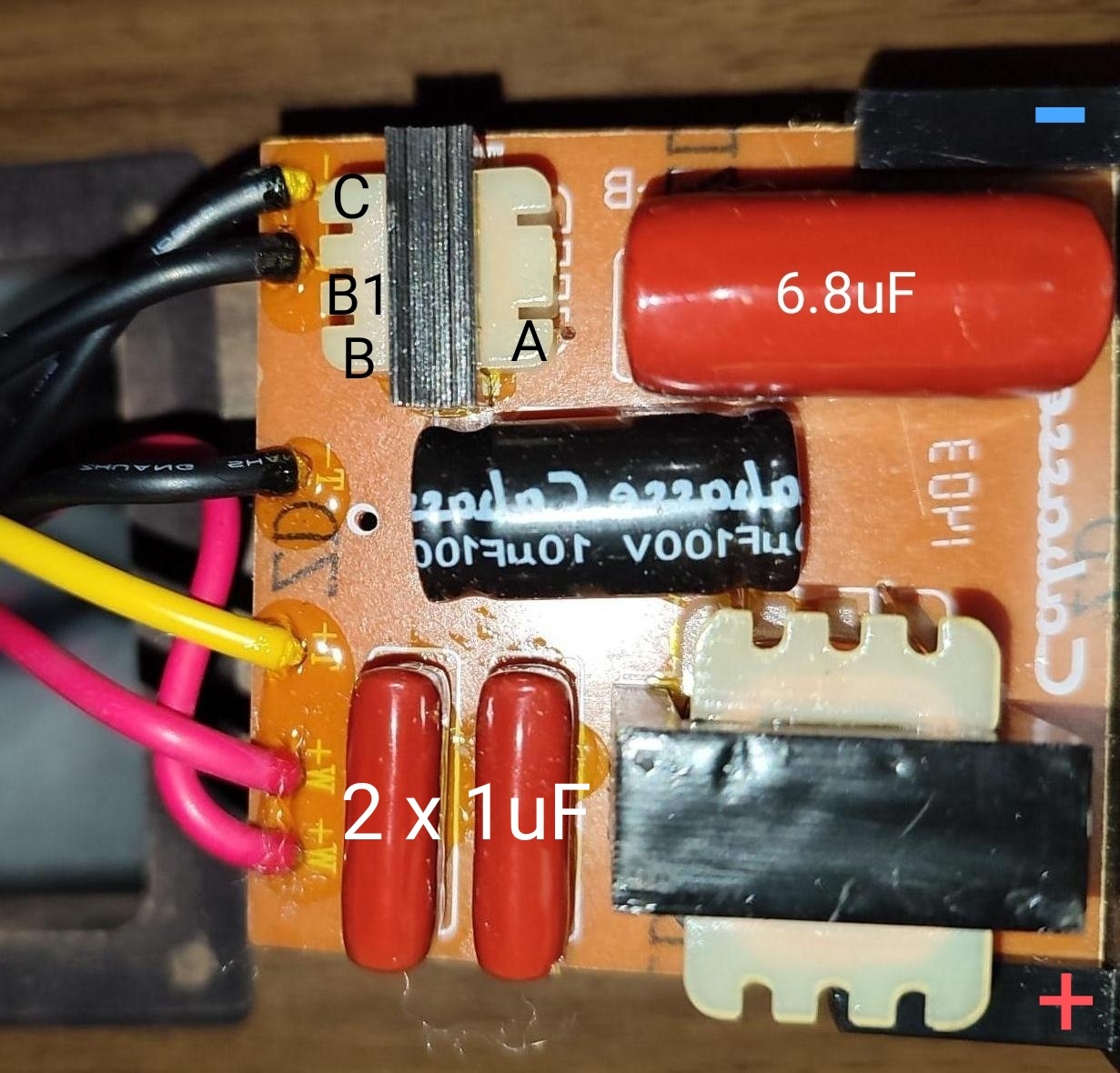

@mboxler There is no continuity between A, B and C on the PCB.
C is the negative on the PCB and this is where the C from the coil is soldered to.
B(and B1) is connected to the 6.8uF cap and from there to the positive of the tweeter.

There are no components to interfere with the measurements. The coil/autotransformer is out of the pcb. The photos of the pcb and crossover are of the other speaker which is in its original state.

Woofer inductance is 0.770
A-X and C-Y (B and B1 shorted), basically a closed loop, is 0.290 mH, 0.2-0.3 ohm.
A-Y is 1.420 mH, 1.4 ohm
Hmmm. A .77mh in parallel with a .58mh should equal .33mh. .29mh is low but close.
Don't understand the 1.42mh measurement. A - Y should be the same as A - C (.29mh)???
Sorry for the wild goose chase. I'm just trying to verify the accuracy of your meter when measuring the autotransformer. Still stumped.
