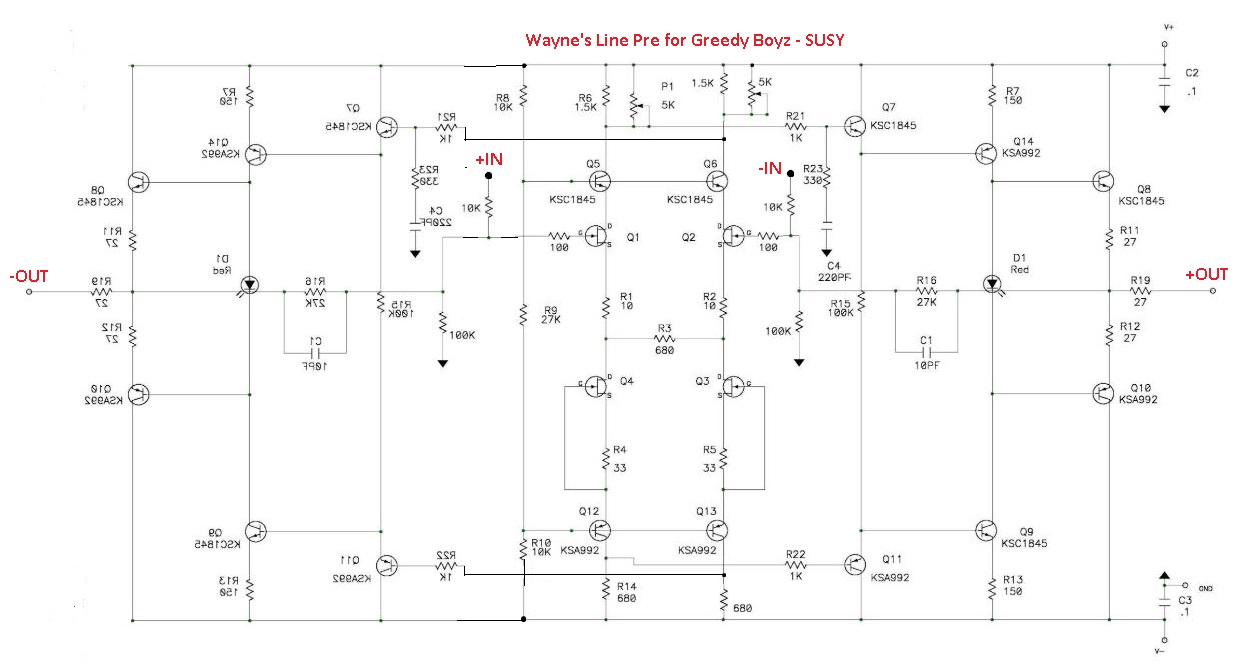

Since this has balanced inputs, is there any easy way to build it with balanced outputs? Without building two of them? I live in a very noisy environment and get terrible hum when using single-ended cables...

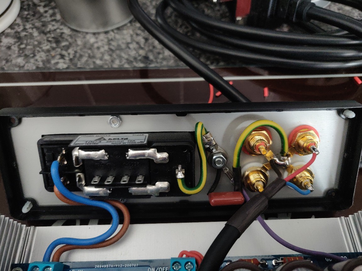

I did my audio ground same as on the whammy and my build is dead silent. 🙂
compact and very clean! (Is this a capacitor at the signal's ground?)
anyway, c'est très cool 🙂

It does look like a cap but I thought the idea was to float the signal ground from chassis ground via a thermistor and/or bridge rectifier. Keep them isolated unless something goes electrically very wrong... Maybe that's only an amplifier thing? I'm interested to know the answer too.

Thank you and yes it's a 0.47uf / 250v cap.
It was done on the whammy as recommended in the build guide so I did it on the Linestage too. Very effective. No hiss, buzz, hums or anything. Crank the volume right up with nothing playing and it's as silent as can be.
here it is, but make it on own risk
no reason it would not work flawlessly right off the bat, but it also could ask for some taming
edit:
you id mention balanced inputs, I did this with original schematic from post #1, where input is strictly SE
can't remember where iteration with Bal input is posted
Do you have a part number or spec for that ? I tried entering the number on the Whammy cap into Digikey and Mouser and got 50 thousand choices.....
