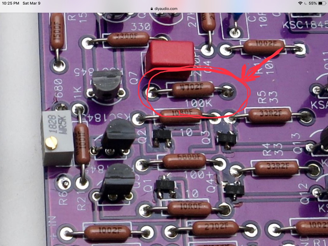

6L6, I have a question about one of your pictures in post #38. The middle picture ( one of the whole apparatus spread out chassis-less) shows a wire, larger dark wire with red shrink wrap on it, on end nearest the circuit board going underneath the green alligator clip on board closest to camera. It appears to attach onto the ground of that board. The other end of this wire goes past your volume control board and disappears off picture.
What is this wire? Its going to power amp, right?

Changes current flow through that stage. With the small outputs a bit more might work better. With the big outputs I've got it at schematic value.
