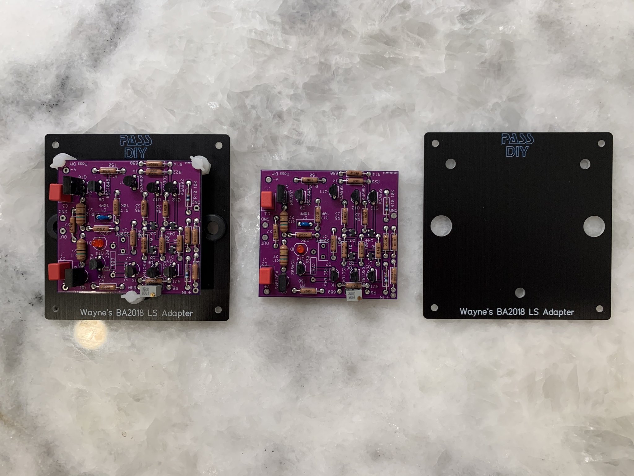

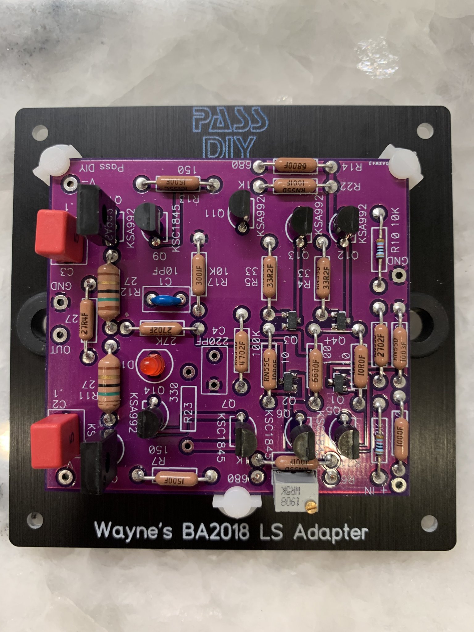

If you don't mind my asking, where did you get this adapter or did you make it yourself? I used these boards to make my LS but never came up with a good way to mount them.@wayne
Thanks for helping me think outside the box 😀…

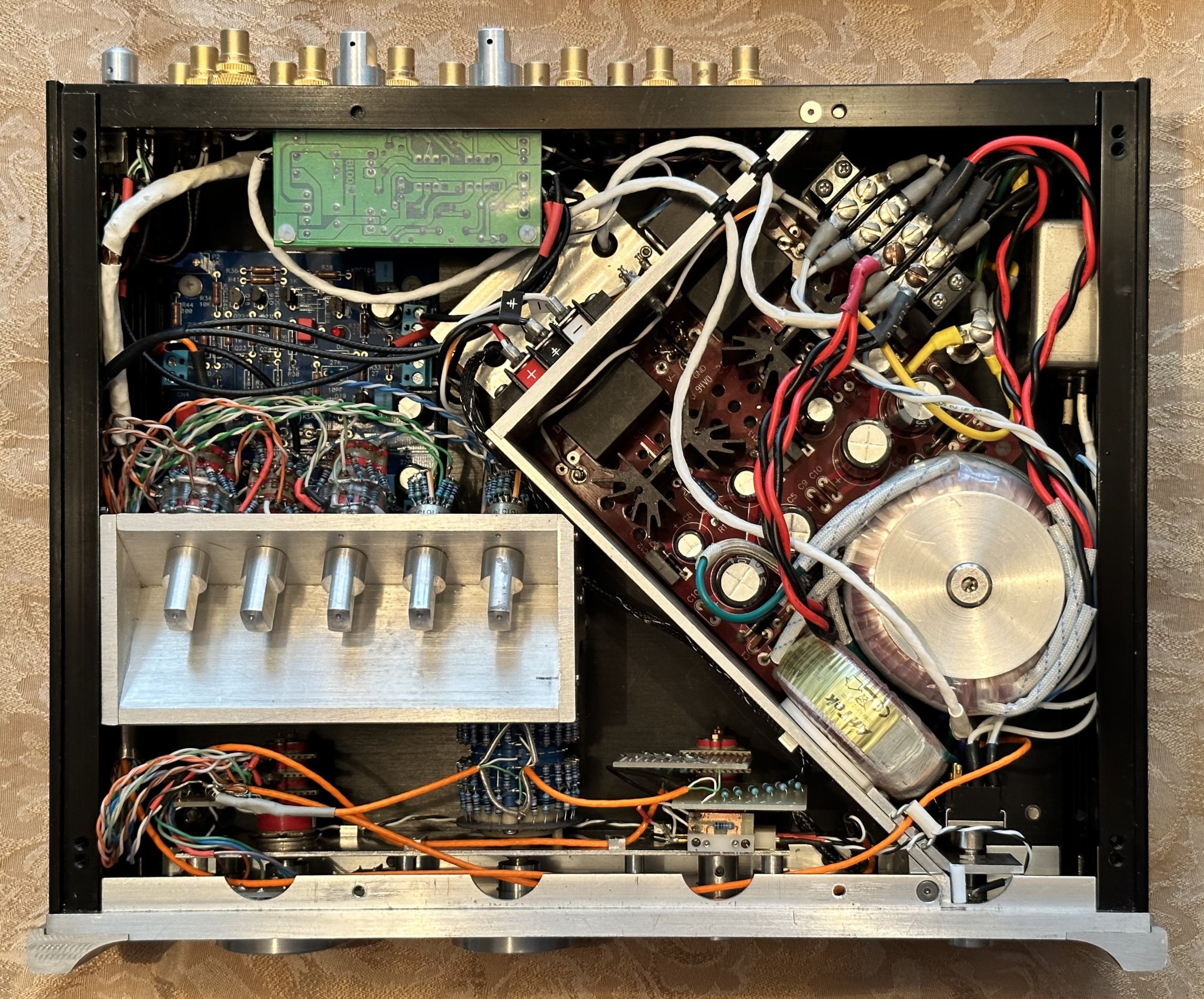

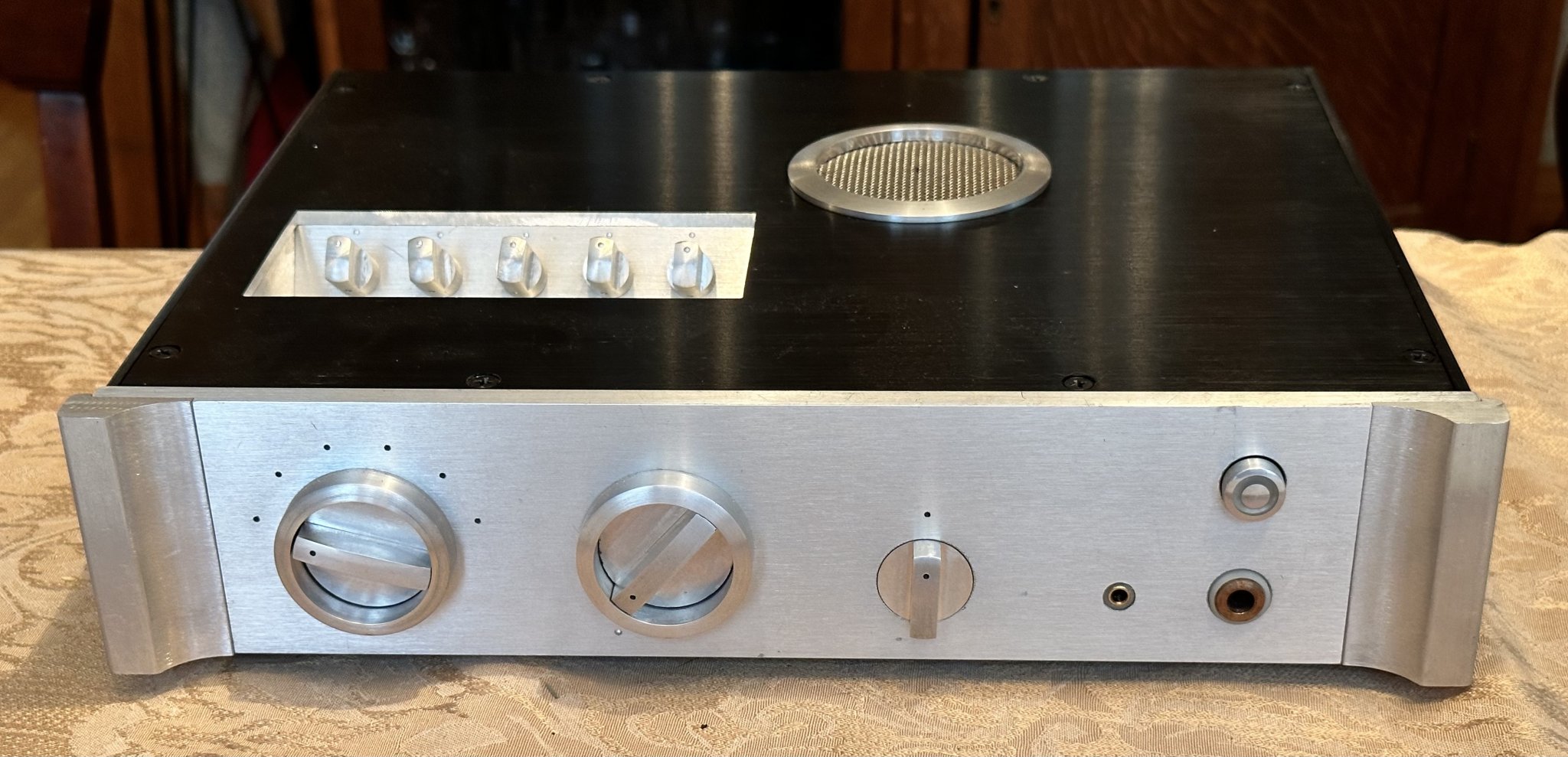

finally got my build all sorted out. Here's some details and a couple of pictures.
Wayne’s 2018 Burning Amp Preamp kit, with Glassware Dual Bipolar 18V PS kit.
Summary/Features:
– Styling somewhat reminiscent of Nagra tape recorders
– Compact size: 31 cm x 24 cm x 6.3 m (12.5" x 9.75" x 2.75")
– Old school, non-digital interface
– Six non-balanced line-level inputs, one of which is mirrored on front panel (mini phone jack)
– Input level adjustors (multi-position/pole switches) on top of box for all but input #6
– Subwoofer crossover with + – 15VAC power supply (on-board regulator)
– Small switcher in shielded box for 5V PS for LED indicators
– Stepped attenuator for volume control
– Minimal balance control (12-position switch)
– Switchable (in/out) effects/processor loop via mini XLR jack
Controls on a preamp are fairly intuitive, but the one design problem for me was how to mark the different inputs. Even if I had wanted to send the front panel out for engraving, you know how those things change over time or even by the room it’s used in. Solution: place a rainbow of colored LEDs at the switch positions. Power all of them minimally, then drop to a lower value resistor when that input is selected for a brighter light. Then, you can place a colored dot on each piece of source hardware, or simpler, just match the color on the switch with the color of the LEDs used on that piece of input hardware. Enabled by 12 position, three pole Grayhill rotary switches I bought for next to nothing years ago: left, right, lights.
Handmade components: end bolsters, all knobs and surrounds, top vent, headphone jack, illuminated power switch.
I just got it sorted out. Tomorrow, will hook up to the Hafler and see what it sounds like.

Thank you. I enjoy the challenge of getting a lot to fit in a small space. Reminds me of all the military and aerospace junk I drooled all over at electronic surplus stores. Wish they weren't about all gone now.Superb and compact work. My congratulation. How did you realised the balance control ? I begin to restore a vintage preamp and it's make no sense to me to replace the volume control with aa expensive step attenuator and left the original balance carbon pot (or replace it with a 5$ one).
I felt I didn't need a full balance control, rather just a little bit to account for speaker placement. Using a two pole 12-position switch, I made little circuit boards to hold resistors. When the switch is turned to the right, the right channel does not pass through any resistors, but the left goes through progressively higher resistor values. Opposite deal when the switch is turned to the left. I took a guess and just picked the lowest six values on the main attenuator, but this does not offer all that much of a decrease in volume of the affected channel, so I'll need to choose different values and replace them.
