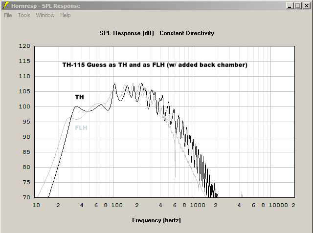

Hi Wayne,
I was not referring to Hoffman's Iron Law, I was trying to see if we could get some parameters set that make a comparison reasonable, maybe:
- same size,
- same driver(s),
- same -3dB (6db?,10db?) low end corner, and
- a minimum of 2 octave range.
That should result in a similar cost factor, and than we have something to compare. For example a long time ago I compared my guess at a Hornresp simulation for the TH-115 (using 15TBX100) w/ the same simulation w/ rear and throat chambers added, and was surprised at how close they were, and in this case the TH was about 80 litres smaller than the FLH. Was it optimized? No. Do I know what the inside of a TH-115 looks like? No. Do I know which one is the better one for XYZ application? No. I also don't sell any loudspeakers (heck, recently I have had neither time nor residual energy to build any 🙂), and thus have no need to promote one technology over another.
I think the tapped horn's biggest strength is what it does at the low end, from cutoff to the frequency where path-length is 1/2 wavelength. That's where the tapped horn is optimized.
I also think that most have used this approach in order to make a small device get deep bass. These small tapped horns are more like tapered pipes than horns, trading efficiency for deep bass. They're very much like mass-loaded quarter-wave pipes.
I see no reason that a larger tapped horn cannot be built that is more in scale with a full-size horn. If, for example, a tapped horn was made having the same path length and same throat to mouth area expansion as a full-size horn, I see no reason it wouldn't be as efficient as the full size horn. I don't know, I haven't studied that.
What I would expect in such a comparson would be that in single units, the tapped horn would be louder from cutoff to (path length equal to) one-half wavelength. At that point, the full horn and the tapped horn would be approximately equal in SPL. Above that, the tapped horn would enter it's peaky response region, where it probably shouldn't be used. The full size horn would be louder above 1/2 wavelength (where it reaches max efficiciency), except of course, for the tapped horn spikes.
What would be interesting would be to see what groups of horns did. The traditional horn benefits from groups - up to the point where mouth size becomes optimum (see the Keele link/reference in my earier post, a page or two back). When grouped, the low end efficiency comes up because the mouth size is made optimal. This brings up the quarter-wave to half-wave region. It also maximizes bulk efficiency, because the system becomes near to the theoretical max efficiency.
My guess is that a (large) tapped horn - one that was as large as a traditional tapped horn - should perform almost the same in groups. I am assuming this hypothetical tapped horn it is optimized the same, not scaled for small size, not made to work at lower frequency - but optimized the same with respect to lower cutoff and size.
I would not expect a smaller tapped horn - one that is optimized for size, with the same cutoff frequency - to be as efficient, even if more are used that match the total (volume) bulk as the larger horns. The optimizations are different. It cannot be expected to get the same efficiency advantage, because it does not have the right flare rate (area expansion) for maximum efficiency, even in groups.
So to me, it really is about size. There is no way to cheat the size thing, where efficiency is concerned. If the tapped horn is made the same size and has the same path length and flare rate, then I would expect efficiency to rise to match the full size horn. There is no size advantage either way. But then we're not talking efficiency, we're talking other charateristics, like distortion and peaks in the band, where they fall. The tapped horn is smoother down low, the full size horn is smoother up high.
