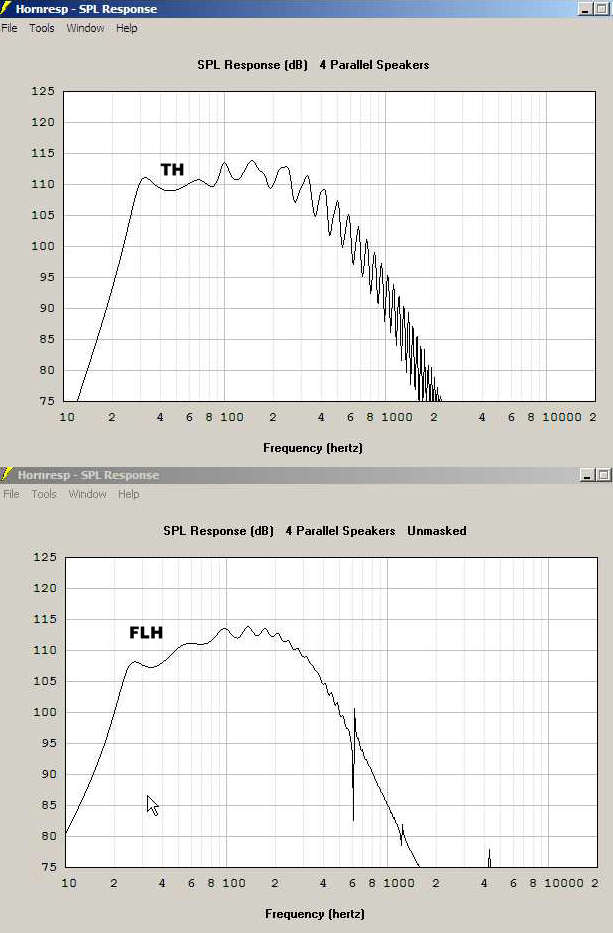

Referring back to Post #179, here are the simulations w/ 4 ea. in parallel, and the TH is still smaller, and still has probably better cooling of the driver:
Not sure what you are saying, exactly. Better cooling than what?

The hypothetical TH probably has better cooling than the hypothetical FLH (see: Posts #179/182).
Post #182 was in response to your Post #180: "...would be interesting would be to see what groups of horns did."
Well, in #179 you have singles, in #182 groups of four.
Post #185: "... horns reduce excursion within the passband, making excursion very small even at high power levels."
In the hypothetical TH and FLH there is very little difference in excursion within the passband. The major difference is the lack of control that is typical for the TH below the passband.

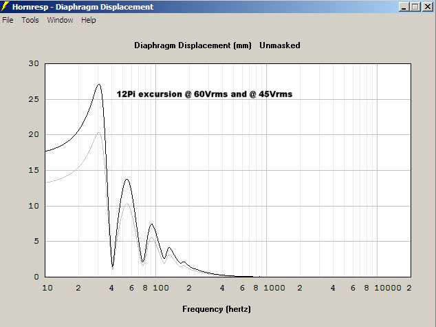

Have you any idea what the excursion is at max power, with and without your cooling plugs?
Without the cooling plug, the maximum is 45vrms, and even at that, the driver will fail after a while. It is pretty vulnerable to heat. If the test frequencies are at places where there is some excursion, the driver will last maybe 1.5 hours. If the test frequencies are anywhere else, the the driver can fail in just a few minutes. A sweep run up through the lower midrange, for example, will kill the driver in short order, sometimes during the sweep.
At 45vrms, the excursion maximum happens around 60Hz, and it is 10mm. It falls below that, but then rises again as the frequency drops through cutoff, below the passband. Excursion through most of the frequency range is under 5mm, at some points under 2mm. Those are places where the driver is most vulnerable to thermal failure.
When the cooling plug is installed, the maximum voltage rises to 60vrms+. The driver will not fail even when run at this level indefinitely, even at places where excursion is at its minimum. As above, the excursion is below 5mm through most of the passband, and under 2mm at some points. At 60Hz, the excursion maximum, it just kisses xmax at 13mm. As before, it falls as frequency drops below that and rises again as the frequency drops through cutoff.

As to the excursions, Hornresp-which doesn't take into consideration losses or power compression-gives a pretty good picture of the drivers' excursion, so maybe we can go with that. There just isn't a big difference between properly designed TH and FLH in the passband. As to heating, there has to be very considerable voice coil heating at the impedance minima in addition to the inductive heating of the magnet structure, e.g.: @ about 40Hz the impedance drops below 2.3 Ohm for the 12Pi in Hornresp; @ 60Vrms that will not bode well for the drivers' survival when using constant frequency sine waves. The Hornresp excursion plots also indicate a definite need for low cut filtering (even with music).

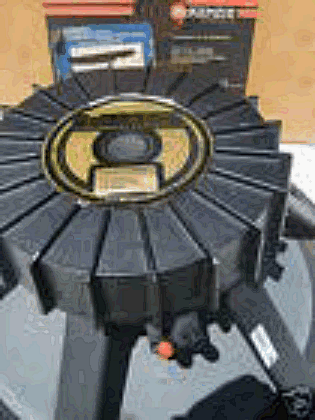

McKenzie Heatsinks
I've managed to grab a photo of a heatsinked McKenzie driver to show how they looked. Not the sharpest picture, but i'm sure you get the idea 😉
Remember these were first introduced way back in the late 1970's early 1980's by McKenzie, so ahead of their time 🙂 Not many people "appear" to have realised the significance of this, at the time 🙁 Ah well it's only taken about 20 -30 years for "some" others to catch up 😉
