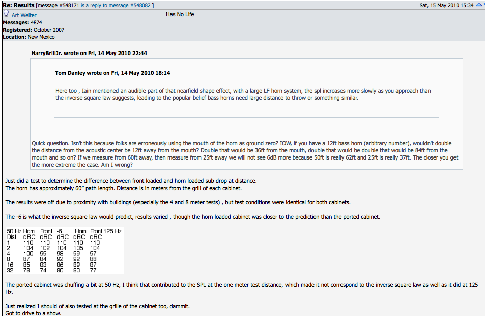

So my understanding is you believe the position where sound begins to falloff inversely to the distance is just outside the mouth?
That's your answer? That's what you're saying?
No matter what the flare rate, mouth size or internal path length, no matter what the frequency, you believe the place where inverse pressure attenuation begins is at the mouth.

Wayne,
With no quotes I'm not sure who you are responding to, but I agree with what revboden wrote:
“The inverse square loss starts just outside the box where the horn's terminus occurs, for 2 Pi space: 1/2 diagonal X 1.33.”
Though it seems the term “inverse distance law” should perhaps replace “inverse square law” 🙄.
Revboden's formula specifies a distance from the mouth, but would not be dependent on flare rate or frequency.

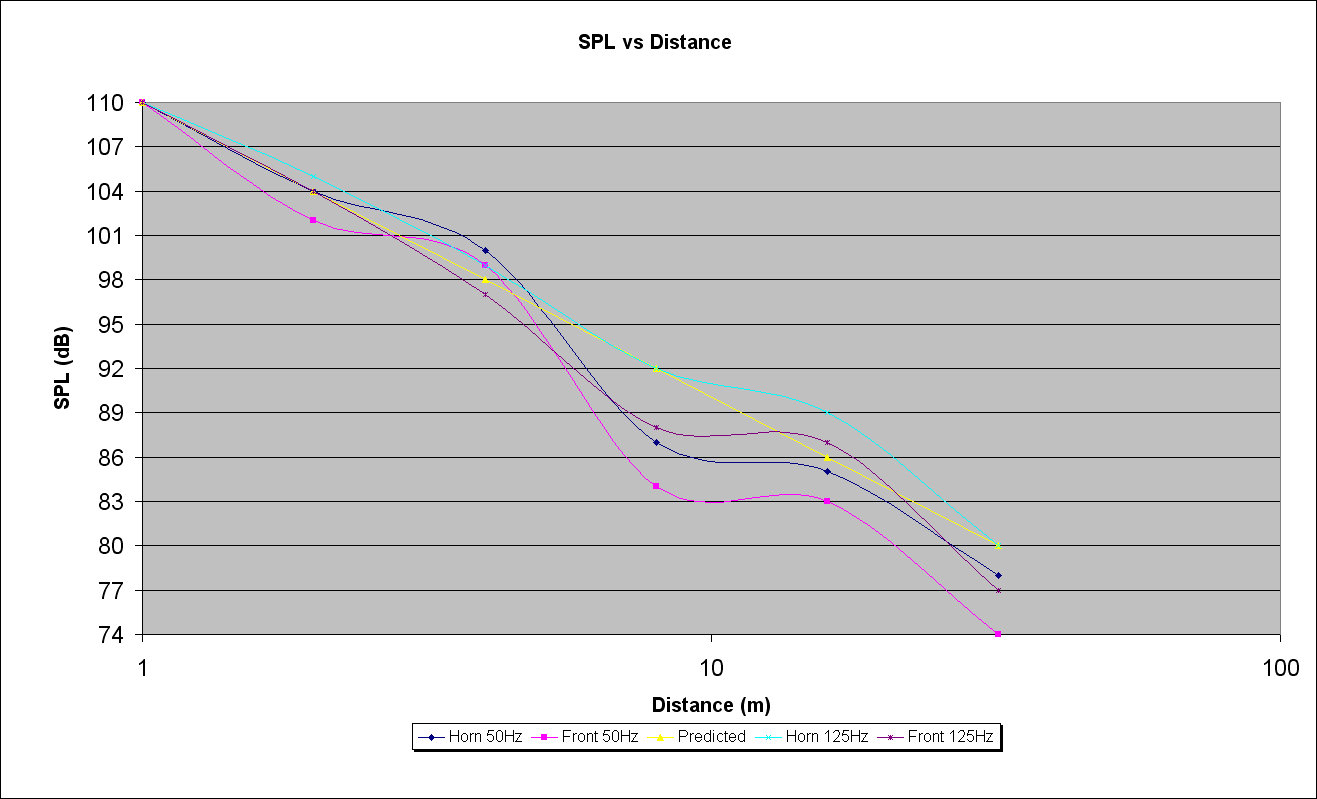

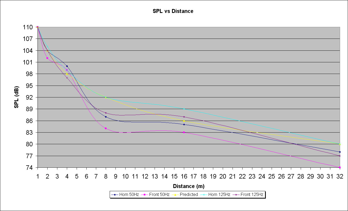

Revboden’s formula matches what I have been measuring in the real world of bass horns (and front loaded cabinets) for the last forty years.
High horns are subject to air attenuation in addition to the inverse distance law.
Everything from the sources revboden quotes in #304 seem to lock in with what I wrote in #299, where I wrote:
If the cabinet radiating area or array size gets to be significant relative to the measurement distance, there will be a deviation from the inverse square law, as the inverse square law assumes a single point source, which no loudspeaker actually is.
That’s what I’m saying 😀.

Phil Lewandowski’s test results, done under good outdoor conditions free of reflective objects, prove without doubt your postulation is incorrect, all his tests are within a dB of the 30.1 dB drop the inverse distance law predicts.
In post #312, you wrote:
“Honestly, I have a very hard time believing that Art measured several cabinets and always found the 1M SPL values to be the same as the 10M values scaled 20 dB. I think what is more likely, is that the 1M values didn't square with his expectations, so he manipulated the drive voltage or the microphone position to make it match. I have said that I thought it was calibration or equipment, but what I actually think is more likely is that he knew his equipment didn't have the accuracy, so he modified the conditions of the test to match what his expected results, in an attempt to make the test seem more accurate.”
My test was done on May 15, 2010, in response to a question raised by Harry Brill Jr. the day before,
with a speculation similar to what you wrote in #216.
I decided to do an actual test since his question had never been answered to my satisfaction in any text book, though the postulation has been bandied about as long as I can remember.
My test readings were in no way manipulated, though they were obviously influenced from 2-8 meters by the locations of buildings.
I did the test in the morning, wrote up the results, posted them, and left for a gig.
The tests were all done starting at 110 dBC at one meter, which required resetting the output level for each cabinet, then moving the dB meter to speaker cutouts (round plywood discs) placed at 1,2,4,8,16,and 32 meters.
That test showed the horn sub dropped 32 dB at 50 Hz and 30 dB at 125 Hz from 1-32 meters.
If you average those two numbers the difference is less than one dB from predicted.
You accused me of manipulating drive voltage or the microphone positions, I challenge you to do the inverse distance test yourself, you will find that the path length of a horn with a mouth size of around one square meter or less does not deviate from the inverse distance law from 1-32 meters.
Repeat the test, put the issue to rest.
Art Welter
At 50Hz one horn by itself is very likely compromised, bringing the acoustic centre forward somewhat, while at 125Hz it will be a lot closer to being un-compromised and pushing the acoustic centre back towards the driver.
If the acoustic centre was further forward at 50Hz, you would expect more total fall off from near to far, because you're going from ~1 metre to ~32 metres, whilst at 125Hz you're going from maybe ~1.5 metres to ~32.5 metres with the same microphone locations. This is consistent with the 2dB difference, and in the right direction, however its probably within the error margin of the measurements.
I think it's helpful to look at graphs rather than raw numbers to see what's really going on and whether the measurements deviate or not, so I took the liberty of putting your measurements into an excel spreadsheet and graphing them, which I've attached as two images.You accused me of manipulating drive voltage or the microphone positions, I challenge you to do the inverse distance test yourself, you will find that the path length of a horn with a mouth size of around one square meter or less does not deviate from the inverse distance law from 1-32 meters.
The yellow line is the predicted theoretical inverse square law fall off. The first graph has a linear distance axis while the second has a logarithmic distance axis, which is convenient because it makes inverse square law fall off a straight line, making it easier to see how the measurements deviate from the predicted response.
There is a huge periodic wiggle in the readings between 2 and 8 metres, presumably from a building reflection. The magnitude of the deviations is far greater than the small difference we're trying to measure which is probably only on the order of 2dB or so. Even at 32 metres the slope of the lines have not converged at the correct inverse square law fall off on 3 of the 4 measurements.
The fact that the horn at 125Hz follows most closely with the predicted response suggests that the directivity of the horn at that frequency is reducing the magnitude of some off axis reflection.
The inescapable conclusion is that there is far too much experimental error in the measurements (probably reflections) to provide any meaningful confirmation or denial of the facts being argued over. I have to agree with Wayne that your measurements in this particular instance don't prove anything one way or the other.
