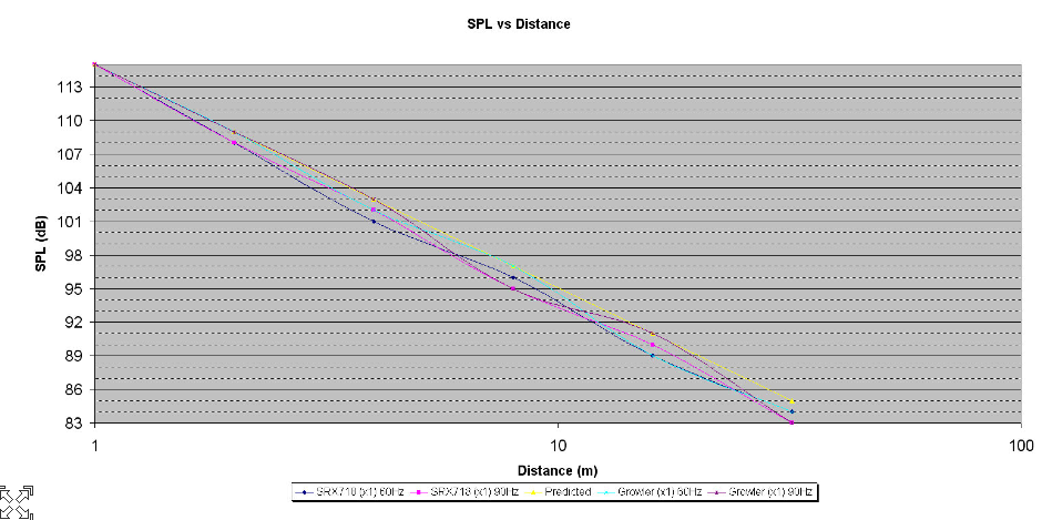

Simon,Ok that does clear up a few things, particularly "Away" vs "Towards", which I had completely misinterpreted.

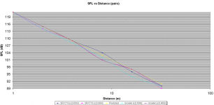

From that I've opted to graph the "Away" figures which were level matched at 1 metre, both for consistency with your measurements, as well as the fact that one of the "towards" measurements is missing. I've also only bothered with a logarithmic scale this time, as I think it's the more useful of the two scales visually.
I've used all the figures as presented with one slight adjustment - although Phil has level matched the JBL and the Growler to 115dB at 1 metre as individual units, according to his description and as is apparent in the figures, the levels have not been matched again after switching to pairs of units.
Since we're looking for any differences in fall off rate between the JBL and Growler with both starting at the same SPL at 1 metre, I've subtracted 1dB from the 60Hz Growler pair figures, and 2dB from the 90Hz Growler pair figures so that they all start at 121dB at 1m.
(As an interesting aside, I assume the fact that the 2x bass reflex cabinets only gain the expected 6dB over one cabinet, whilst the 2x horns gain 7dB and 8dB at 60Hz and 90Hz respectively is because the larger total mouth area is making the combined horn less compromised, thus raising their individual efficiency 🙂 )
So what do we see ? In the first graph there does appear to be a difference in the slope of the fall off between 1 metre and 2 metres, with the JBL showing a steeper line which would suggest that the measurement position was closer to the acoustic centre. (Since the rate of increase of SPL with distance accelerates as you get closer)
I would caution though that since all the figures are rounded to the nearest 1dB and the difference at 2 metres is only 1dB, it's within the experimental error...
The other thing I notice is the wiggles in response from 2 metres onwards which in some cases amount to a 2dB p-p variation. If the measurement was done well away from any buildings this wiggle shouldn't be there, unless there was a ground reflection.
So do we know whether Phil had the microphone on the ground to eliminate the ground reflection, or was it up in the air a bit ? Because the error is +/- 1dB it could again be rounding error, or +/- 1 error from the SPL metre if it only had a 1dB minimum step size. If the SPL metre did report fractional values, it's a shame we don't have those more accurate figures to see if the wiggle is really there or whether its just a +/- 1 digit error. Their periodic wave shape does tend to make me think they are real and caused by a "floor bounce" ground reflection though, especially when the 60Hz and 90Hz peaks and dips occur at different distances.

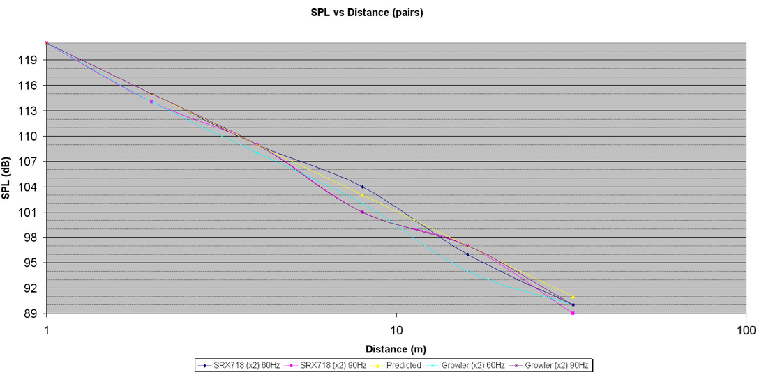

The second graph shows similar but different fluctuations, reaching 3dB p-p in one case. None of the graphs show the correct figure at 32 metres - in most cases the difference between measured and predicted value is 2dB, with the measured figure at 32 metres always being too low.
While interesting, I'm not sure that we can conclude anything from these graphs. While there are differences between the speakers, the magnitude of the difference we're looking for is probably in the order of 2dB or so, yet we only have figures rounded to the nearest dB, along with what looks like a ground reflection.
I'd have to call it inconclusive.

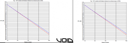

Here is a test made by Rog Mogale. It is the designer of Void products, and a talentuous designer. I know he makes his measurements with LMS. He knows what it says and it does: http://www.voidaudio.com/pdf/lffaq.pdf
Rog is on the freespeakerplans forum (if necessary).

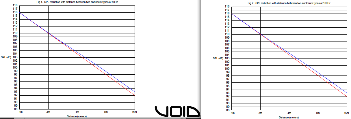

Rog's measurements are primarily concerned with extreme far field. He is examining the effects of directivity at very large distances, not the near field to far field transition. To quote his words, "That is to say that for any given distance beyond near field operating conditions a horn loaded design will exhibit a greater SPL than a reflex design even if both have the same starting SPL." Whether of not one might agree with the concept of "throw", certainly all would agree that directivity has a large influence on the SPL at a distance.
However, this is an entirely different concept than the near-field/far-field transition, which is what we have been talking about in the last dozen pages or so. This is where the position of the acoustic center can make a large difference in scale. There is a large change in the rate of change when you get too close to the speaker, and that's the point.
Rog does not show the expected drooping of SPL increase as the measurement difference enters the near field in his charts. I am not sure if this is because he did not actually measure at one meter or if he did but then disregarded it when plotting his data. I think probably he chose not to include the near-field droop because he wanted to bring attention to the extra SPL at distances, not the reduced SPL at extremely close range.
The SPL curve you'll see when measurements are made up close is best shown in (Syn-Aud_Con) Pat Brown's chart below, from his "Far Field Criteria for Loudspeaker Balloon Data" article:

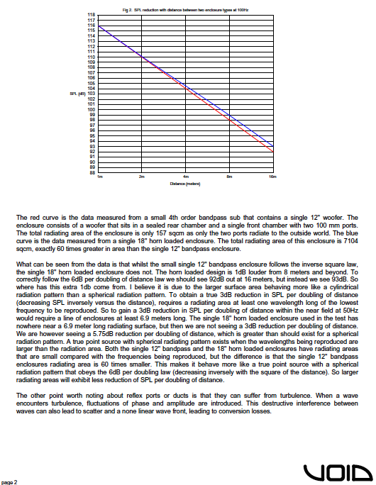

Rog Mogale is very clear in his article on how the measurements were made.
They happen to correspond exactly with the way Phil and I conducted our tests.
Rog writes :
“Fig 1. and 2. show the results of measurements I made with two different LF enclosures
at 50Hz and 100Hz. The test was carried out on a large flat test area that measured 50 x 40 meters. The test areas surface was concrete and there were no boundaries or obstructions within 30 meters of the devices under test. The enclosures and measurement mic were ground located giving half space loading. Both enclosure types were set to produce 116dB at 1 meter at 50Hz and 100Hz, then the measurement mic was moved out to 2m, 4m, 8m and finally 16meters from the enclosure.”

As far as Rog Mogale opinion goes, no need to speculate, I'll simply quote what he wrote:
"What can be seen from the data is that whilst the small single 12" bandpass enclosure follows the inverse square law, the single 18" horn loaded enclosure does not.
The horn loaded design is 1dB louder from 8 meters and beyond.
To correctly follow the 6dB per doubling of distance law we should see 92dB out at 16 meters, but instead we see 93dB. So where has this extra 1db come from. I believe it is due to the larger surface area behaving more like a cylindrical radiation pattern than a spherical radiation pattern. "
The small single 12" bandpass enclosure in his test followed the inverse square law, the single 18" horn loaded enclosure deviated from it by one dB.
Both the bandpass enclosure and the horn loaded cabinet in Rog's test followed the inverse distance law within one dB over a range of 1 to 32 meters.
