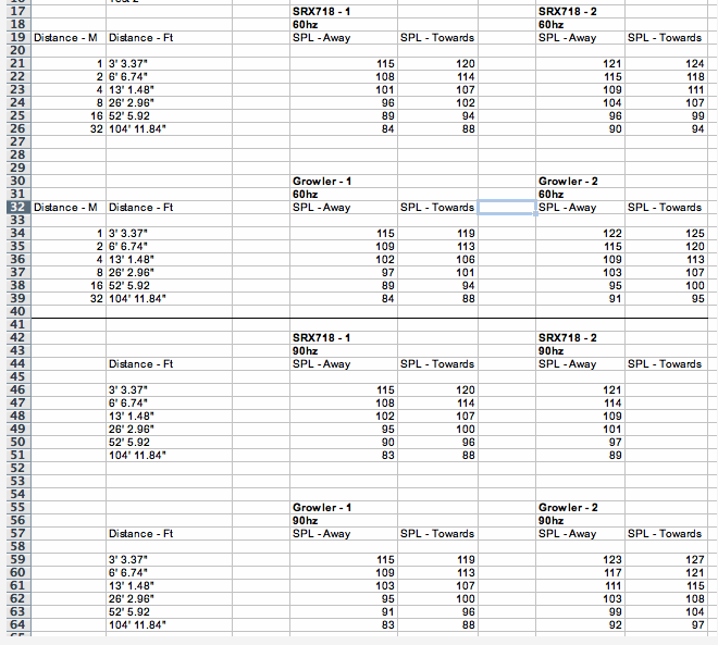

The point of my and Phil’s data presented in post #237 specifically was to test the hypothesis that horn path length makes a difference in the point where the inverse square law starts.
We found that the path length difference made no difference in the rate of fall off, both front loaded and bass horn cabinets conformed to the inverse square law from 1 to 32 meters.
This proves that the path-length/acoustic-center ambiguity makes the distance of measurements irrelevant for accurate comparisons.
Unlike path-length/acoustic-center location, our test results are unambiguous 🙂.
Hmm, how do I put this to you?
First, if the acoustic center were behind the mouth, then the falloff from the mouth would simply continue that trend. But the output one meter from the mouth would be more than one meter from the acoustic center, so the devices you tested with the most distant acoustic centers would be at a disadvantage. Ironically, those would actually be the ones that were probably most efficient.
Second, I hate to bring it up again but I question the validity of your tests. Some of it doesn't pass the sniff test to me, and you yourself even commented that you were unsure of it.
From PSW Sound Reinforcement Forums: LAB Subwoofer => JBL SRX 728 vs. Ported Lab 2x12”
I have attempted to calibrate my Smaart readings, but am not sure if they are absolutly on.
I have not attempted to calibrate them with the RTA 420 microphone I was using in the above test.
I have written several times that I can’t get my 3 meters to agree at more than one frequency.
So my confidence in your data is low. Sorry to say so, but there it is.

I use an inexpensive test microphone (RTA 420) for much of my outdoor testing to save my B&K 4004 from harsh conditions, and I know they have slightly different frequency response. Even the two B&K 4004 have slightly different frequency response, and they are pretty much at the top of the heap as far as test microphones and are in pristine condition.
That said, my comparative Smaart tests of two front loaded subs at two meters, and my honesty questioning the absolute accuracy of my machine calibration has absolutely nothing to do with Phil’s results using a standard dB meter to test the hypothesis that horn path length makes a difference in the point where the inverse square law starts.
The more efficient horn subs showed no near field disadvantage as you hypothesize, all the result numbers are within 1 dB between the different cabinet types.
We found that the path length difference made virtually no difference in the rate of fall off, both front loaded and bass horn cabinets conformed to the inverse square law from 1 to 32 meters.
This proves that the path-length/acoustic-center ambiguity makes the distance of measurements irrelevant for accurate comparisons in single units of the size range of cabinets discussed in this thread.
Any condition that would affect his readings would have affected both types of cabinets equally.
If you find some problem with the methodology of our 1 to 32 meter tests, please point them out.
See, there's the rub. You would have us believe that a Radio Shack meter and other uncalibrated instrumentation proves false the "hypothesis" that horn path length makes a difference in the point where the inverse square law starts. Yet this is basic horn theory. The path length absolutely influences the position of the acoustic center. It is not a hypothesis, it is well accepted fact, described in all the literature.
There are some relatively new papers on improved techniques to accurately measure the acoustic center, but the concept of the acoustic center is nothing new. It is somewhere in the throat, generally close to the apex or diaphragm. In the case of folded horns, that would be a point behind the horn roughly the same distance as the path length to the acoustic center. This is the position from which the sound pressure begins to vary inversely as the distance. There is area expansion from the throat to the mouth, and there is attenuation along the path as a result. This attenuation is SPL varying inversely as the distance, the very feature we're looking for.
So, no, I would not conclude you have proven the well established principle of the acoustic center to be a myth. I also would not conclude that you have proven path length has no influence on the position of the acoustic center.
The brand of dB meter we used is irrelevant, as calibration is completely unnecessary for the comparative tests we performed.See, there's the rub. You would have us believe that a Radio Shack meter and other uncalibrated instrumentation proves false the "hypothesis" that horn path length makes a difference in the point where the inverse square law starts.
The fact that the measurements conform closely to the inverse square law is evidence the dB meter is working properly, but if you find some problem with the methodology of our 1 to 32 meter tests, please point them out.
If the meter was not correct in absolute dB SPL terms, that is it read a dB or two high or low, it would simply read high or low for both subs.
You have no data to prove your hypothesis, and give no valid reason as to why you don’t accept Phil’s results proving that the path length difference made virtually no difference in the rate of fall off, both front loaded and bass horn cabinets conformed to the inverse square law from 1 to 32 meters.
The data proves that the path-length is irrelevant for accurate comparisons in single units of the size range of cabinets discussed in this thread.
Any condition that would affect our readings would have affected both types of cabinets equally.
If you have any actual test data supporting your hypothesis, please post it.

Phil's test did not measure the acoustic center of the cabinet.
The test simply proves that cabinets in the size range of what have been discussed in this thread, with differing acoustic origin distance, with frontal area around one meter or less, when tested in one or two units, conform to the inverse square law as measured from 1 to 32 meters from the cabinet front, not some distance emanating from within the cabinet.
I have read many acoustical texts over the years, perhaps many of the ones you have.
I don’t know of any text that shows results of a similar test, which is why I chose to do it in the first place.
Many individuals that actually make a living designing, selling, operating and providing consultation for professional sound systems were quite interested in the test results.
Some were a bit surprised, others realized the test confirmed what they already knew.
Thus far, other than you, no one has dismissed the test results.
The test is so easy to do, you could have done it 10 times in the time you have spent trying to dismiss it.
I welcome you to try it.
Art Welter
Art Welter

One can easily measure the the point in time at which the signal originates using dual FFT systems like Smaart.
I’m familiar with procedures to follow for time and phase alignment, though I’m not sure how one would measure the the “point in space of the origin of sound” for a horn sub, as it is obvious to me that the acoustic origin and the point at which the sound drop off according to the inverse square law are two different points in space.
The interesting thing about my test is it shows that with differing acoustic origin distance, cabinets with frontal area around one meter or less, when tested in one or two units, conform to the inverse square law as measured from 1 to 32 meters from the cabinet front.
I am sure that the same would be true for a single 12Pi.
If the cabinet radiating area or array size gets to be significant relative to the measurement distance, there will of course be a deviation from the inverse square law, as the inverse square law assumes a single point source, which no loudspeaker actually is.
I can understand your reticence to accept information that seems to be contradictory in some regards to what we know , but I subscribe to the Synaudcon view, measure reality, then figure out which theory applies .
It does not seem to me my measurements have broken any laws of physics, or conflicted with any theories, though for whatever reason, no one seems to have bothered to specifically test what we did.
I’d really like you or anyone else to repeat the test, and see if there are any subs that don’t conform with the inverse square law as measured from 1 to 32 meters from the cabinet front.
Art Welter
