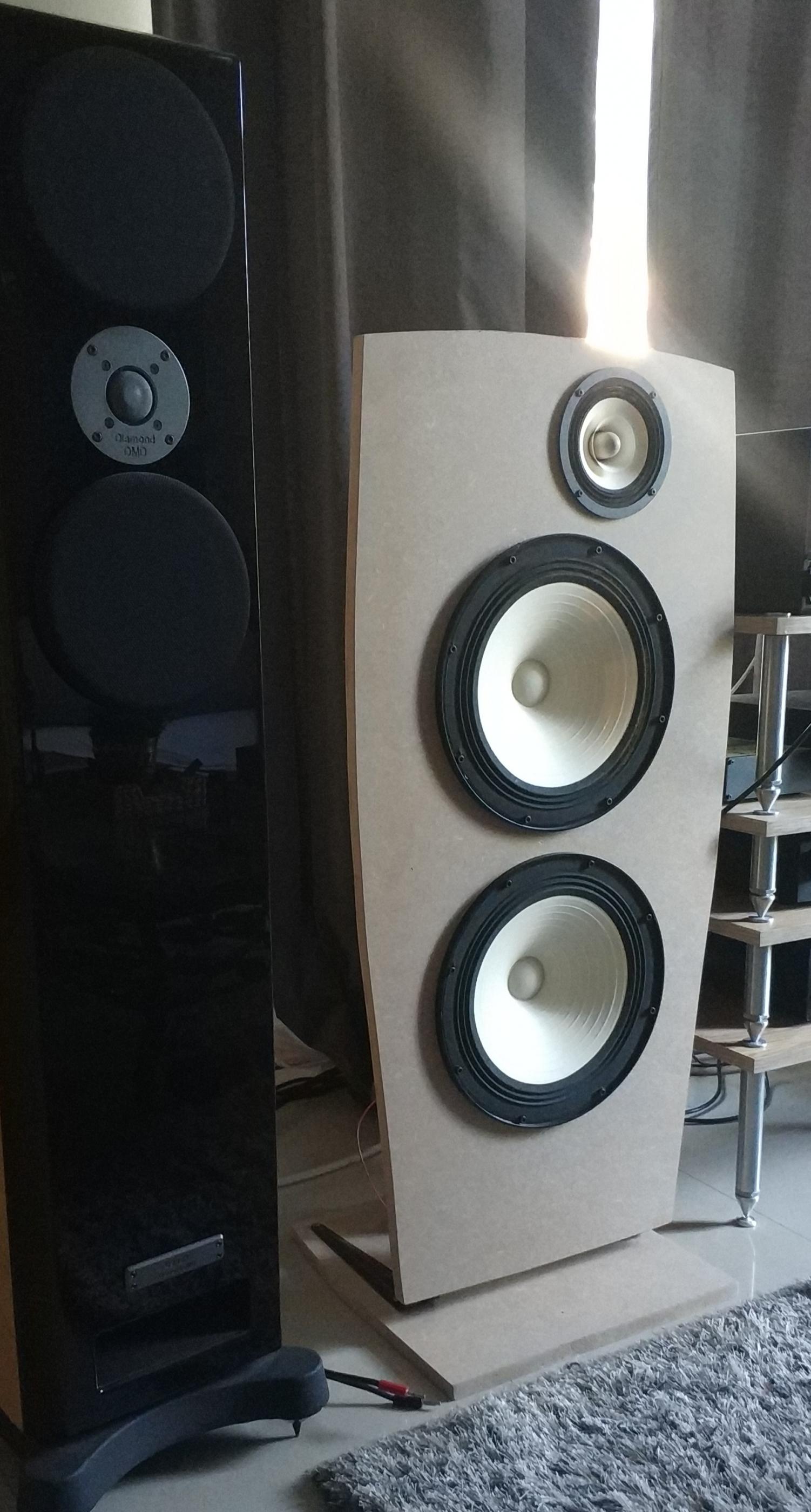

Here's the mock-up. Still haven't bought measurement mic, so no hints on SPL specs yet. So far welded the full range drivers' terminals to some nice van den hull cables and to a set of binding posts. Big woofers arrived with binding posts already, so I'm going just with a cable straight from the amp. Turned them on once, sounded horrible 😀🙄
Went with a digital crossover after all (all digital inputs and outputs - mini DSP nanodigi), trying to find a second power amp now. Put the crossover on 300 Hz, 4th Li-Riley.
As for the baffles, I've tried with shorter ones, angled... It all looked weird. This current version is with perpendicular panels to the floor, where full range driver sits at around ear height (98-99cm).
Any thoughts?

Hi Stefan,
I fear that 4th order will not work nice. You´ll need a filter to equalize the inherent 6dB/oct rise of the woofers, then you´ll need to add the "real" filter to meet the FR drivers.
A simple passive first attempt could be made with a L of, let´s say 6,8mH in series with the woofers and 100uF in parallel. FR´s straight to the amp, but padded down to meet the woofers sensitivity. Don´t play that too loud. Adjust values to taste and listen to some music, before starting your measurement adventures!

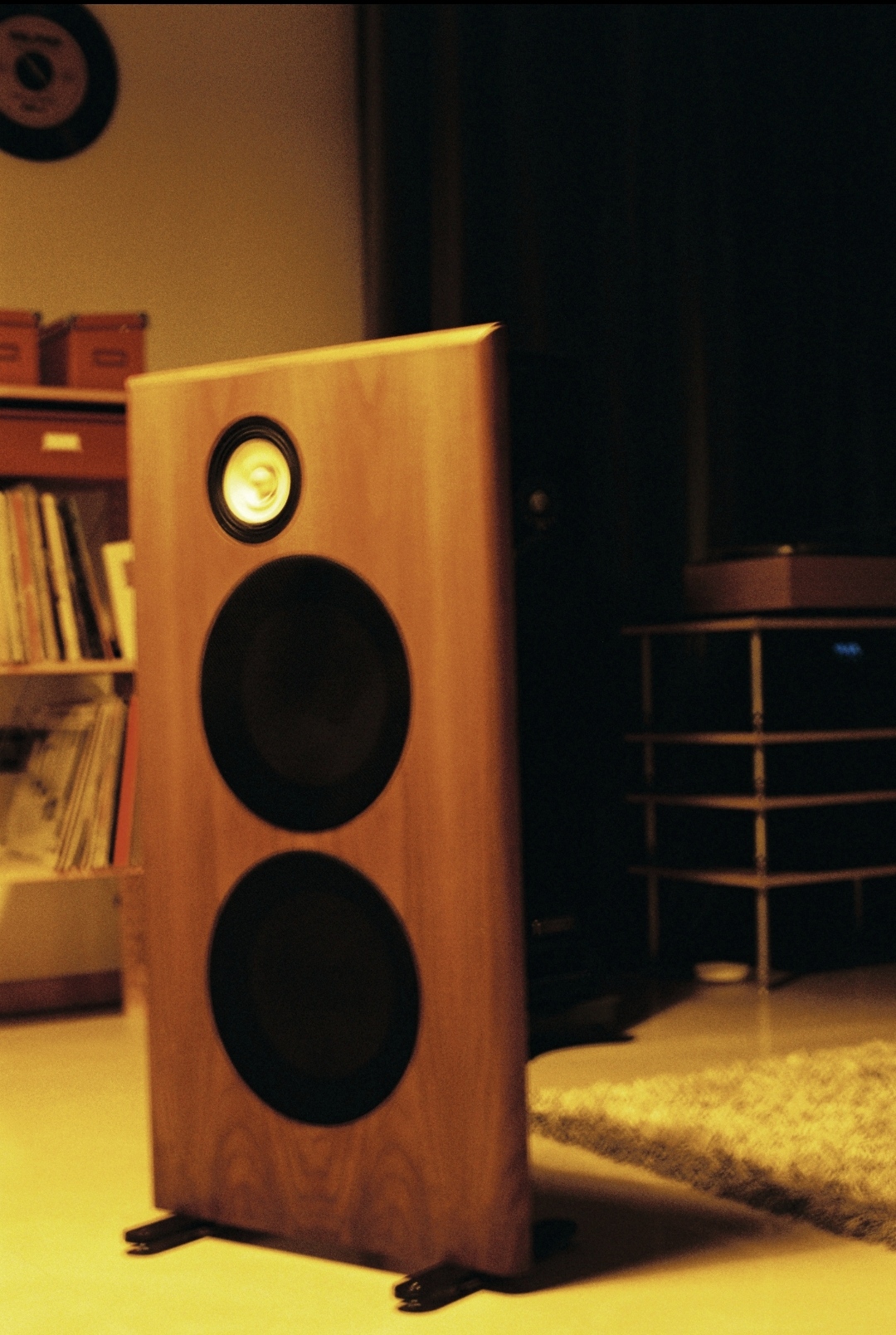

Hello, this will be the final update to this project! I had the speakers made finally.
Cabinets made out of 5 cm (2 inch) MDF with a walnut veneer, 55 cm width, around 110 cm height. Flush front design, mirrored full range driver position, internal cable wiring, rounded edges.
Ended up using two 12 inch woofers and a full range , all made by Sonido in Budapest.
Total expense - 2000 euros, more or less.
Waiting for a good deal on tube amp now to complete the setup. 🙂
Thanks everyone for posting, it really helped a lot!
