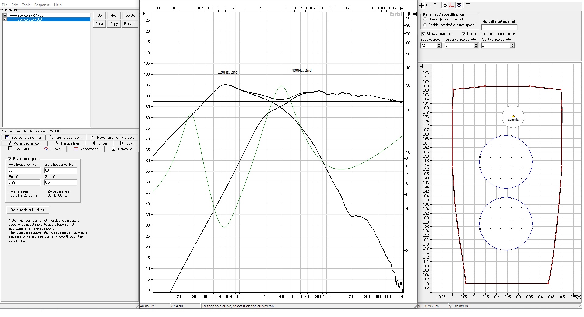

Curious, I used basta for open baffle simulation and got decent results - 65 Hz of bass extension (flat on axis) and something between 55-60 on -3 dB. Are those numbers real? Using one pair of SCW300 with stock specs (95db). I'm not sure how will he raise the efficiency, maybe he will just use a bigger magnet.
I'm using Naim power amp Nap100 (50w per channel) with Naim DAC V1. Recently I put a tube preamp in-between.
I don't intend to throw parties, but occasionally I know to turn it up a bit. Not too much. Room will be eventually bigger - 30-35 m2.
I think you should un-check "room gain" in one of the tabs which never gave me realistic figures (and it´s not supposed to, unless you set it up properly for your room). I believe it is "on" per default.Curious, I used basta for open baffle simulation and got decent results - 65 Hz of bass extension (flat on axis) and something between 55-60 on -3 dB. Are those numbers real?

This is turning into a very expensive endeavour. I left the room gain checked, as per MJK instructions. Without it, I'm kinda limited to 70 Hz (using basta). And that's -3 dB. Not great, not terrible.

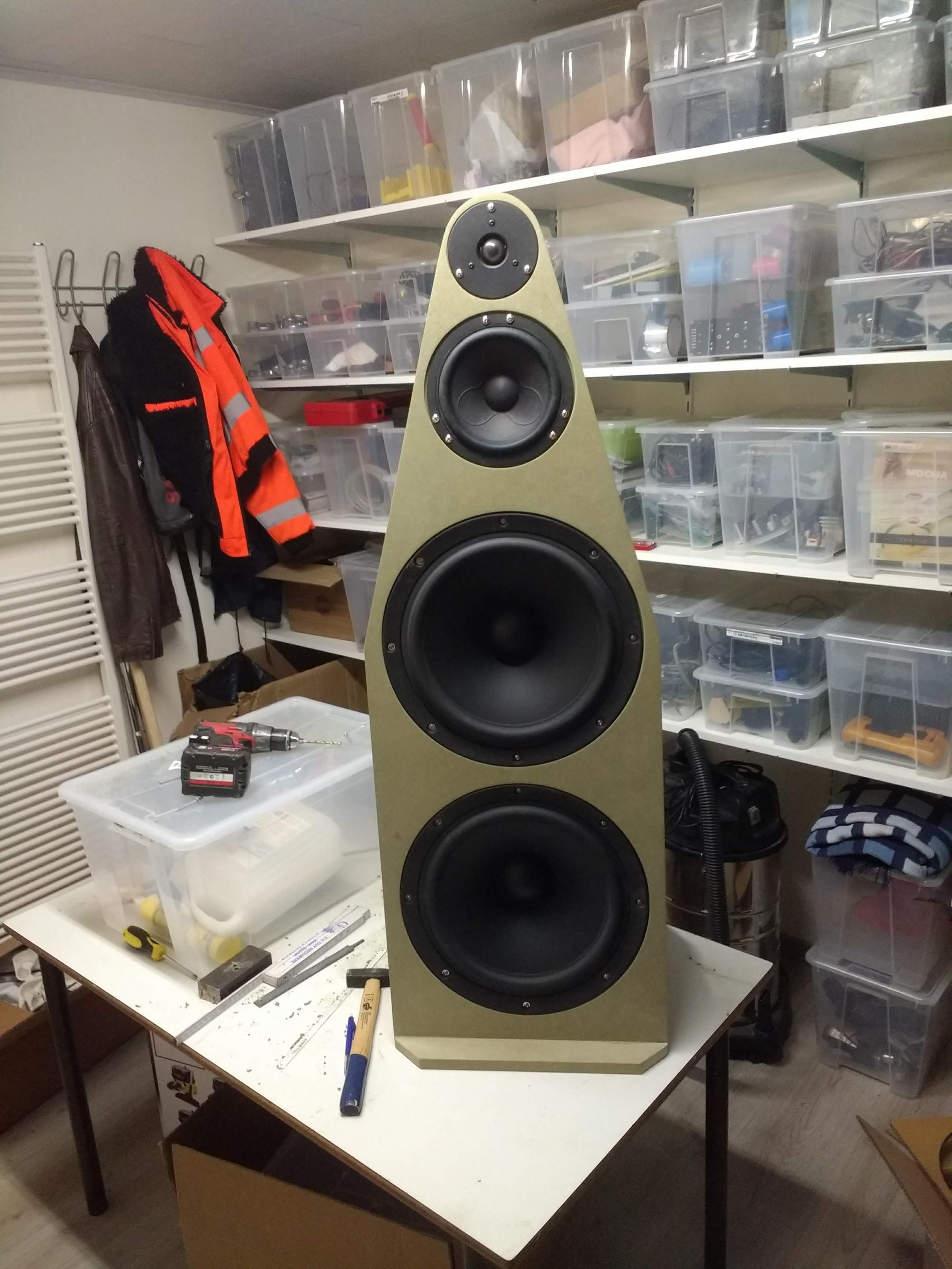

Is it possible to connect two scw300 (8 ohms each) and a full range (8ohms) to the same amp channel?
Nice looking project meanman!

I know, it was a joke. As I have said, any advice is very welcome, and a moneysaver in some way.
This was an original design, simple baffle with no wings. Simulation is made using Basta with two SCW300 drivers and one full range SFR145. Crossovers in this example are at 120 Hz and 400 Hz, both second order. A very mild room gain is applied.
According to the sim, bass extension is around 40 Hz (-3dB) with a slight room gain and 40 Hz (-5 dB) with no room gain. What do you think about this results?
I am going to go with a simple baffle first and see the results. At least until I come up with something for trapezoidal/slanted shaped baffle.
