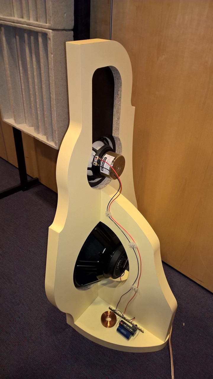

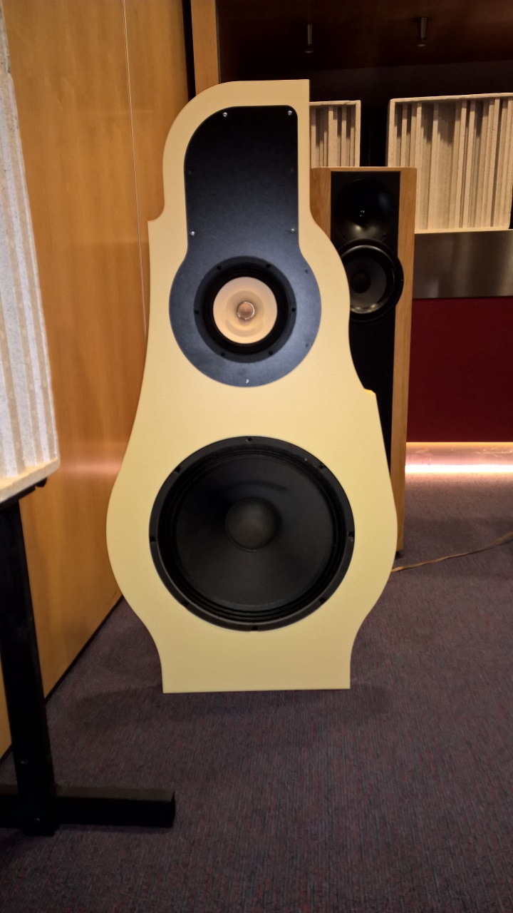

In my experience you have to cut the bass one octave lower than FR at OB. My previous project: Beta15A 12 dB at 180Hz and Sonido SWR175A 12dB at 360Hz.

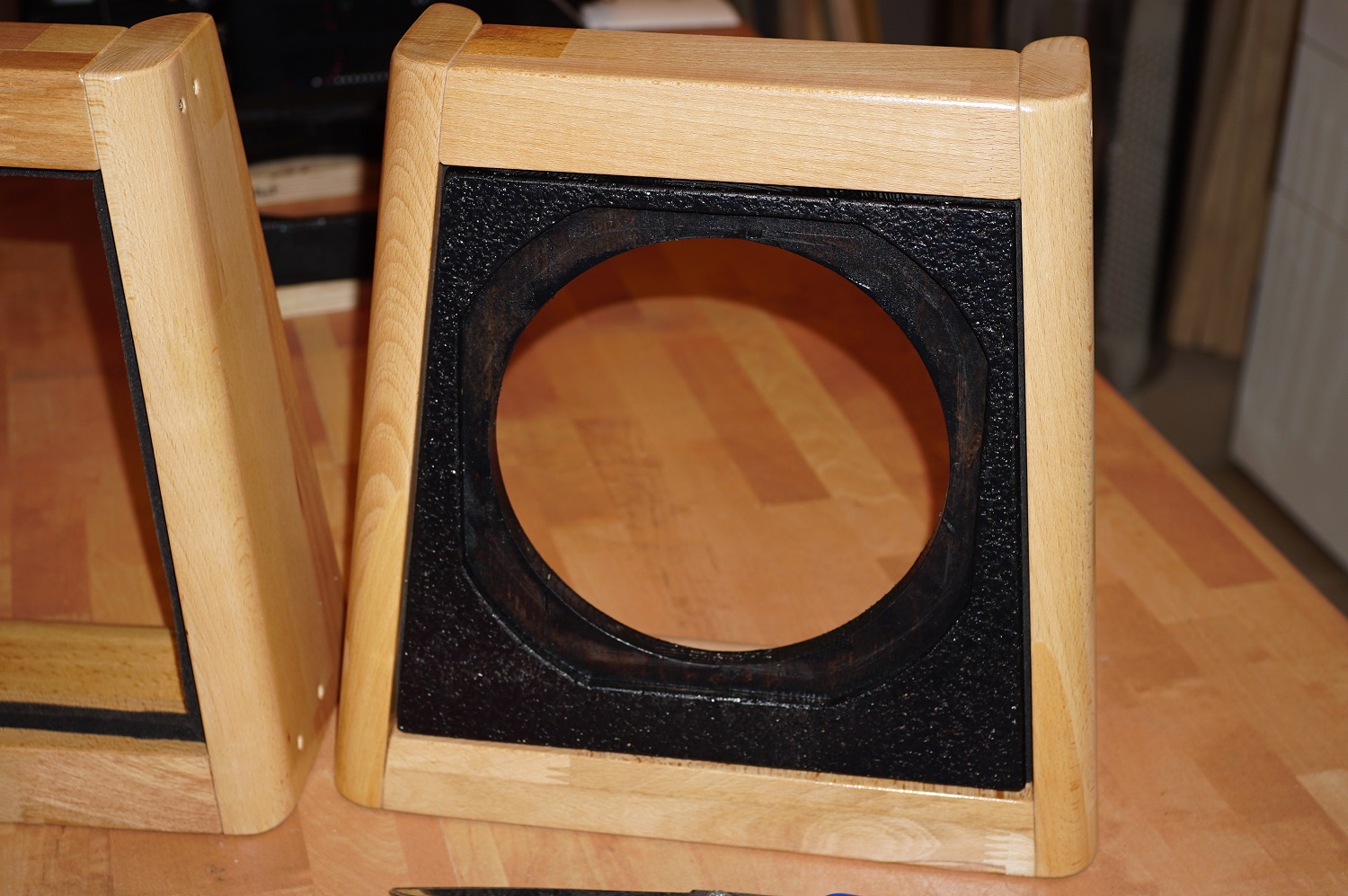

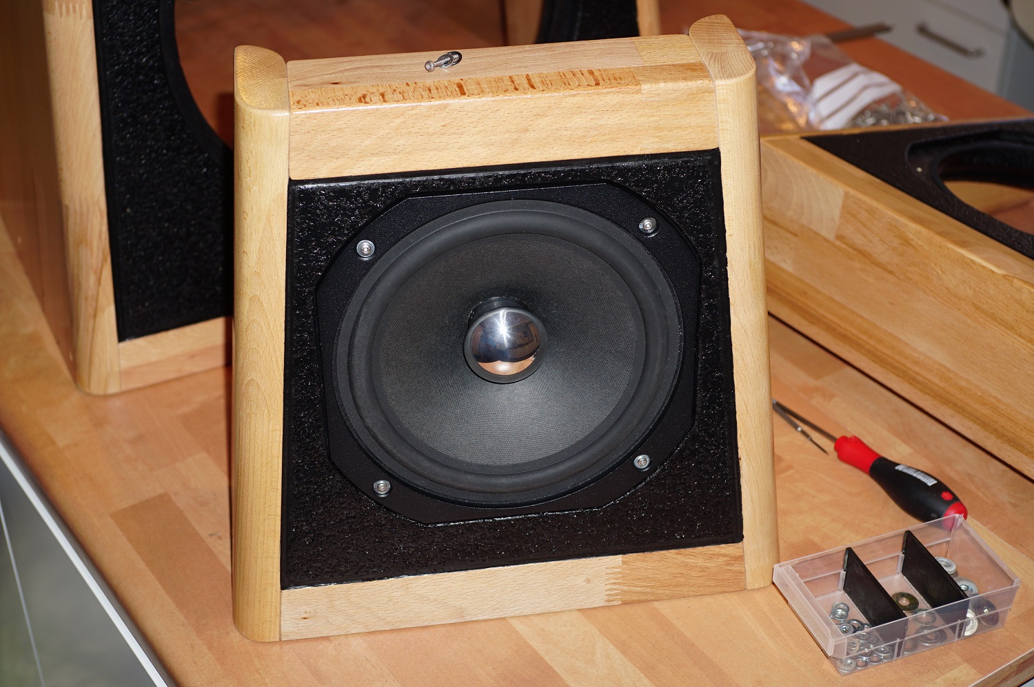

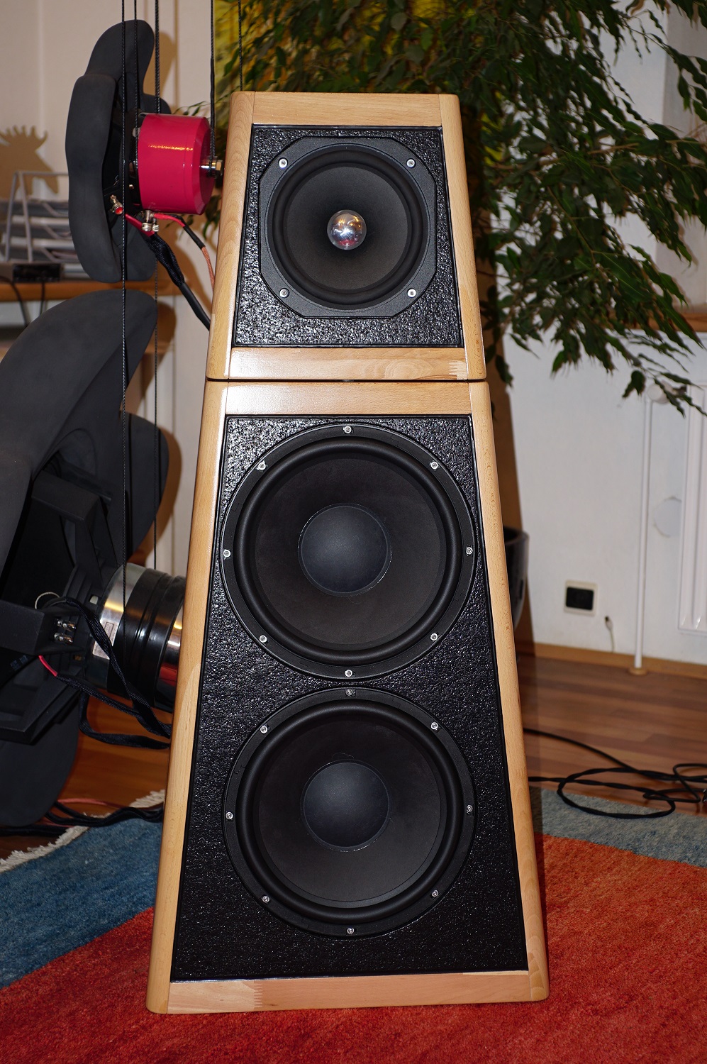

Hi Stefan,
A few thoughts about your ideas:
- Your design will not be a true dipole design, as it will not have figure-8 dispersion above middle range. But that doesn´t matter, it´s nitpicking. The theory behind OB and dipole designs is nicely explained on Rudolf´s pages (dipolplus.de).
- 2 SB34NRX75-16 in a decently sized OB will result in 82dB/2,8V/1m efficiency without room gain, -3dB around 35Hz. Not bad, at 8Ohm nominal, but will need a lot of power to come alive.
- 2 SB12OB150 in a decently sized OB will result in 90dB/2,8V/1m efficiency without room gain, -3dB around 45Hz. Not bad, 4Ohm nominal.
- Hoffmans Iron Law is valid for OBs as well. The lower you aim with a given size of baffle and woofer, the lower will thev resulting efficiency be.
- Don´t mix up realistic numbers as above (AJHorn has proven to be quite correct on OB predictions many times) with phantasy, you can´t cheat physics.
- The semi-passive approach combines the negatives of both techniques. Once you have a passive filter in your system, try to optimize it instead of dsp. Or go with a good dsp solution and prepare for 2 amps. Either way, you´ll need time, decent measurements and your ears to succeed.
- First order passive CO is not phase coherent per se. The final result is what´s important.
- First order does not work with OB bass, as you have a 6dB/oct upwards slope with the bass. A single inductor will at best ease this, but for a defined filter function you need at least 2nd order.
- The FR driver response goes down south of a few hundred Hz, depending on baffle size. With a simple first order HP, the response will actually bounce back upwards at resonance, due to interaction with the C in series. That will result in damage to driver and filter function. You will have to correct the resonance impedance hump with an additional LCR. You will also have to correct the FR drivers inherent rising response and most possibly the breakup area to your taste.
- The PAP style baffle is, in my humble opinion, too large for the FR and too small for the woofers. And the FR fires at your knees and stomach, that makes for a funny 3-D representation...
Now on with a bit more positive thoughts and tips, not wanting to completely disencourage you...:
- As you have opted for the SFR145, have a look at Istvan´s SCW300. Not ideal for OB, but will result in 91dB/2,8V/1m with a -3dB around 50 Hz. Stylewise that´s your only choice... not cheap, and maximum level is a few dB less than the above solutions. Quality should be good and a good match for the 145 for sure.
- Make the FR baffle around 25cm max and aim for around 400Hz XO frequency.
- Make the woofer baffle as large as possible. An interesting idea is to have one woofer work up to 400Hz, the other one to add below 200Hz or so.
- Concentrate on either dsp of good quality (expensive and not easy, but possible) or passive XO of good quality (expensive and not easy, but possible). Don´t compromise good drivers with cheap dsp or wrong implemented XO.
- The baffle requirements for FR and woofer lead more or less automatically to a modular, or slanted, or trapezoidal baffle design. For inspiration, below a 2x12" woofer and 1x8"FR application which works fine. Passive XO.
Sorry if some of the above does not match your expectations... of course these are just my personal thoughts. YMMV, and you´re free to follow your own ideas...
All the best
Mattes
