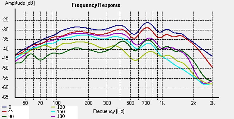

Hi, is there a back panel on the "enclosure"? Its hard to tell from the sketchup image.
Do you think you are getting a raditation pattern somewhere between dipole and cardioid or super-cardioid?
http://www.diyaudio.com/forums/multi-way/211816-waveguie-cardioid-slim-baffle-5.html#post3035949
Post #50 describes the current state of the "enclosure". I decided to go open back and use "driver mufflers" to absorb some of the rear wave. I have trouble getting measurements from 90-160 degrees indoors but from what I was able to get I would say the response is supercardioid.

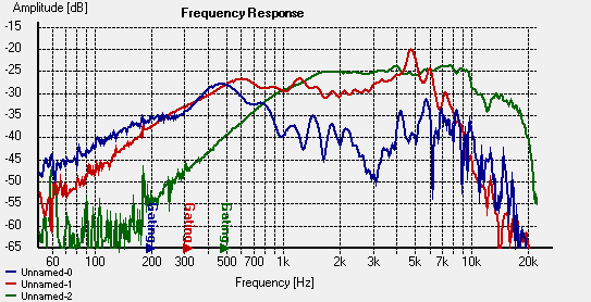

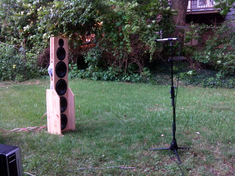

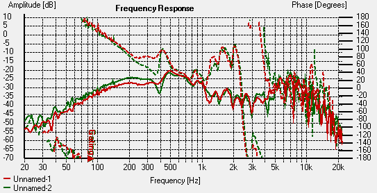

I have some measurements of the speaker outside.
Here are the unequalized drivers on the baffle.
woofer array = blue
midwoofer = red
tweeter = green

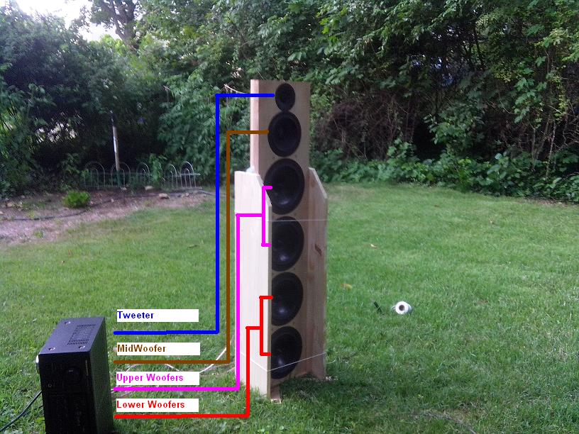

I want to equalize the speaker along the line denoted by -30dB in this graph. The woofer array is at that level around 400Hz and everything below is reduced at rate of 6dB/octave that is characteristic of open baffles. In order to extend down to 50Hz I would need to amplify by 18dB.
While that's doable, I tried it and I did not like the dynamics. I decided to dedicate 2 amplifier channels to the woofer array which will boost their output by 6dB. I'm also experimenting with small side wings which can boost the useful signal by another 3dB.

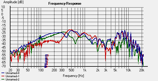

woofer array naked = red
woofer array with small wings = green
Wings introduce a problem however that is visible in the phase plot above. The top woofer pair reaches it's dipole peak as the bottom pair goes into a dipole dip.
woofer array with small wings combined = blue
woofer array with small wings top pair = red
woofer array with small wings bottom pair = green

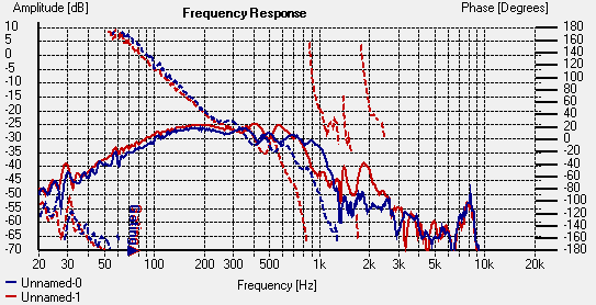

I believe to have solved the problem by equalizing the peak on the bottom pair and thus improving the phase tracking. I took measurements of the equalized response at different distances.
equalized woofer array with small wings @1.5m = red
equalized woofer array with small wings @2m = blue
I think it looks very useful. I'm not sure yet what the woofers-to-mid crossover will be yet. I can probably pull off a 2nd order @ 200Hz or a 4th order at 400Hz. Below is a 180 degrees frequency response of the woofer array.
unequalized woofer array on a naked baffle

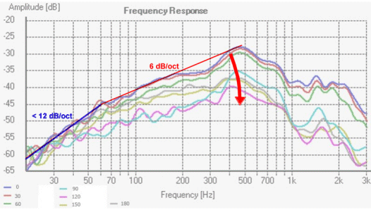

Did you equalise the woofer array by applying some bandpass filters? Your last diagram looks like that.
I've learned from SL and MJK that dipole woofers should be EQed by applying a 6 dB low pass at the point where the 6 dB dipole roll-off starts:
For your woofer array on a naked baffle this point would be 60 Hz.

I should not have put all those different graphs in one post, I'm getting confused looking at it myself. The 2 directivity plots don't belong together because the top one is of a Naked baffle and the bottom one is of an Equalized Baffle with Small Wings. It's a different baffle.
You are correct, the equalization of the Naked baffle should be done with a 6dB/oct low pass.
On the Baffle with the Small Wings the trouble is that the top woofer pair has it's dipole peak at a different frequency than the bottom pair. I equalized the signal by attenuating the dipole peak on each woofer pair individually.
