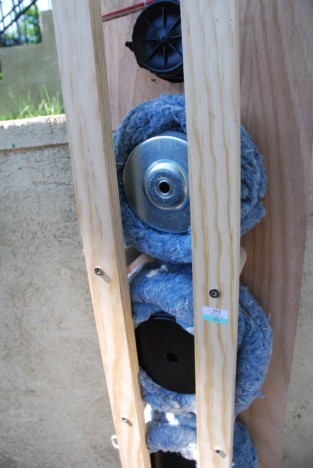

I became inpatient and put together a crude structure. I had some promising results and many setbacks. I finally have a prototype and can begin testing but it's become obvious that I need to rethink many of my original ideas for the enclosure.
Stability is a major concern with such a tall, slim and heavy structure, especially when it's placed on carpet. I have to construct wide feet with spikes and I worry that they might have to spread more than I anticipated.
I realised the way I was planning to support the woofers at the rear was flawed and I need to come up with a different strategy. I was going to use tension bolts that pull the basket but supporting the magnet itself will be more effective. Interestingly, vibration doesn't seem to be an issue at moderate listening levels although I haven't really investigated that area.

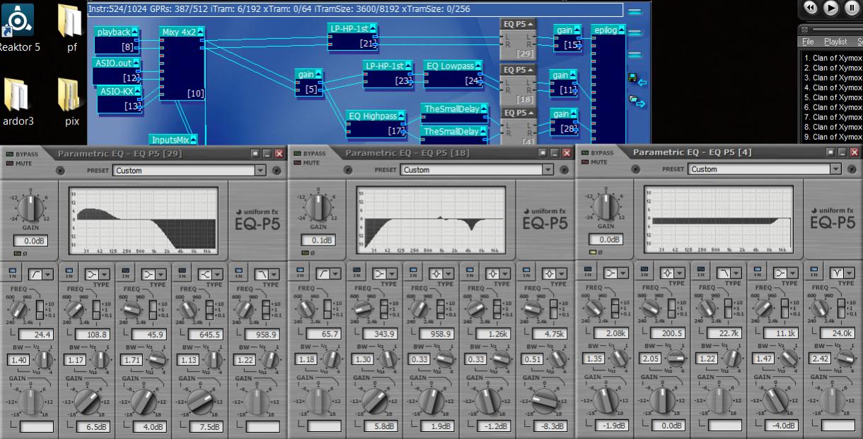

I had a problem with the bass equalization that took me a few days to figure out. It was caused by the kx-Project - my DSP platform. The WaveIn stream had no headroom and applying bass boost filters sounded horrible. That was a strange issue because the ASIO stream, which I usually use is attenuated by 12dB.

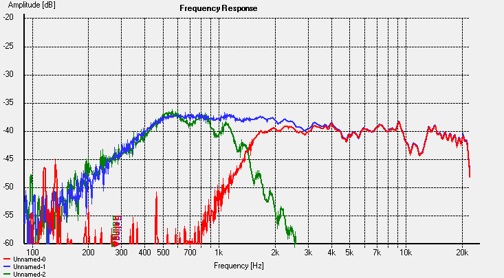

Tweeter and Midwoofer with a quick crossover. These are very crude indoor measurements, I will try to get something better. 0degrees - red, 60 - Blue, 90 - Green, 160 - Gray, 180 - Black.
I focused most of my attention on the TM crossover. This is showing a Le Cleac'h at 1400Hz.

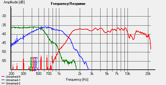

more indoor measurements

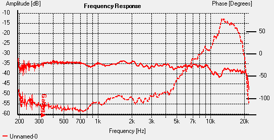

I did some work on the crossover.
The tweeter-to-mid is a Le Cleac'h phase linear 3rd order at 1400Hz. The mid-to-woofers is a bit strange. It's technically 1st order. The mid has no highpass filter but the open baffle naturally drops the response at around 500Hz with a 6dB/oct slope. The same effect acts on the woofers as well and to compensate I put a 1st order lowpass at 125Hz and boosted their level by 12dB. Interestingly, the woofer response drops off very quickly above 500Hz. (I later took care of the woofer bump at 1500Hz)
I did this crossover mainly because I wanted linear phase and I haven't been able to combine 2 Le Cleac'h in the same system yet. I'm not sure if the problem is that there must be some distance between them or I messed up the routing. Although unusual this measures and sounds pretty good.
The resulting phase is very linear throughout the critical 300-3000Hz region. The peak at the top is characteristic of my sound card and hopefully will not be there if I use another platform like miniDSP.

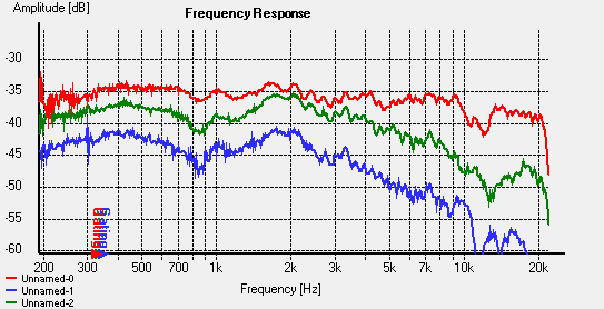

When I was satisfied with the crossover I measured the 0-60-90 degrees. I think they track pretty well aside from the peak at 2000Hz. It's caused by the DXT waveguide no longer working that low. I will try a higher crossover.

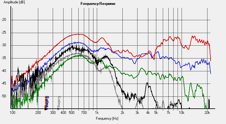

I underestimated the power requirement for the woofers.
The baffle is 10" wide and has the dipole peak at around 500Hz. 250Hz is -6dB, 125Hz is -12dB and 60Hz is -18dB. If I boost the woofers by 20dB I will be putting 100 times more power into them. In other words with my 110W/ch amp I will be lucky to do about 90dB cleanly.
If I crossover to a sub at around 100Hz I might be able to reach 100dB. 🙁
