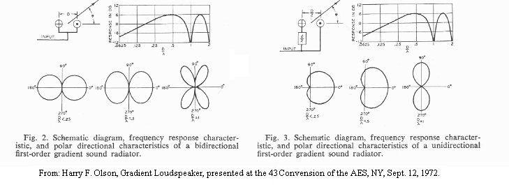

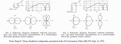

Olsen [1] is often cited in this context, as is Holmes [2]. Holmes is more to the point in this context and likely worth digging into. I have not, yet, so can't tell how specific he gets.
[1] H. F. Olsen, Gradient Loudspeakers, JAES 21, 89, 1973
[2] T. J. Holmes, The "Acoustic Resistance Box" -- A Fresh Look at an Old Principle, JAES 34, 981, 1986

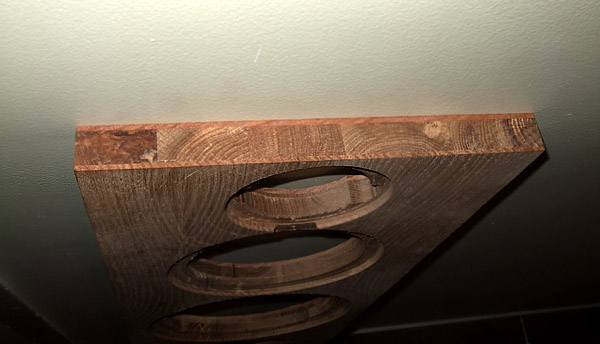

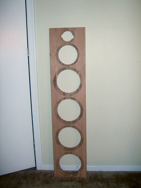

Don't know how much help this will be, but this is the bottom of a 3-way dipole/cardioid/monopole WG from 5-6 years ago. The back of the baffle was a semi-circular piece of 1" wool felt captured by heavy wire mesh inside and out. I used the felt to transition from a dipole (at ~DC), through ~cardioid mids, to ~monopole at the upper XO of around 1.2k.
That's a very good looking speaker Paul! I for one would be very interested in hearing more about it (like what the results were, your tuning experience and if there were particular issues and problems), but I feel like I'm starting to hijack Boris' thread (sorry Boris)..

I don't have a solid grasp on the theory myself. One major point is that cardioid resulting from vents on the sides of the cabinet is not the same as cardioid from a U-frame.

a bit of theory - feel free to make corrections and contribute
The basic concept behind Open Baffle is that there are 2 waves going out in space, one from the front and another from the rear of the driver. They are at equal power but opposite polarity so they will act to cancel each other out. The cancellation is not complete but partial and depends on the wavelength and the distance a wave must travel around the baffle from the driver center at the front to the back. A naked driver with no baffle represents the classic dipole model - no cancellations occur at high frequencies when the wavelength is shorter than the driver cone; as soon as the wavelength grows enough for the driver to begin radiating in >2pi space, the front and rear wave "meet" and we begin to encounter cancellations. The amount of cancellation is proportional to the amount of energy that is able to "wrap around" the baffle and generally follows a -6dB/octave slope. (comb filter nulls will develop in higher frequencies on an open circular baffle but their effect can be minimized with a rectangular baffle)
In a U-Frame configuration the wings of the baffle delay at what wavelength the rear wave can "wrap around" effectively shifting the geometry of the dipole cancellation towards the back. Since the rear radiation is contained in 2pi space for lower in frequency than the front an irregularity in the FR will form at the rear.
On a flat open baffle when the rear wave is partially absorbed the dipole cancellation will be shifted to the rear and form a cardioid-type response as well. But in this case it will be the result of different power at the front and rear contrary to the case of different distances(phase) as it is with a U-Frame cardioid. The rear absorption method will have the advantage of more consistent power response over a U-Frame at the expense of sensitivity.
