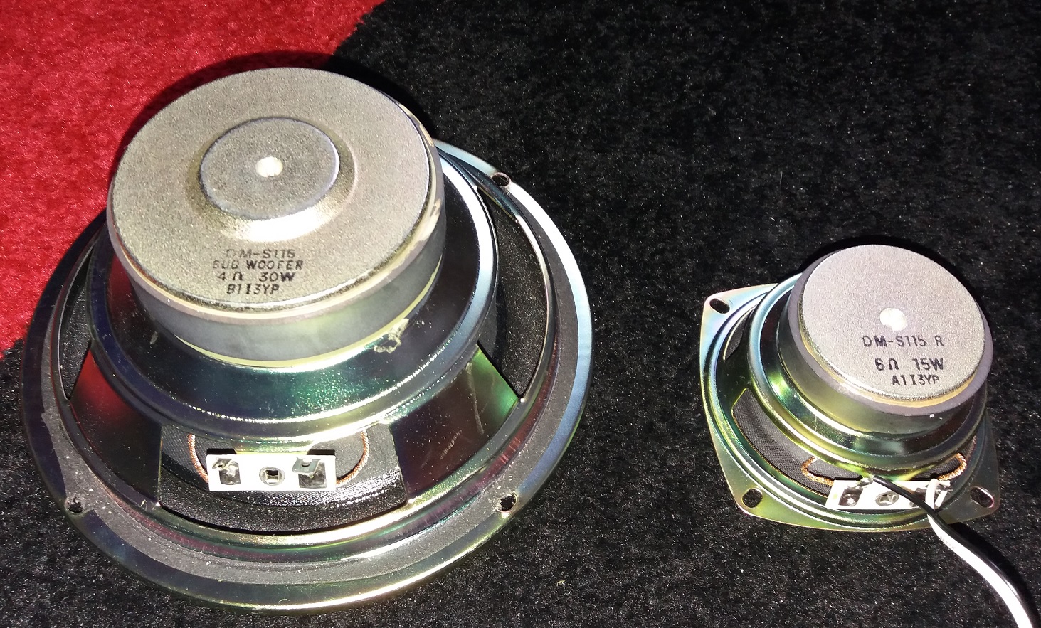

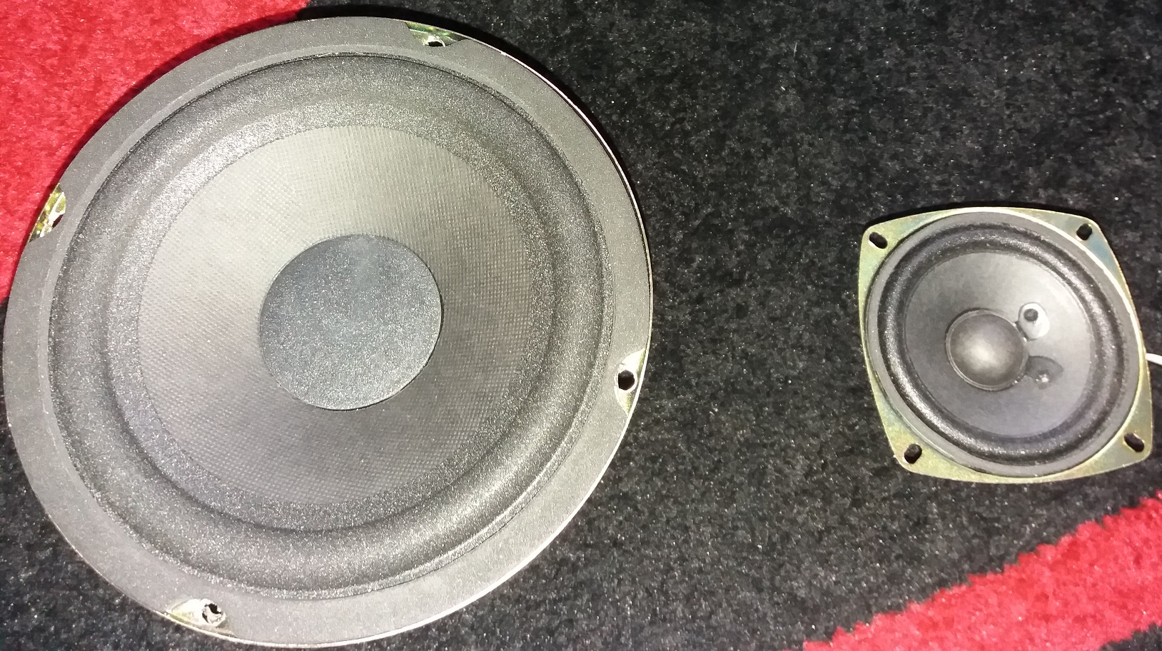

These are the speaker i want to use. The smaller ones seems to be a middle rather than a tweeter, then again i have no clue.
I've attached your images for easier access.
The small speaker is a 'full range' driver which will work OK as a 'tweeter'.
Since it has an open back, the 'tweeter' must be boxed in to protect it from the bass waves of the woofer i.e. the 'tweeter' must be housed in a small box within the main box.
Other than that, you can go ahead with my simple connection plan and see how it goes.

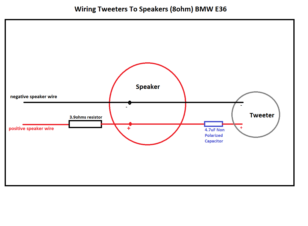

The 4.7uF capacitor IS the crossover. It prevents the electrical bass frequencies from reaching the tweeter.
If that simple solution works well, you won't need a more complex crossover.
I'll get back to explain how you physically wire the components together.
It does not matter. In fact, both the wattages and the impedances are working in our favour!
EDIT: Here's the techie stuff!
The amplifier will basically see a 4 ohm impedance i.e. that of the woofer.
The tweeter is normally of a lower power handling than the woofer since high frequencies carry less power than bass frequencies.
I'm betting the sub woofer will filter out the high frequencies itself without the need for additional electrical filtering.
Try it first with the capacitor alone.
We can improve the crossover arrangements if the simple arrangement turns out to be unsatisfactory.
The key thing in the diy you are undertaking is to experiment. Let's take it stage by stage!
