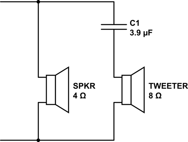

The basic help you need, as I see it, is how to wire the woofer and tweeter together so that the bass notes don't get to the tweeter.
If the tweeter turns out to be too loud, we can deal with that later.
A basic crossover, consisting of a single capacitor in series with the tweeter, would be enough to get the drivers working together safely.
Aa educated guess for the capacitor value would be 4.7uF and this should be a plastic film type as shown here: 4 7 fd Monacor MKP Capacitor
You would wire the woofer, capacitor and tweeter together as shown in the attachment (ignore the values shown in the diagram).

P.S. A more tailored crossover would require knowledge of the full electrical parameters of both your woofer and your tweeter.
As these are unlikely to be forthcoming, the simple circuit above would at least provide a workable solution.
And now the thought strikes me - don't your existing speaker sets already contain the required crossover circuitry?
A 6.5" woofer - I'd be fairly confident that my simple crossover suggestion would give a reasonable result since a small woofer like this will reach high enough in frequency to blend in with the tweeter.
