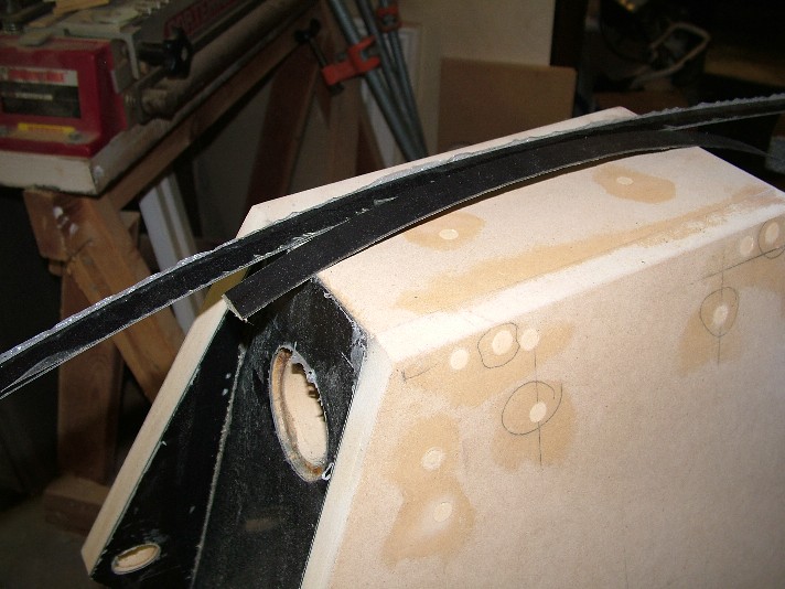

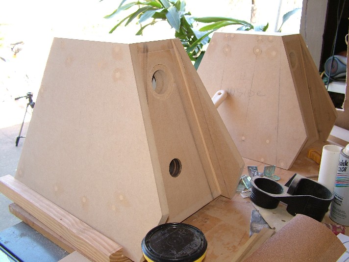

I started my Watt/Puppy clones because I admire the physical appearance of them. The funny thing is that the sound characteristics of them are very close to the originals.

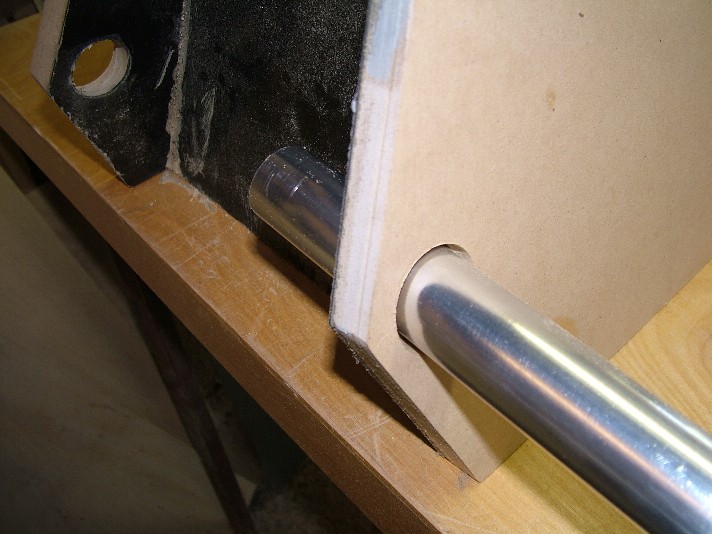

Where can I find detailed drawings and other details of the clones mentioned here. I have trouble making the WATT cabinet because of all the angles etc.

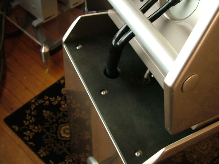

Bfard your picture is interesting, can we have some more and details, please?
How is WATT placed on the Puppy? Is it long spikes or is it leaning on the "wings"?

I am using Rubber foot for my WATT clone, since I dont want any vibration. On the Puppy clone, I am using a combo of spike and cone.

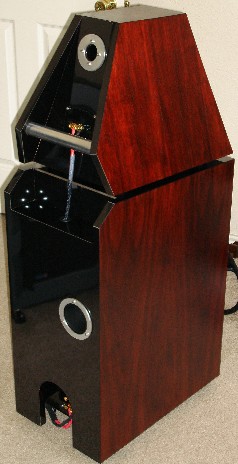

I used glossy formica for the wing edges and front and back of both WATT and Puppy clones. I chose this since I didn't have a facility to the perfect paint work done.
I hope the photos below help. I also included a photo of the real Watt/Puppy (taken while I was auditioning them).
