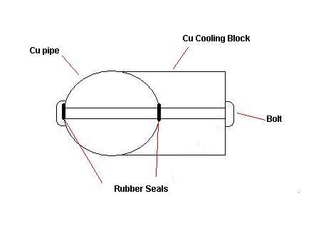

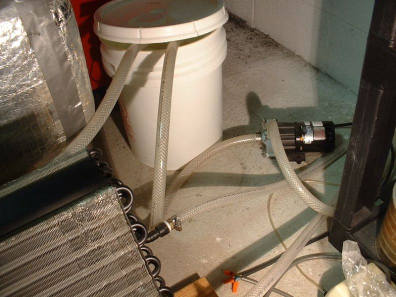

As promised recently, I'm posting pictures of the water cooling rig I've described in this thread. I'd like to thank my wife for her assistance.
The first one is of the pipe and mounting flange for the output devices. Some people seem to have had trouble visualizing what I was describing when I said that I soldered the flange to the pipe: -O. Perhaps this will help.

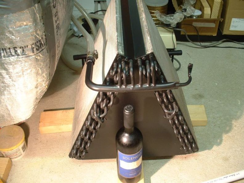

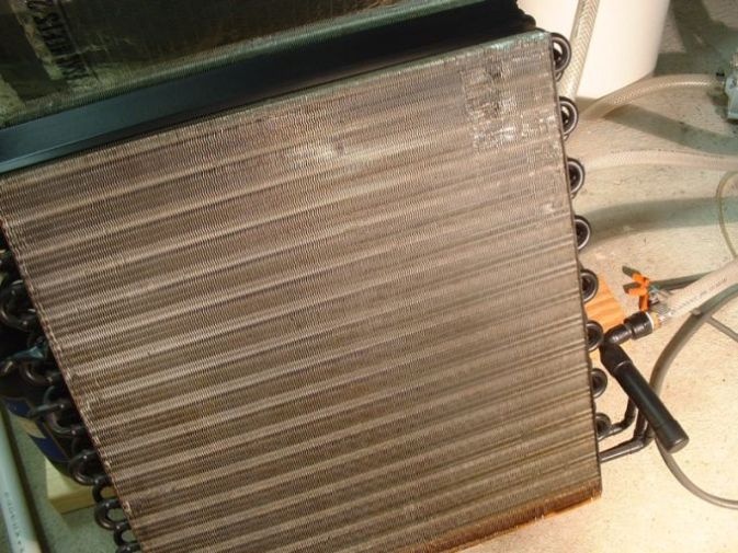

This is an end shot of the heat exchanger I salvaged from a heat pump. There are two independent exchangers, tilted together at the top. The area between them is hollow. The protruding 2x4" scraps hold the heat exchanger up off the floor so as to allow air flow. There is no fan; the air flow is via convection only.

I spent some time fretting over the amount of surface area between the mounting flange and the pipe, then got over it. Six devices running ca. 30W ea. totals around 180W. That's a lot of heat to extract from one little copper bar, and yet I can put my finger directly on the TO-220 cases and leave it there indefinitely. Given how little the system cost, it's a no-brainer. It'd take an armored car full of money to buy the equivalent passive extruded heat sinks.
I've since acquired two more heat exchangers that I will (eventually) turn into more heat sinks. More particularly, I'm interested in trying a passive/convection system so as to get rid of the water pump. The noise isn't a bother since the pump is in another room...it's the elegance of the idea that attracts me. The Mark II version would also include quick disconnects for the water lines, just to make life easier.
The system I've posted here seems to be damn near bottomless in its ability to wick away heat. I have yet to find a limit, no matter how hard I hit it (several thousand watts-worth of heat and it just smirks and says, "Is that the best you can do?"). And that's with passive air circulation. Should I ever actually get near the limit I can start in on forced air cooling for the heat exchanger.
Some of my ideas haven't worked as well as I'd hoped. This one has far exceeded my expectations. Highly recommended.

How critical is the solder sweating the pipe to the copper mounting block? Would there be any point in brazing it on, using plumbers brazing rod?

As long as the connection is water-tight, you can use anything. Around these parts, solder is the method of choice for connecting copper plumbing. Copper pipe is widely available. The copper bar is 1/4" by 1" if I recall and wasn't all that difficult to find, even here in the hinterlands.

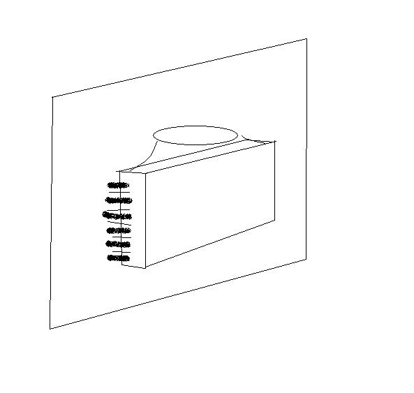

I've seen a guy water cool his CPU by just taking an old gas cylinder and modifying the valve. He burried the cylinder in a big hole out in his garden, then used a pump to get the water flowing through some tubing back into his house and to the computer.
This is my idea of heaven in terms of noise. I can't stand the drone of computer fans or anything like that given the number of hours I can sit at one for. You can even get the pump out in the tank so it makes no noise at all.

An indirectly heated tank has a sealed copper coil inside it that you can run the amps hot water through to prewarm the water for a shower.
