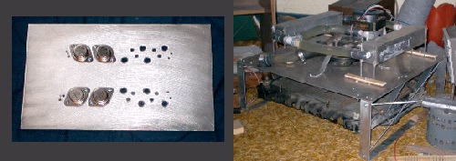

Phage, It's a little late to rough up the inside of my blocks, but a spring in there should create turbulence well. Thanks. And the reason I'm using liquid cooling is to avoid buying big heatsinks. The only cost of my liquid cooling system so far has been the tubing, connectors, and the belt and pulley for the motor.
I got the pump running, but I had to pull start it because the motor doesn't have enough starting torque. I'll have to get a motor with MUCH higher starting torque.
I don't have a heat source (like a heatsink-mount power resistor) to test the block-air thermal resistance right now.
The motor by itself is quiet, but the sound of rushing air and vibration measures over 80dB@1m. Obviously, that won't do for hifi except at really high volume levels, which is fortunately just what this amp will do. Maybe I can get a 2 speed motor so it will be quieter at medium volume levels.
Also, I can't seem to get all the air out of the system, which isn't good, but at least it's turbulent in there, the clear tubes turn white with bubbles all around when it's running.
I've definately have some kinks to work out, but it should work quite well when it's done.
P.S. What % antifreeze should be in there to prevent corrosion?
I finally got around to testing my cooler. Not very accurately, because I don't have any big power resistors with known thermal resistance right now, but here's what I did:
I got a heating element, about 1kW, and bent to fit on top of one of my blocks. I then put the element in a mold and filled the mold with lead, leaving me with a lead block with a heating element embedded in it that fits on one of the blocks. I then greased it up with heatsink grease and clamped it tightly to the block. After well over an hour of running, the top of the lead block did not rise above about 90 degrees C. The cooling block, tubes, and radiator only went up a few degrees. My conclusion is that since lead is far less than perfect as a heat conductor, much heat stayed in the lead block, rather than being conducted to the aluminum, and therefore screwing up the accuracy of the test a lot. The temperature of the rest of the system stayed quite low, so I assume that the rest of the heat, probably well over 500W was dissapated very well by the radiator. It appears to be a remarkable cooling system, and made mostly from scrap.
kilowatt - everyone reccomends a different mixture ratio. 2 oz of watter wetter, keep cool, or jet dry to the gallon and about 6 oz all weather antifreeze to the gallon. If you don't want to buy a wetting agent like water wetter, keep cool, or jet dry then just add dish detergent [not too much!] it will accomplish the same goal. As long as there is no water trapped inside the block you should be ok. The water wetter should also help these bubbles go away.
Dissipating 500W is a nice feat kilowatt. You could have drilled a hole in the lead to put the heat sensor closer. What kind/size radiator are you using?
PS to those using evaporative cooling systems never put the above chemicals in them. The water wetter will make soap suds come out of the cooler for a very long time and you really don't want to breathe antifreeze
I guess I didn't mention it, but I did drill a hole about 1/4" into the lead to take the measurement.
The radiator is from a little Toyota with a 4 cylinder engine. I don't know the model. The radiator is about 20" square and maybe 1 1/2" thick. I got the pump and fan from the same car. I had the pump running at about 3450rpm for my testing. The temperature of the aluminum blocks only rose a tiny amount, so I would think this system is quite capable of cooling things with much more heat dissapation. The amp That this thing will be for is a 7200W class AB amp, I figure maybe 4000W heat dissapation under a worst case scenerio. The system might be able to handle that already, but if not, I can further improve the heat dissapation by adding a turbulator in the blocks, bypassing the viscous clutch on the fan to get more airflow (louder though), and getting all the bubbles out of the system.

And I'm running the coolant through aluminum blocks, as you can see in the picture of the complete cooling system for my big amp. MOSFETs in TO-247 cases will be mounted on all sides of the blocks. There will be 160 such MOSFETs mounted on the completed blocks. For the Leach amps, which use TO-3's, I have the transistors mounted as in the picture, (I only have enough for one channel mounted now) and I will mount 1 1/4" square aluminum tubes between the transistors.
