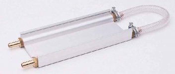

I am going to use a water cooling system for my 7200W amp. I have already constructed the lower part of the chassis, with the radiator and fan under it. It uses a radiator, water pump and fan from a car, and a nice, quiet dishwasher motor for the pump. The fan is above the radiator and sucks air up through it. I haven't been able to test it yet because I haven't figured how to get the motor started under even the fairly slight load of the pump, but It should have plenty of cooling capability. The plan is that there will be MOSFETs mounted on all 4 sides of each of the aluminum blocks, which are of course hollow, with 1/4" walls. There will be a board on the top and bottom of each end, for the 8 channels. The power supply will be in a large compartment on the back that I have not yet built, and the main chassis will be 7 1/2" high, for a total height of 15 1/2". The speaker terminals will be on each side, to keep the speaker wiring away from the rest of the circuitry.
So far, it looks somewhat (no, exactly) like this:
UrSv - DI water in a water cooler is a bad idea unless you are about to add antifreeze to it. DI water would actually promote galvanic corrosion as it becomes unpure over time. The antifreeze you put in the system is only there to prevent corrosion. Antifreeze actually causes water's heat transferring ability to be less so you should not use much.
Also I've noticed the water block designs on this board to be poor. Most of the designs promote lamnar flow of the water. Basically it is where the outer column of water becomes an insulator due to the high flow rate of the water. The inner part of the water column therefore stays cool while the outside gets very hot. In your block deisngs you should include something to cause turbulence. Check out the best water block desings for computer cooling and you'll see they all promote turbulence. Of course this causes more head on the pump which is also not desired, it's a tradeoff.
What I have now for my blocks is just a plastic elbow epoxied into a hole in the end if the blocks. I suppose I should put something in the system to add turbulence. It shouldn't take much, as the water will be moving very fast through my system.
Does anyone think I might have problems with coolant flowing unequally between the two blocks?
