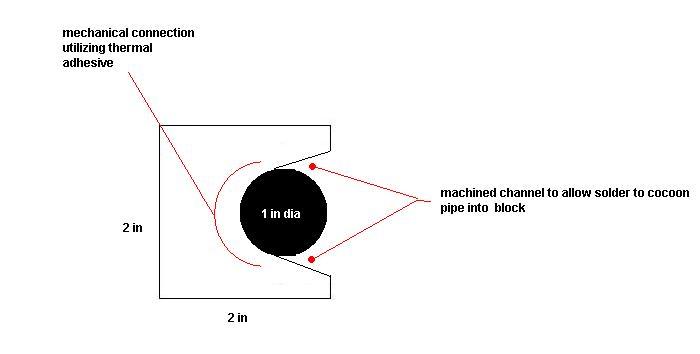

I think this will solve the issue for a nice solid metal to metal connection. Per the pic, a channel is machined to encapsulate the pipe into the block creating a solid metal to metal connection. Yes it will take a lot of solder with the length of the piece at 12", but I think this will be optimal.
With this setup, the cooling block will be housed in a chassis, with all water connections external, the cooling system will be remote. The only thing that will get damaged if there is a water fault are the downstairs ceiling; again another impossibility, because this system will only be used when yours truly is present. As long as the connections are sound, there really is no issue. It is an open cooling system, so no dangerous pressures to deal with. Also the car radiator i'm using with fans is coming out of a 190HP jeep, thats roughly 142kW. This system at most will be asked to dissipate 1200-1500watts of heat, so theres no dangerous temps involved. Of course if the pump fails, the output fets will die a most horrific death. Adding a manual resetting thermal cut-off onto the cooling block solves that. I can see the benefits of using distilled water in this system, but non-conductive coolant is really only beneficial if failure results in components getting sprayed i.e. over-clocking. Unless this type of coolant is used to prevent EMF build-up due to flowing water(?) through an assembly; which I don't think is possible as long as everything is properly grounded. For the DIYer on a budget wanting to experiment, this is the most elegant solution. IMO

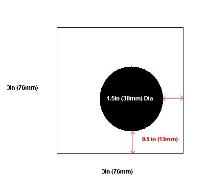

Hi Mega,
Another, simpler way, would be to simply take a block of copper or Al of thickness 10mm and drill a 6.3mm (1/4") hole right through, end to end. Tap each end, screw in a brass fitting for attaching plastic tube. Then tap each side of the block for the semiconductor clamp.
That's a little bit simpler than soldering, and has the advantage that it's all low temp tapping and boring.

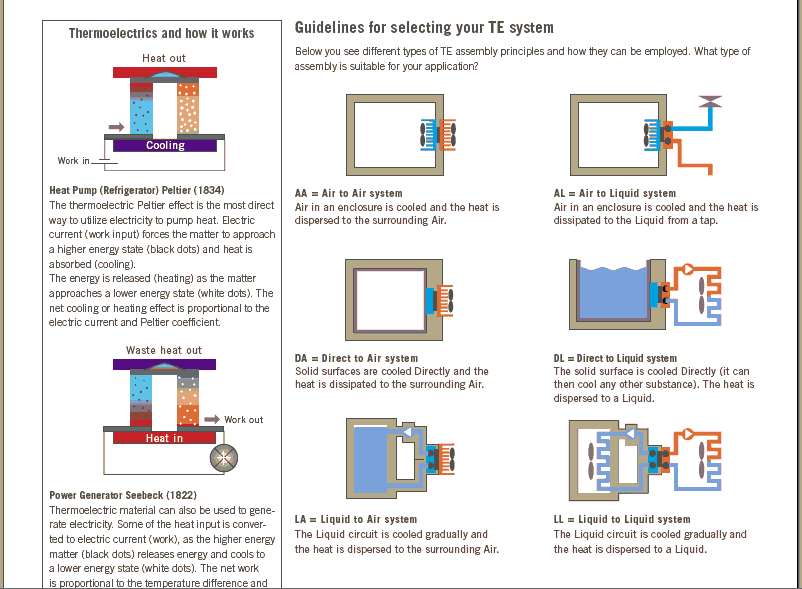

lineup said:there are many possibilities
using Air, Water and Peltier in various ways
It's easy to draw solutions. Practical implementation is another matter and you still haven't really gained anything in the end.
Of course Grey said that the soldered on 1/8" piece of copper worked perfectly, so using an expensive block of copper would be a lot more money, and drilling a hole through the middle of the block seems a lot more work than soldering a plate onto a copper pipe.etely sealed as the plate is soldered to the outside of the pipe. The barbs in the end of the block could leak, and the hole would need to be threaded to screw them in..
I have some huge aluminum heatsinks that use an 1/8" tab to mount the devices even though the base of the fins is about 3/8"
and they work very well...
The plate on a copper pipe scheme is completely sealed as the plate is soldered to the outside of the pipe. . Soldered seems less likely to fail
I think that this is the most clever part of Grey's design. I too was hung up on how to machine something but he came up with a better idea IMHO.
and MEGA-amp responded:
Why didn't I think of that, its so simple!?!?
I agree that this is conceptually more elegant; but in my (admittedly limited) experience, aluminum tends to grab cutting tools. I'd think you'd be lucky to get through 12" of the stuff with a 1/4" drill bit. Any experienced machinists want to chime in here?
[edit] MEGA-amp, I should have looked at your drawing before responding - it might be easier to drill the larger borehole you've drawn, since a drill bit or mill that size will be considerably stronger. And if you have access to tooling that will accomodate such things you probably also have a lot more machining experience than I do. [/edit]
If you do try it, you might consider drilling in from each end, so you only have to go through 6" (probably easier to find a drill bit that long as well). Do let us know the result if you give it a try.
