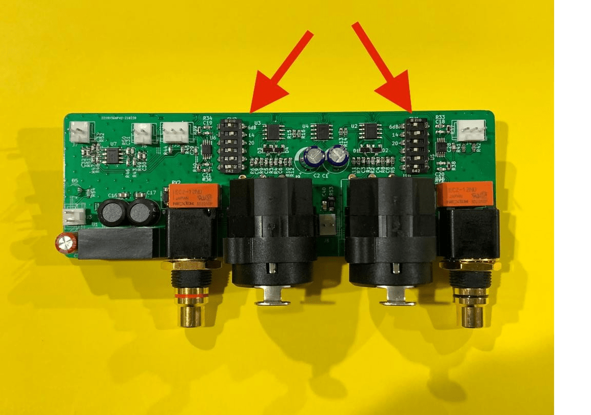

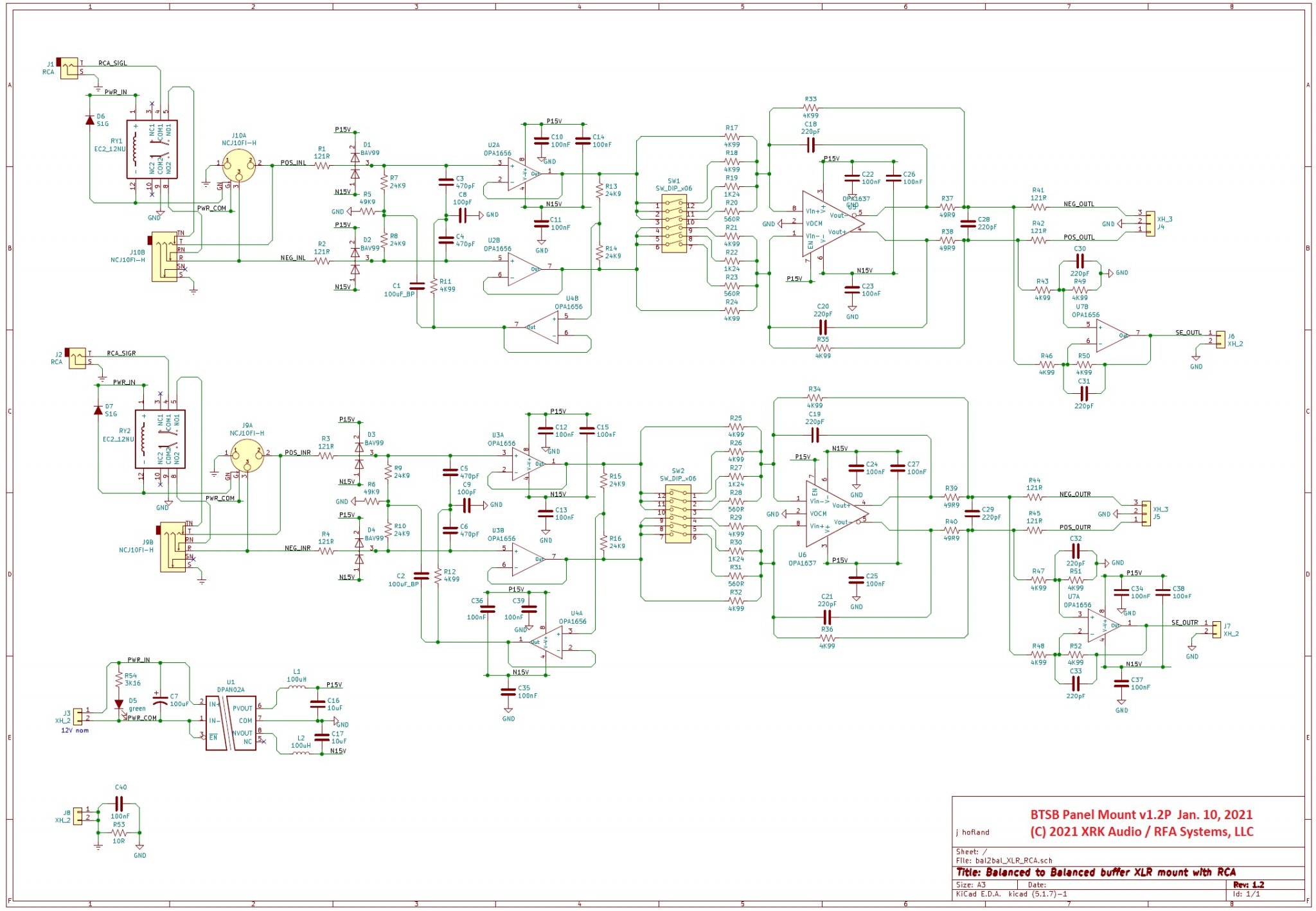

Default setting is 6dB on buffer. Amp intrinsic gain is 22dB for total 28dB.
DIP switches are 0dB/6dB/14dB/20dB.
I would say using 0dB for 22dB overall is good if you have a powerful preamp. But I would not go 14+22 for 36dB unless you want to use something like a smartphone to drive it to clipping. Don’t use the 20dB. That’s too much for this amp.
I have more details on which to DIP switch to flip if you can’t make sense of the schematic.

Please do!I have more details on which to DIP switch to flip if you can’t make sense of the schematic.

I see the schematic is in this review, cannot be simpler.A new review just came out today.

Sorry I didn’t answer your question earlier.View attachment 1090976
I guessed all dipswitches off is 0db.
Yes,
All off = 0dB
1,4 on = 6dB
2,5 on = 14dB
3,6 on = 20dB
