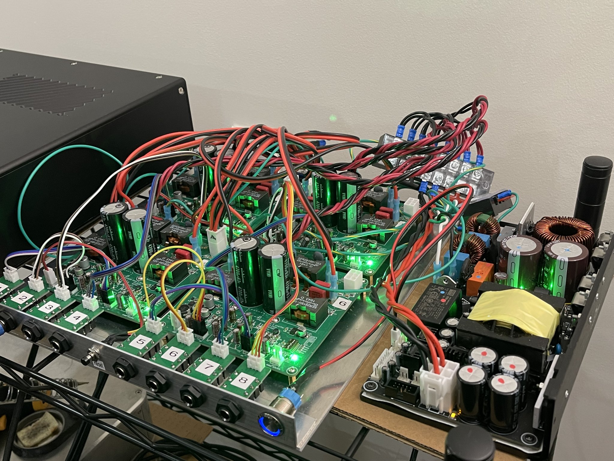

Hi Decommo,
Thank you for the kind words. By multichannel, do you mean more than 2? I have built an 8-channel amp for a professional audio amplication using four of my TPA3255 modules and a 1200w SMPS by MicroAudio with PFC.

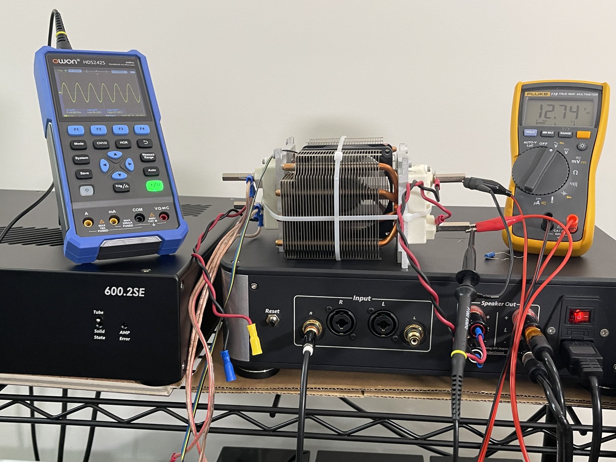

I just measured the output impedance (damping factor) of the Warp-1 today.
Damping factor was measured flat from 1kHz down to 20Hz and is very good at 0.0052ohms (5.2 milli ohms) This was using a precision non inductive air cooled 10ohm load. Only when I took it to 10Hz that it went to 0.021ohms. Excitation voltage was 38Vpp. Measurement made using Owon digital Oscope and Fluke 116 DMM. I measured at 1kHz, 100Hz, 50Hz, 30Hz, 20Hz, 10Hz.
This says that damping factor (DF) is 192 and is flat and extends over the important mid bass and bass and down into low 20Hz bass region of audibility. This explains why the bass is so good on this amp. It doesn’t falter even when pushing the low end.
It may even be better as this was at the limit of the Oscope’s resolution to see difference between 38.4v and 38.0v.
