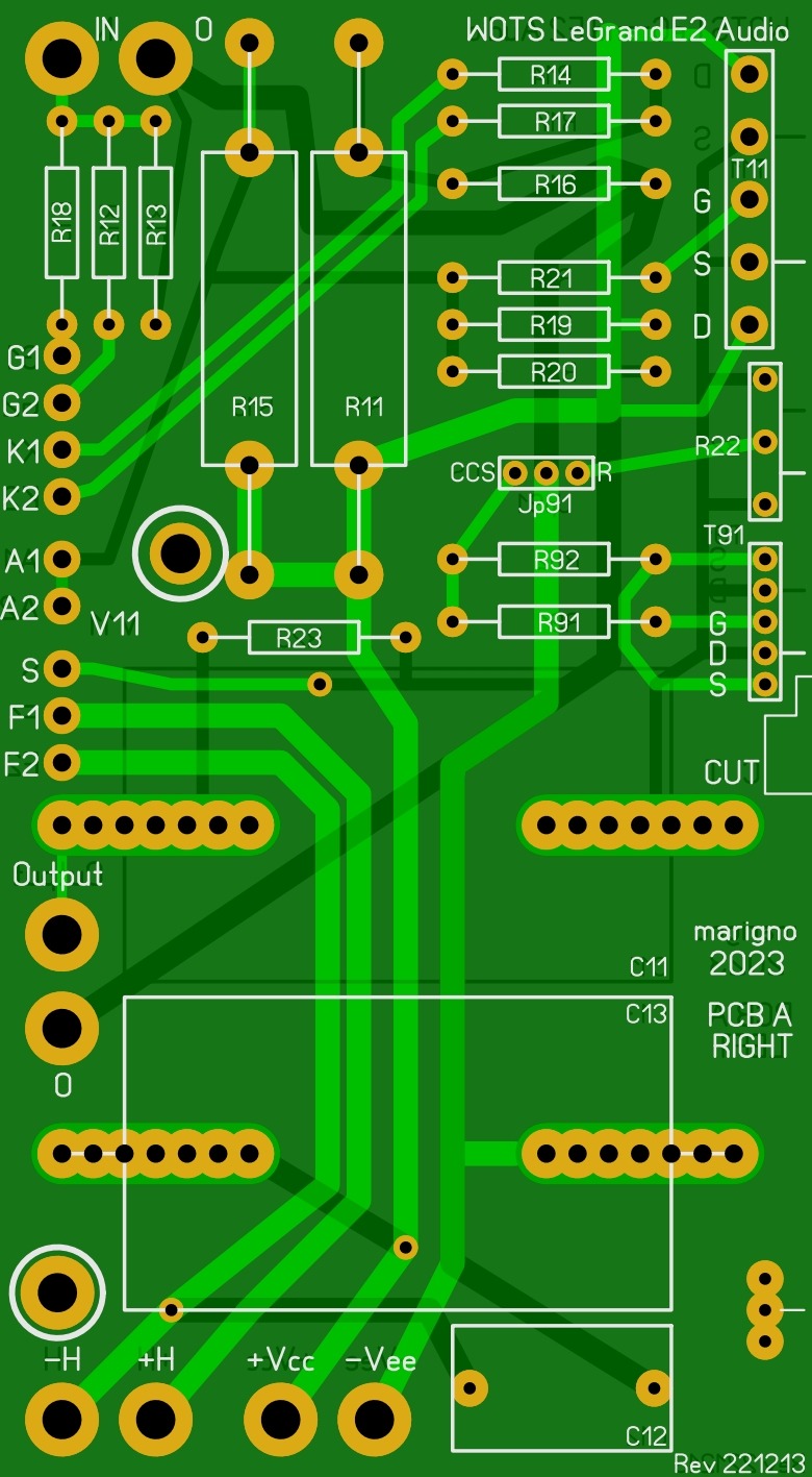

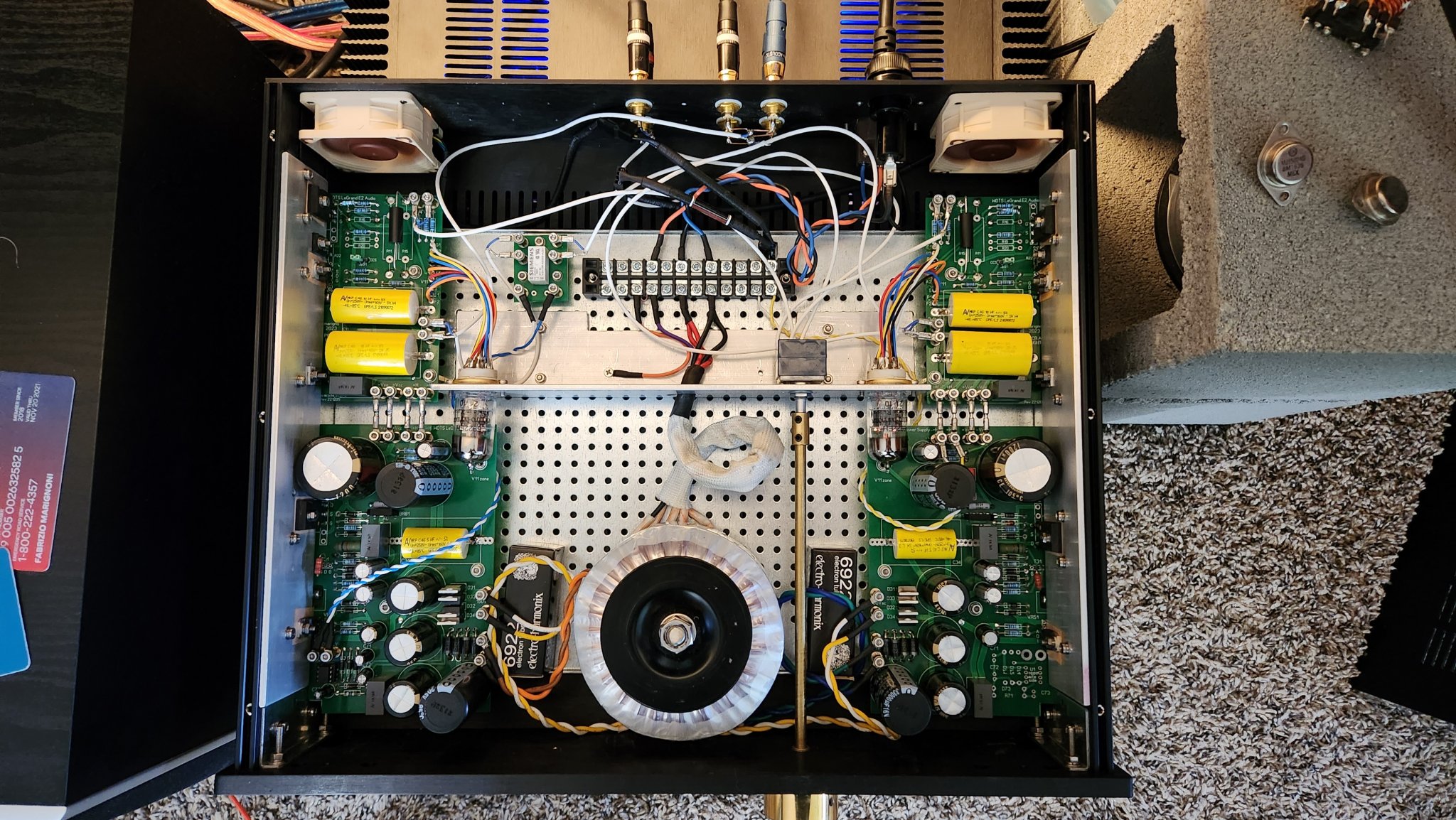

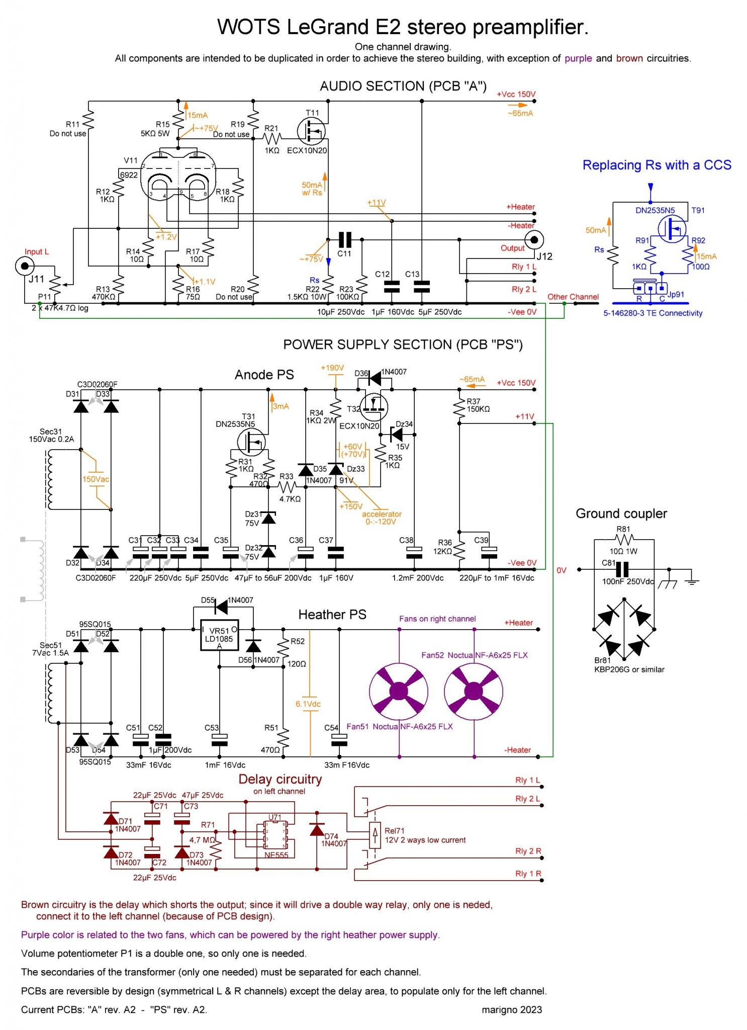

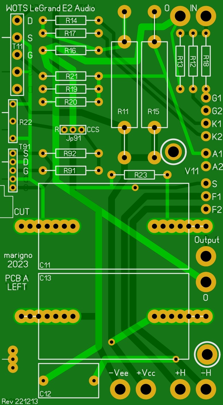

Description of "WOTS LeGrand E2 project" - A pre-amp. Not the usual boring follower post-amp.
The "WOTS LeGrand" was born in 2004, as the successor of the "Aki'llower", in turn, the successor of the "AkiLine1" project proposed by the well-known Italian shop AudioKit.
The "AkiLine1", in my opinion, lacked some edge and punch. I'm sure this was my fault, as I had biased the triode to draw 15mA or more, which was too much for the design. I thwarted the presence of the anodic inductor, bridling its operation. I did this according to my belief that the more current flowing through a gain loop, the better its musicality. I respected the maximum current allowed by the inductor with a large margin, which, however, was higher than what was established by the project.
I then tried to add a resistor in series to the anode load to have half the supply voltage on the anode, and I applied a source follower, needless to say, a high current (45mA) one. This was the decisive step: the music now flowed pleasant and detailed proposing a credible and enjoyable scene. Which I hadn't been able to achieve with the very expensive "Aikido", which also seemed like a noteworthy project. At the end of the article, there is a note on the very simple modification to make "Aikido" perform well.
Then I removed the inductor, polarized the triode better (still negative rail is present), and the "Aki'llower" was born, the progenitor of the "WOTS LeGrand". It has remained unchanged since 2003 and still plays in my laboratory.
So I started working on the new "WOTS LeGrand" project in 2004. I removed the grid negative by recalculating the triode polarization for the maximum possible gain without using a cathode capacitor, I took great care of the power supply, I designed a PCB and made it at home (never again), and then I put it together. The preamp has been playing in one of my HiFi systems ever since, to my great satisfaction.
In 2008 my dear friend Gianfranco, who as a musician had very good ears, told me that he particularly appreciated the sound of my "LeGrand", but that he wanted to avoid tubes altogether. I designed for him the "WOTS Tre", a jFET cascode followed by a source follower. We spent an entire afternoon fine-tuning its sound with different polarizations, and when we were done, we got the same sound as the "LeGrand".
Other enthusiasts have built the two "WOTS", and have compared them with other preamplifiers; listening tests have also been carried out in various audiophile clubs, and the two "WOTS" have always been appreciated, and preferred to other high-cost "noble" devices. I myself went to see a designer of Hi-End amplifiers in his shop because I was interested in an OTL tube power amp. At the end of the listening tests, I asked if I could use my "LeGrand", which I brought. Perhaps it was due to the "rule of the beetle" (I'm not going to explain it, google "regola dello scarrafone"), but I was sure that the already excellent sound was even better than before; a fact confirmed by my friend Flavio, who accompanied me, and who noticed the grimace of "admired disappointment" on the part of the designer because he too understood that the LeGrand was better than his.
My friend Stefano, with whom we have been dealing for a long time since the beginning of the adventure, has tried and tried again different configurations of the "WOTS LeGrand", even a low voltage one; he had a lot of fun with it, finally landing on the use of the 6922 with paralleled triodes, without a pull-up resistor.
The "WOTS LeGrand", in its original version with the 6H30, listened to during various sessions, in Stefano's listening room in Rottofreno (PC - Italy), gave us goosebumps due to the warm mellowness and the ethereal transparency of its sound. Someone judged it a piano preamp for the precision of reproduction of this noble instrument; others marveled that for the first time they experienced almost the same feeling as during a live event. I myself stood there with a shiver running down my spine. We had 4 preamps to test in a chain that was not terribly expensive, but pretentious just enough. The WOTS LeGrand was, once again, the undisputed winner for expressed musicality, indeed very characteristic but completely devoid of color.
The simplicity of the scheme makes it clear that the only thing to calculate is the polarization of the tube, trying to keep the distortion low and monotonically decreasing, as befits an excellent single-ended. Since there is no loop feedback, and since there are few components, these must be high quality.

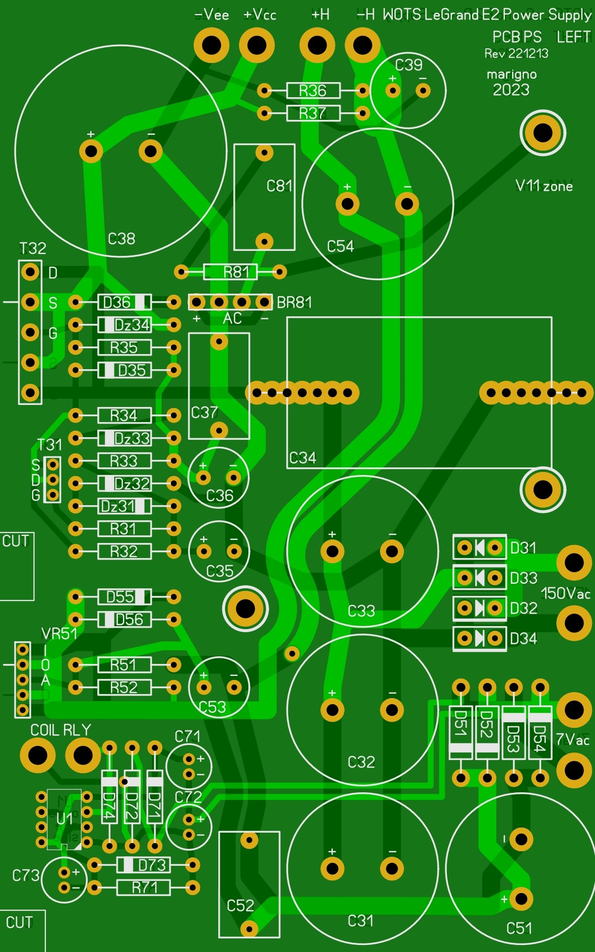

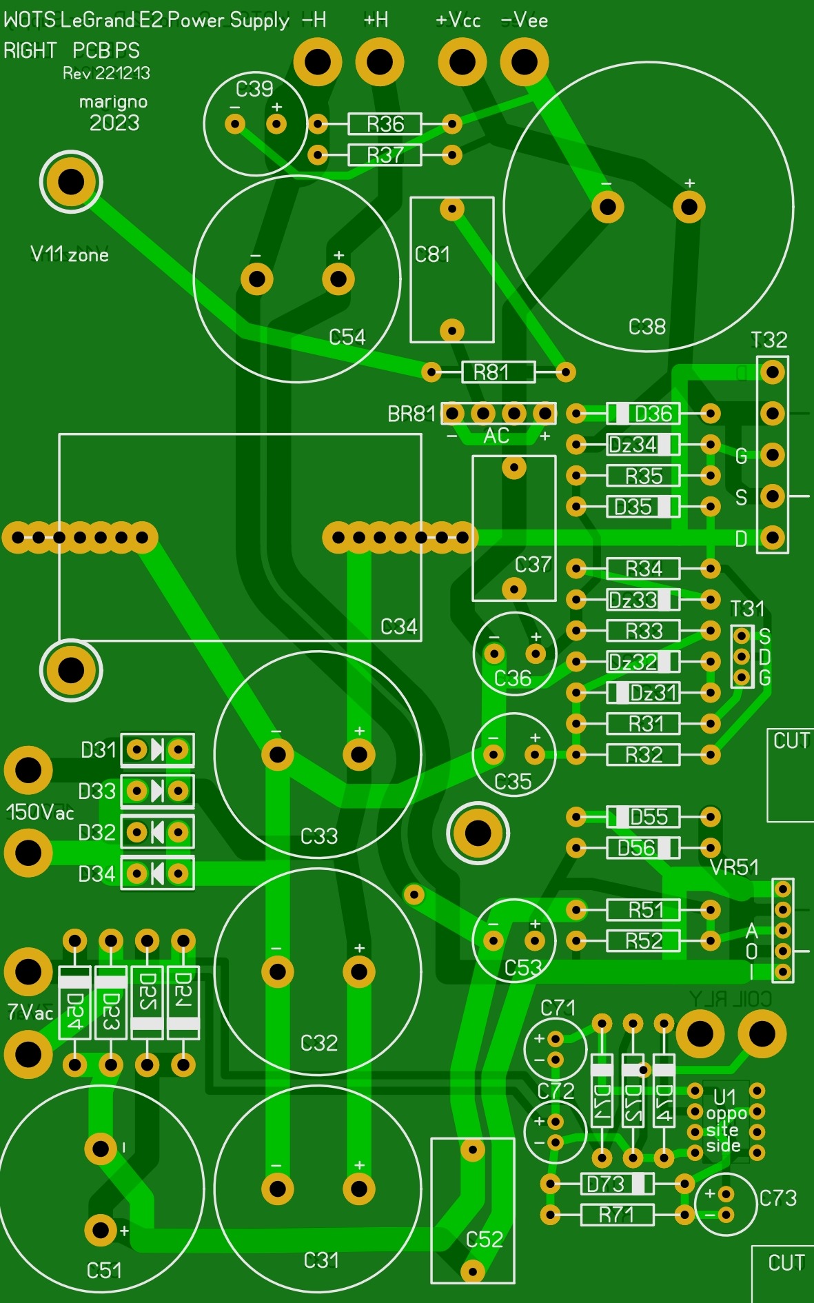

Some time ago I had the idea of assembling a second "WOTS LeGrand", revisiting the project to improve and update it. I added the suffix "E2" to his name, meaning "here's another one, the second one", which, in Rome, is precisely said "eddue".
Reading Boske (Tube CAD Journal) I convinced myself that the filament power supply should not be shared between the two channels, each channel must have its own filament power supply. It follows that I cannot use a single double triode valve for a stereophonic realization. So I decided to opt for a dual mono implementation, which presents the ground as the only common element between the two channels. The circuit is now a little more complex than the original, because:
Actually, I was tempted to use the PS21 proposed by Tube CAD Journal, but since it uses feedback to ensure rock-solid voltage stabilization, and since I am averse to any form of loop feedback, I revisited the old and "wise" Virtual Battery.
The original "LeGrand" uses a 6H30, which gain is just sufficient for a line preamp, provided the cathode resistor is low enough. With a low resistor on the cathode, in order to polarize correctly the triode, a pull-up resistor is needed. In the PCB design, I kept the pull-up resistor; if a 6922 is used, this is not needed, since the 6922 has a higher gain.
The components are up to date with what the market currently offers and what I have managed to fit into the PCBs. Basically, nothing has changed compared to the original 2004 project, only some new refinements allowed by the new components I came to know, and the dual-mono circuitry.
I really don't like to design PCBs, it is a kind of job very boring for me (just like the followers are for some diyaudio forumers), and I do it without the needed attention and concentration. But this time I had to. What I enjoyed, this turn was finding a solution to obtain a symmetrical design with only one board, so I had to pay for the making of only 1 PCB, good for both channels. So I designed two PCBs, one for the audio section, and the other for the power supply section, double-sided with through holes, with the reversibility criterion I had in mind.
Building the "WOTS LeGrand E2" does not present particular difficulties or critical issues, it is a project for all enthusiasts who:
The mechanical part and PCBs are designed to fit the 2U (minimum) high, 350mm deep HiFi2000 Slim Line cabinet with a mounting base and fully vented covers. The PCBs are not well suited to other cabinets.
The following mechanical details must be made:
Fasteners to buy:
After listening to different solutions with 6H30 and 6922, my final choice is the 6922 polarized at 7.5mA for each triode, with no pull-up resistor. In this way it seems to me to be back in 2004, testing the "LeGrand" at Stefano's. The same sound, perhaps now a little better with the 6922, which was also Stefano's choice in his last "LeGrand". The quiescent point is 1.2V on cathode, 75V approx on the anode, 0.56W each triode. The schematic shows this configuration.
The PCB offers two possibilities in order to apply the load to the source follower: a CCS or a resistor. I definitely prefer the resistor, which gives more body, detail, and focus to the sound. Perhaps a purist would choose the CCS, which gives a sound very close to Aikido's (once improved).
While writing this note I have some cross-over music flowing in the room at a very high volume, but it doesn't bother me, meaning that the "LeGrand" doesn't generate any listening fatigue.
Be aware that some fake DN2540N5/DN2535N5 are around the market. My first attempt to build the 'LeGrand E2" failed because of them, I understood that when I received the DN2535N5 bought from an official retailer. The reason you see a resistor in place of the DN2535N5 in the power supply board is that I ran out of them, and have to order some more good ones.
Should you decide to try this adventure, I can send you the Gerber files of the PCBs, just send me a note in PM.
